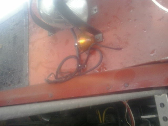

Well, took her (sno-vit) out for a second shakedown run with the wife along for the ride. About 5 miles in the oil temp, cylinder head temp and the alt light indicated an issue. Unfortunately we were on a rather steep grade at the time and I had to go forward. after a safe parking and cool down, we were able to turn around, and once started downhill coast (no engine) most of 3 miles. Then the run 3 minutes, cool 30 started. Belt had 10-12 hours on it. tensioned per the book.
On the good side, dealt with some pretty bad ruts, and the tracks stayed right where they were supposed to be.
Sequence of events: "that doesn't smell right"
+15 seconds Alt light
+30 sec cyl head temp visible moving
+45 sec Oil temp starts moving
took about three minutes to get to a stop spot. Cyl head 375-395.
while waiting for cool down: Hear gas boiling in carb.
I was on a slope that has my 4-runner spinning tires in good weather if I'm not careful. Was performing great until then. Sloppy snow like that at meow #2. Tracks self cleared pretty well.
be sure the airhorn isn't sucking in hot air from the engine bay. a good seal is needed to the hood. car weather stripping works good from the cowling
my new muffler smoked till the paint was burned off.
you had no belt?
you had no belt?
Had one starting, had one up to the 5 mile point. after that no, it was in pieces.
Up to then it was keeping it's cool real well. Even in the heavy slop and the slope.
