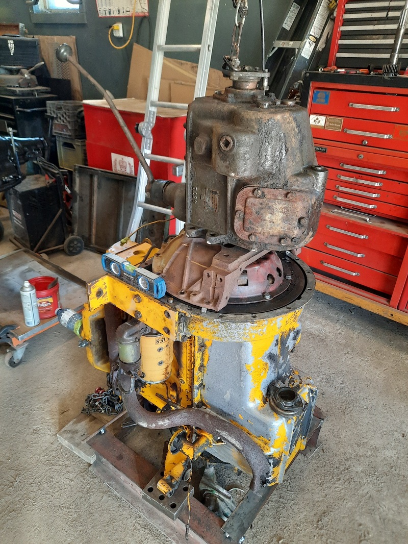

Centered the M37 pressure plate on the Dorset flywheel today and started drilling /tapping holes . After that fab up a pilot bushing/ bearing , depends what's on the shelf that can be matched up.
J5 Bombardier
You are going to have to fabricate an adapter plate to bolt the bell housing from the M37 transmission to the new engine most likely. How will that effect the input shaft/ flywheel, crankshaft flange and pilot relationship?

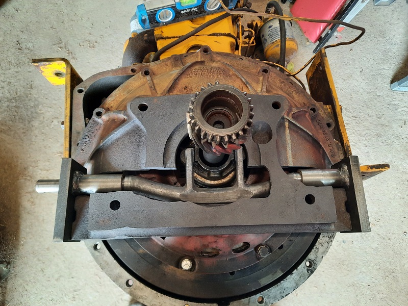

Bit more material to remove on the bell ,then finish the cross shaft mounts and open up the center of the housing to clear the release bearing .. If that works out , cut a 1/2" plate to sandwich between the bell and trans.
J5 Bombardier
looks like the challenge is to get the shaft back far enough to work, but still have a flat surface on the outside to bolt the transmission up.
J5 Bombardier
Bored out a 4 5/8" hole in a 1/2" plate for the trans input shaft support . Need to recess the temporary pilot bushing a 1/4" to bottom the trans against the plate , then drill and install dowel pins / studs , to the deuce bell .

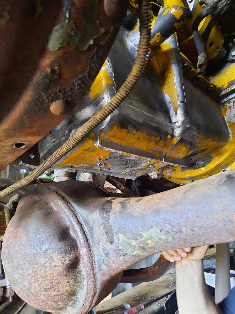

I dropped the pan / oil pump to do the engine install. It's a cast aluminum pan with the option of a wet bell housing for industrial use , the sump is in the front so it will have to cut and welded to clear the front diff.

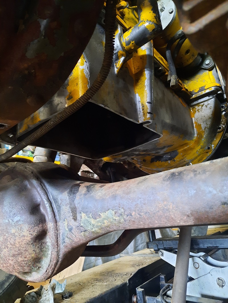

Oil pan cut today ,hopefully finish an angle cut on the right side to clear the pumpkin and get it welded up tomorrow . These Dorset Fords have a crazy deep pan , probably why they last so long.
Going to pump up the springs for added clearance and add some axle stops (just in case ) after sandblasting.

Pan welded up on both sides and installed temporarily. The sump can be sorted out on the engine stand later , I want to finish the firewall mod and get ready to sand blast as July is here. Have to redo my blast pot and start screening our own sand , a skid of the stuff has tripled in price over the last 3 -4 years.
