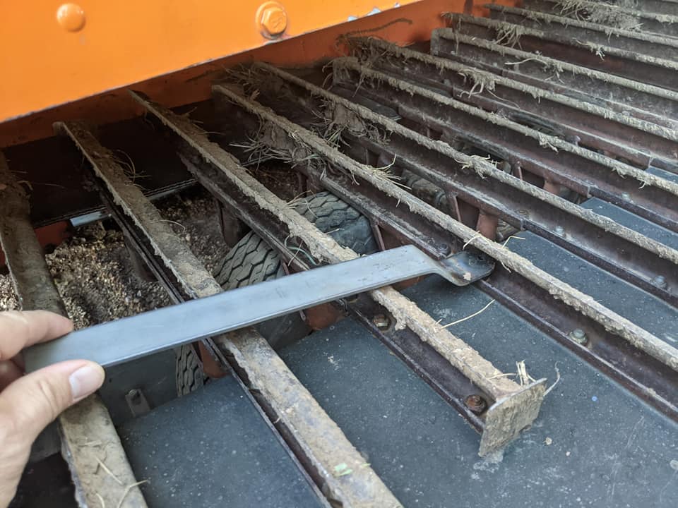

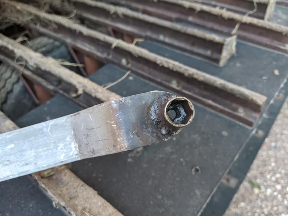

what you got looks great. but here are better pics of the easier to make tool.
