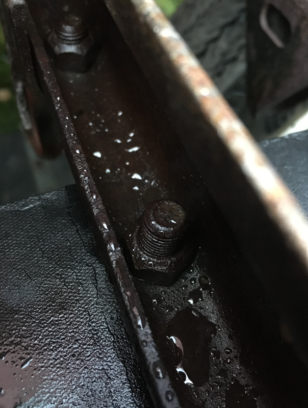

Ok guys, I’m struggling to figure out what tool is used to get the 9/16” nuts off the grouser bolts. It’s soooo tight in the slot and no tool fits in there. Someone here has done it I’m sure. Thanks!!

Thank you. That is definitely helpful and seems like making a custom tool is the way to go. What I am finding is that about 1/3 of my grousers/tire guides have loose bolts and thus lots of play to damage the belts - BUT the bolts & nuts are all frozen/rusted in a loose position!! I’ve tried penetrating oil to free the nuts but it does nothing. Today I used an angle grinder to take off 3 bolt heads as an experiment, but I’m finding that it does too much damage to the backer plates. I did replace those bolts with fresh ones, but that process is just not viable for the whole project. I’m in a bit of a quandary since I have loose grousers and no straightforward way to address the issue.
Warm them up a bit with a heat gun and while hot squirt with PB Blaster. Worked for me.
That’s a great idea. I tried Liquid Wrench and then heated with mapp gas torch, but that didn’t do it. I will try your method and see what happens.

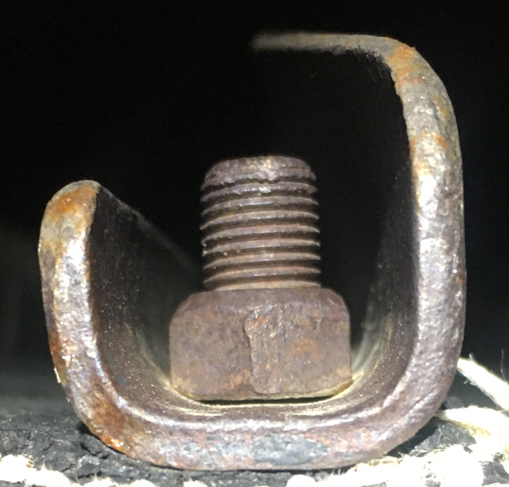

Thanks guys. I've tried everything including grinding down box wrenches and sockets as thin as possible, and nothing fits in the slot. I have no idea how they got the nuts tight to begin with, unless just by the friction of the grouser itself. They are only supposed to be torqued to 15-20 ft/lbs, which maybe could be done just by friction without a tool on the nut. I've tried multiple rounds of PB Blaster/heat/impact wrench/banging, and even sweet-talking them. But they won't budge, they are frozen in time. Another idea I had is to spot weld the nuts in place, then try to unscrew the bolt, then bang the nuts free. I'm wide open to any other ideas!

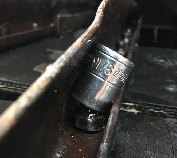

This is what it looks like in the slot. Nuts are frozen to the bolts, but many are not tight. So some of the grousers are loose and damaging the belting. In the second pic you can see the free space under the nut.

failing that, what does the cross section of the channel and bolt measure? I have another idea gelling.
While against your better judgement, I certainly do appreciate. I have tried 10” vise grips, and while the grips are sufficiently tight and braced, the nut skips in the jaws. But I have not tried the true blue Irwin grips.
The cross section is tricky, as there are the radius’ from the base of the grouser to the two vertical blades, which of course is where the 9/16 nut sits. But I will get those measurements. Thank you!
I would grind off two sides of the socket enough to clear the grouser and get it over the nut. Then weld a handle to the top or side of the socket and turn it from the bolt side. I always keep a box of old wrenches and sockets that I get at goodwill or garage sales to make "special" tools. I have a whole drawer of "pretzel wrenches" and U shaped sockets for some of the impossible to reach fasteners in airplanes. Some of them only get used once.
Agreed, it will need a custom tool. It's a tight little bugger! What is odd is the nuts don't even sit flush due to the radius' of the grouser bends.

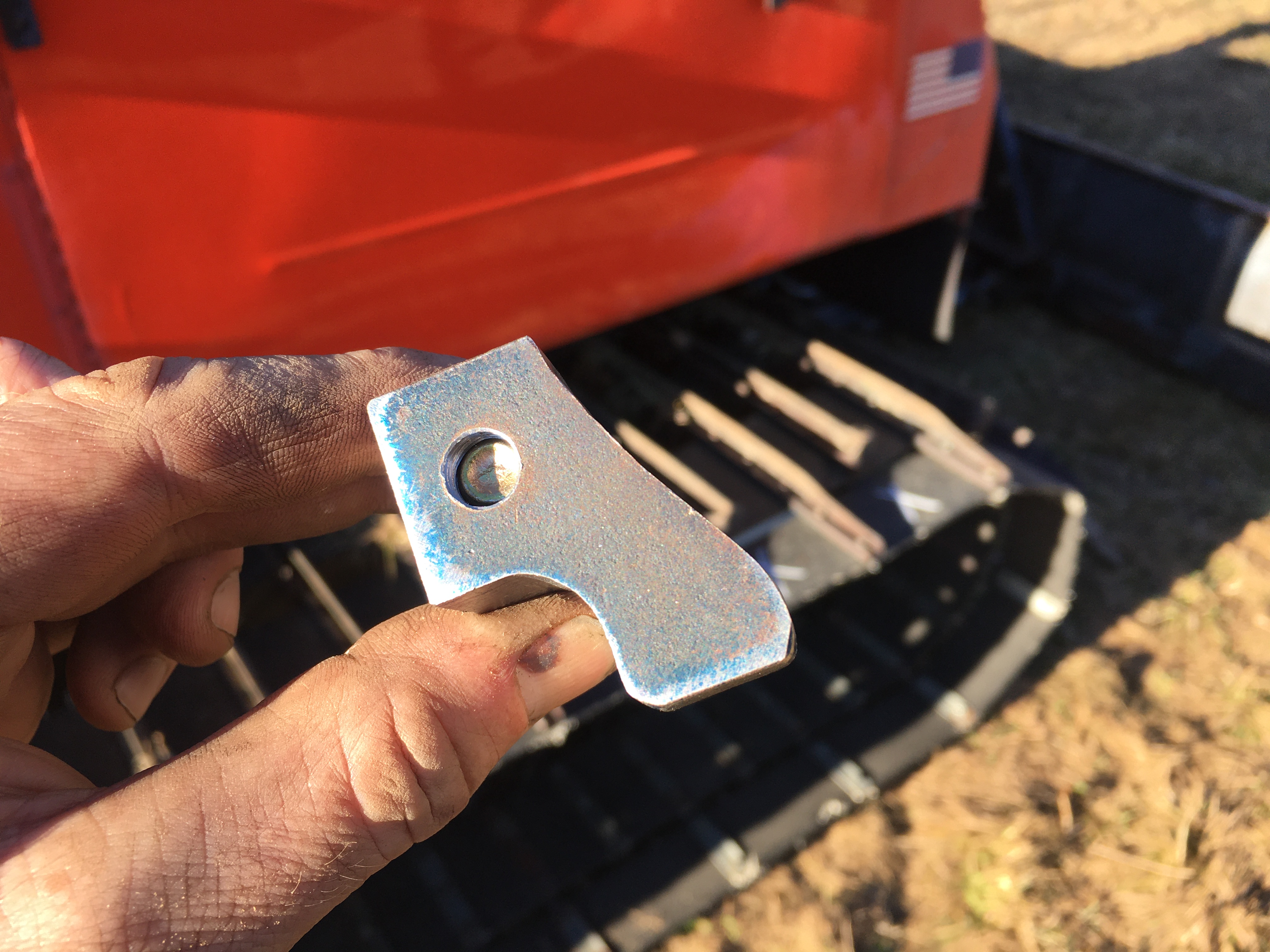

Interesting rusted nut process, mostly the quick water cool, plus a Tucker looking tug in the background. The prevailing torque nuts used on the grousers were probably never intended to be removed 30-40 years later.
Very cool method. I wish there was a way to apply the heat without burning the track belting!
Cidertom…LMC1500 owner’s club group buy? So as you clamp the two sides together the nut will rotate to fit the tool or you turn the bolt from the bottom to align?
Turn the bolt head to align the nut to the socket. It’s a good design.
prototype stage only. Will need to make a production one with hardenable steel. I came up with design when working on a large satellite transmitter dish with same problem of rusted nuts in a channel that resisted the usual wrenches. I need to get a chunk of grouser to test against. I made a lookalike from aluminum and Jon's drawing, but a real one would be better.
If you are going to make these to sell, we (me and our sewer district) will each want one, plus probably also a neighbor that has a 1500.

I’m planning to build new tracks next summer, and will definitely be looking at alternatives to the factory grousers. I think to buy a full set from Snowcat Services is like $15K, so that’s not really a viable option for me. $135 each.
Great design & solution!
Arm chair quarterbacking here - if the hex notches are too sharp they may initiate cracks so picking a good steel and heat treatment might require some exploration
