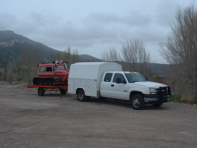

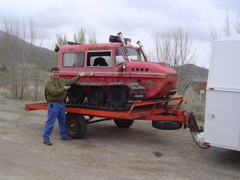

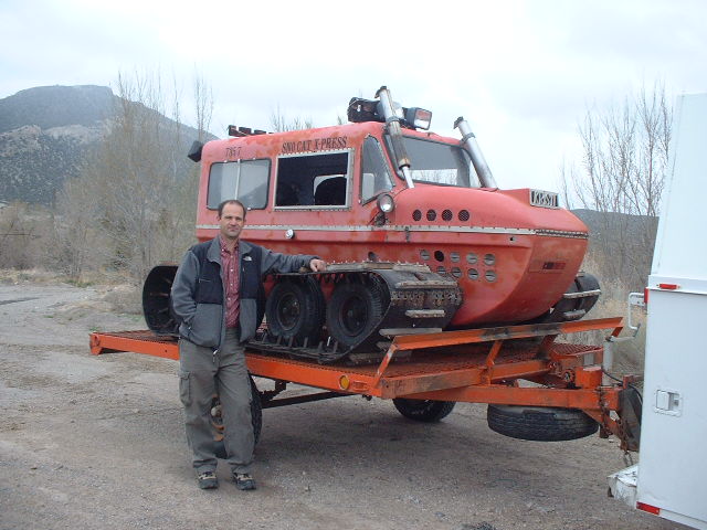

LMAO! :yum: OK now here are my Pictures.
The picture above is Bob Pierce. Shouldnt he get some type of points for having his mug put on forums forums?
NOW since we all know you cant trust a KKK member or Kristi cat owner to tell the truth especially about pictures, I had Bob take my picture with "MY" camera so I could have the truth recorded for all to see how I trully feel about Kristi snowcraps. This last picture of ME shows how I trully feel. Look closley at my hands! Bob I am so disapointed! OK I'm over it. Great time visiting with you. :tiphat:
(those are my Middle fingers)

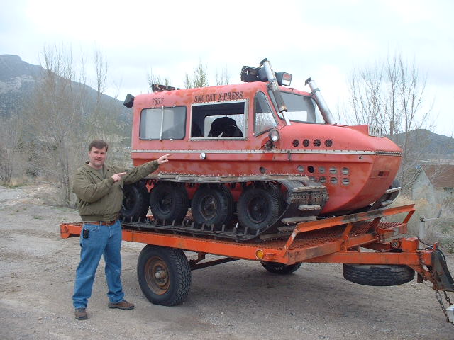

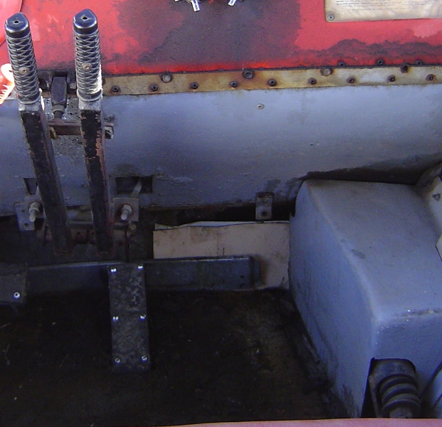

Well, I thought SnoOp would be able to show me the trick to changing the oil in my KT-3 today. He couldn't figure out how to get at the drain either. So, looking at my pictures tonight, I noticed the gap at the bottom of the firewall. There is a piece of metal wedged in there and what looks like a rectangle of cardboard. If I remove them I should have access to the engine compartment and maybe the bottom of the engine. Will try it tomorrow.
Good luck. I think you will find that almost impossible to reach as well. Your transaxle is real close if not directly if front of that. Plus you would need to reach up. Best bet would be to cut an access panel out front on the side. Yup them dual batteryies and such are right in the way. Even the brackets are in the way.
