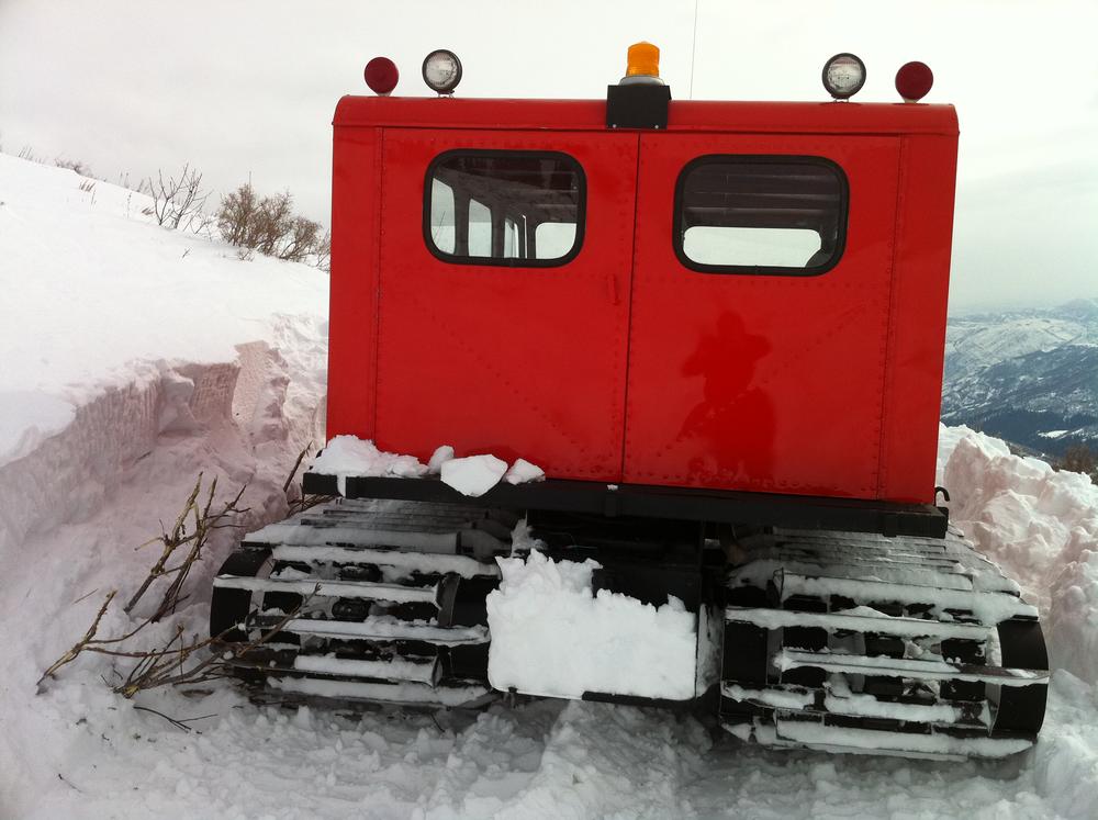

I tried to find a picture that would show the angle of the road cut on the road in to our cabin. This is as good as I could find. I can promise you that not even our big groomer ( LMC 3700 CF ) can handle this side hill with out plowing it to a more manageable angle.

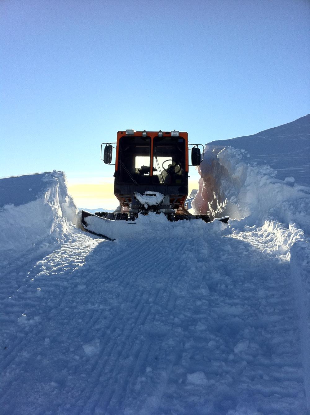

most blades are easy to take on and off, but it is much safer to level the road than to risk a roll or get stranded. One of the back roads to our place drifts in every day. It is dificult to get in on a snow mobile unless the road is leveled. Impossible if you are a beginner.
Here is a pic of one of the areas that drifts in daily. It is hard to see, but the right side of the road was built up while the left side was dug out. Where the right side of the track ends would have been the top of the snow and drops off to the right at an angle, after plowing there is more level area to right. The snow can get very light, so light you can not make a snow ball. The cat wants to slide down when side hilling in these conditions. Sometimes the snow density is so low the growsers will not bite into the snow to drive back up to the road.
I have video of a LMC 3700 CF that is stuck on nearly level ground in this area. The tracks both spin, but the snow is so deep and light it is basically high centered on a very slight incline.

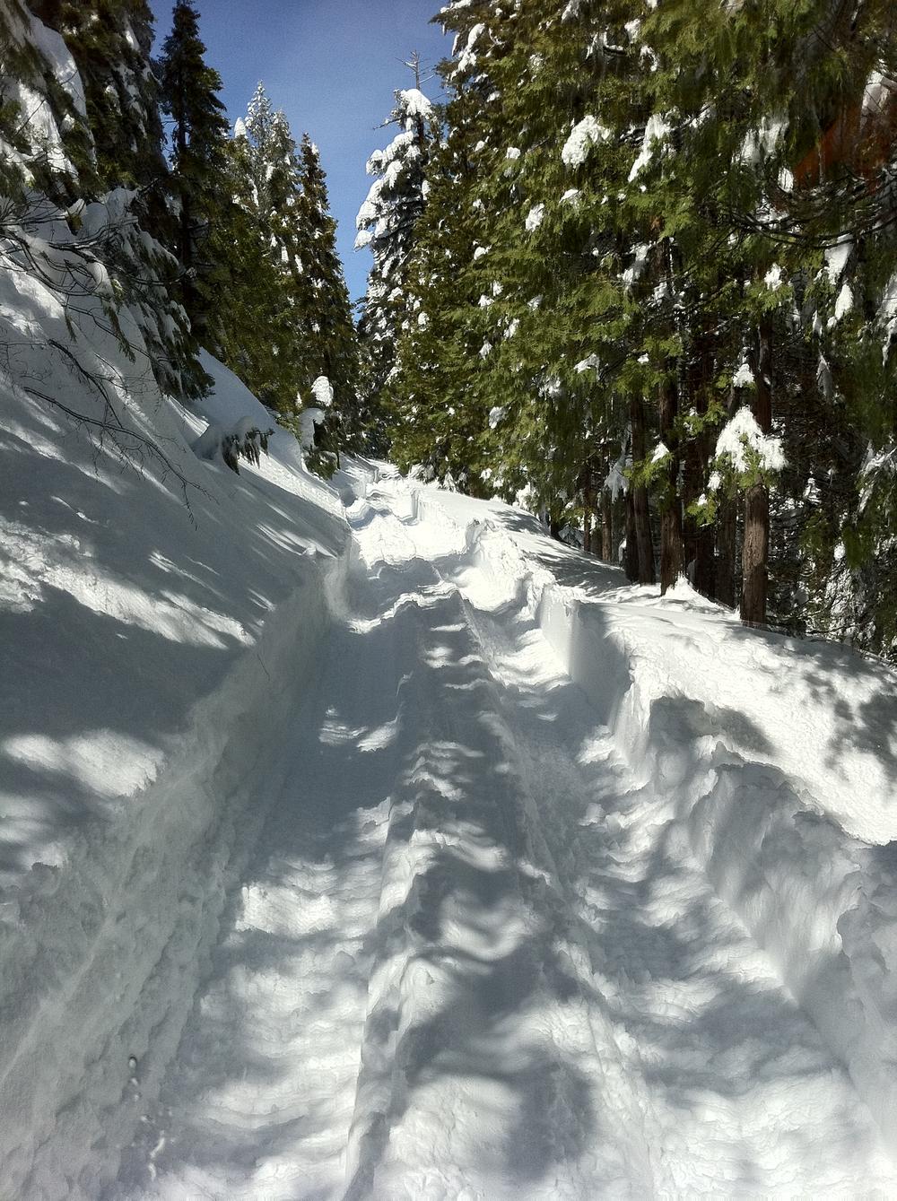

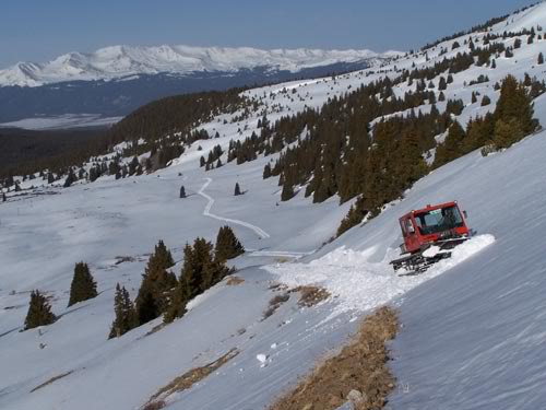

Here are a few of pictures of our Sno-Cat at work.
