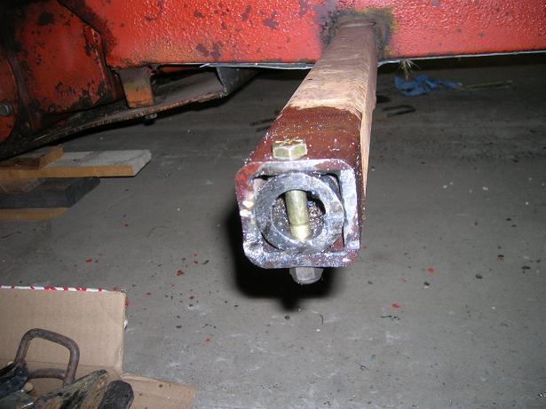

After my axle had broken, it was re-welded with a new tube, but after I bought it, I drove a heavy wall pipe down inside the new one and the front one too, then cut it flush, drilled holes on both sides and put a bolt though it to help it stay. Didn't weld the ends because I wanted it to flex a small amount and figure if I welded it, the weld would crack after a bit, where the bolt allows some flex.
Inside the tunnel, there was damage that the previous owner didn't repair when they replaced the axle and I had to go in and redo that, but here is a before photo of what to look for...
Don't know if it worked, but haven't had any axle problems. Did install new springs and they are a bit stiffer than the factory ones were, still have to turn the top one over to soften the ride some.

Installing the pipe like I showed above, isn't' that big of a deal and may save you a long walk someday.... Cheap insurance.
Just make sure the pipe is about a foot longer than the axle, because you will be beating it in with a sledge and it will look a bit mushroomed when you are done....
