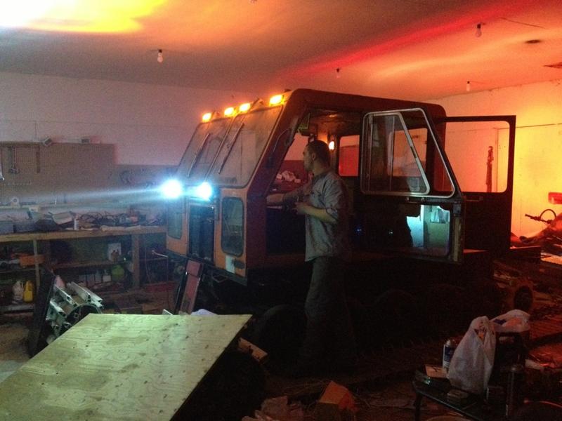

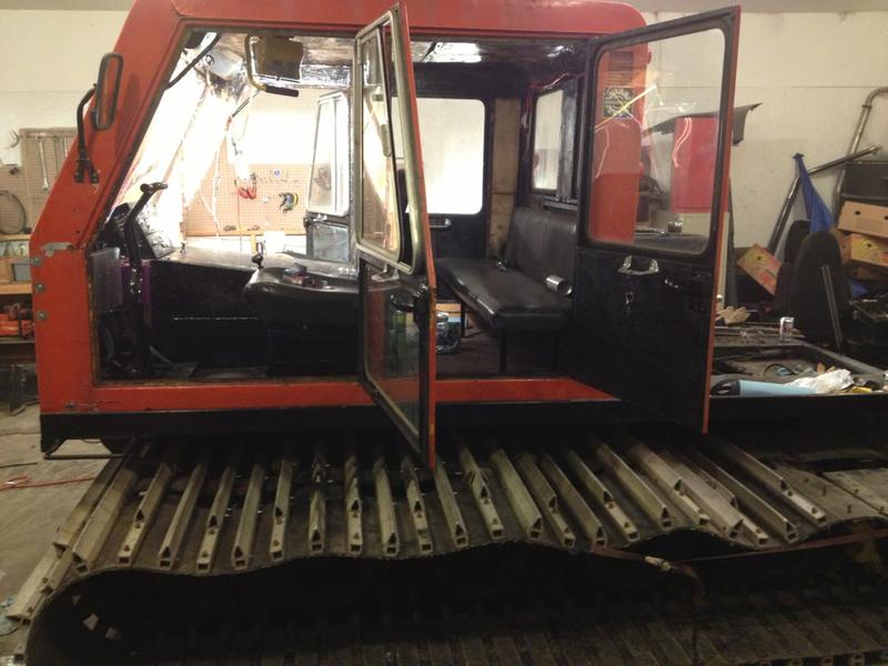

So I worked hard this last time home and was able to make some progress. ImageUploadedByTapatalk1357356538.574495.jpgImageUploadedByTapatalk1357356579.895084.jpgImageUploadedByTapatalk1357356611.528713.jpgImageUploadedByTapatalk1357356653.110347.jpgImageUploadedByTapatalk1357356675.135808.jpgImageUploadedByTapatalk1357356692.991608.jpg
Didn't get as many pictures as I wanted. But next time out I will.

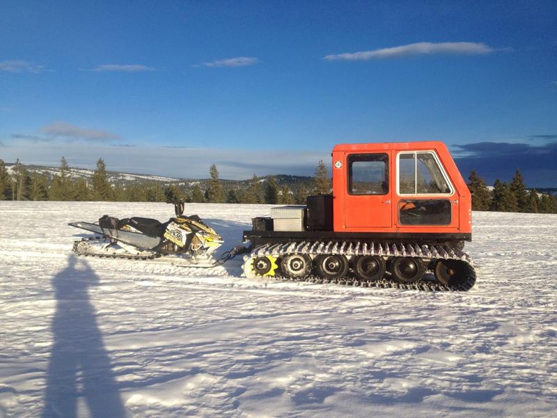

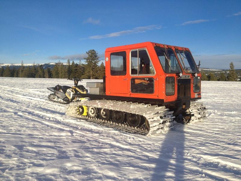

ImageUploadedByTapatalk1359692949.003736.jpgImageUploadedByTapatalk1359692967.861250.jpg
Here's just the two I got from this weekend, had a spring break in the distributor and it took three tries in the mountains before I figured it out. This was heading for home Tuesday.
