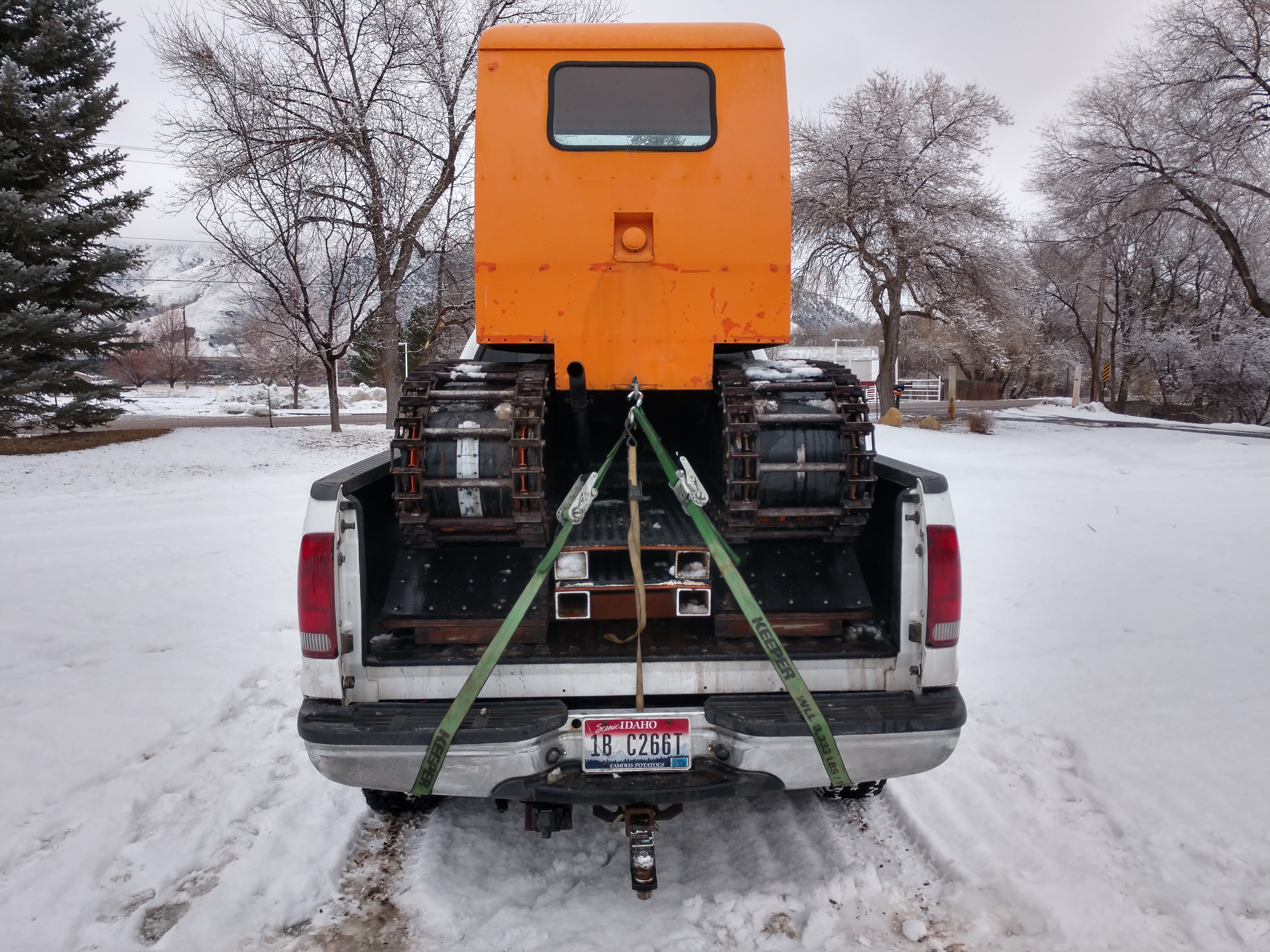

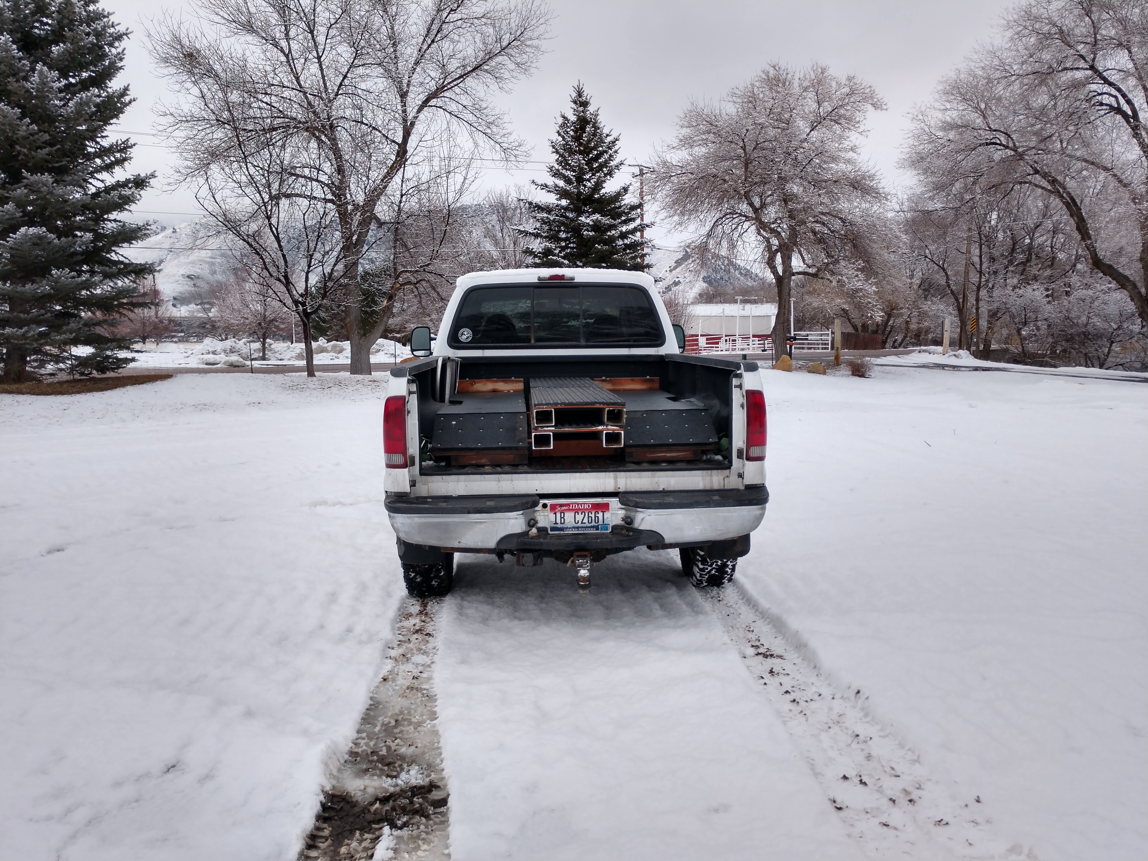

I just finished fabricating ramps so I can load and unload the kitten into my 2001 F350 long bed without the trailer attached. Previously I had to use the trailer to load the kitten. I would load the kitten onto the trailer using the trailer ramps, then move the ramps to make a bridge between the trailer bed and the truck bed, then drive the kitten into the truck bed. Since I wont be taking the trailer to the Kitten Love In next week I needed ramps to load directly into the truck. Here they are in use, work pretty good, in fact better than loading from the trailer.
They are 8 ft long and after use fit between the platforms in the bed of the truck which the kitten sits on since the kitten is wider than the wheel wells.
They are 8 ft long and after use fit between the platforms in the bed of the truck which the kitten sits on since the kitten is wider than the wheel wells. View attachment 145187View attachment 145188
you and your kitty will have a meow good time, good snow on the ground with about another foot plus on the way, going to epic kitten fun

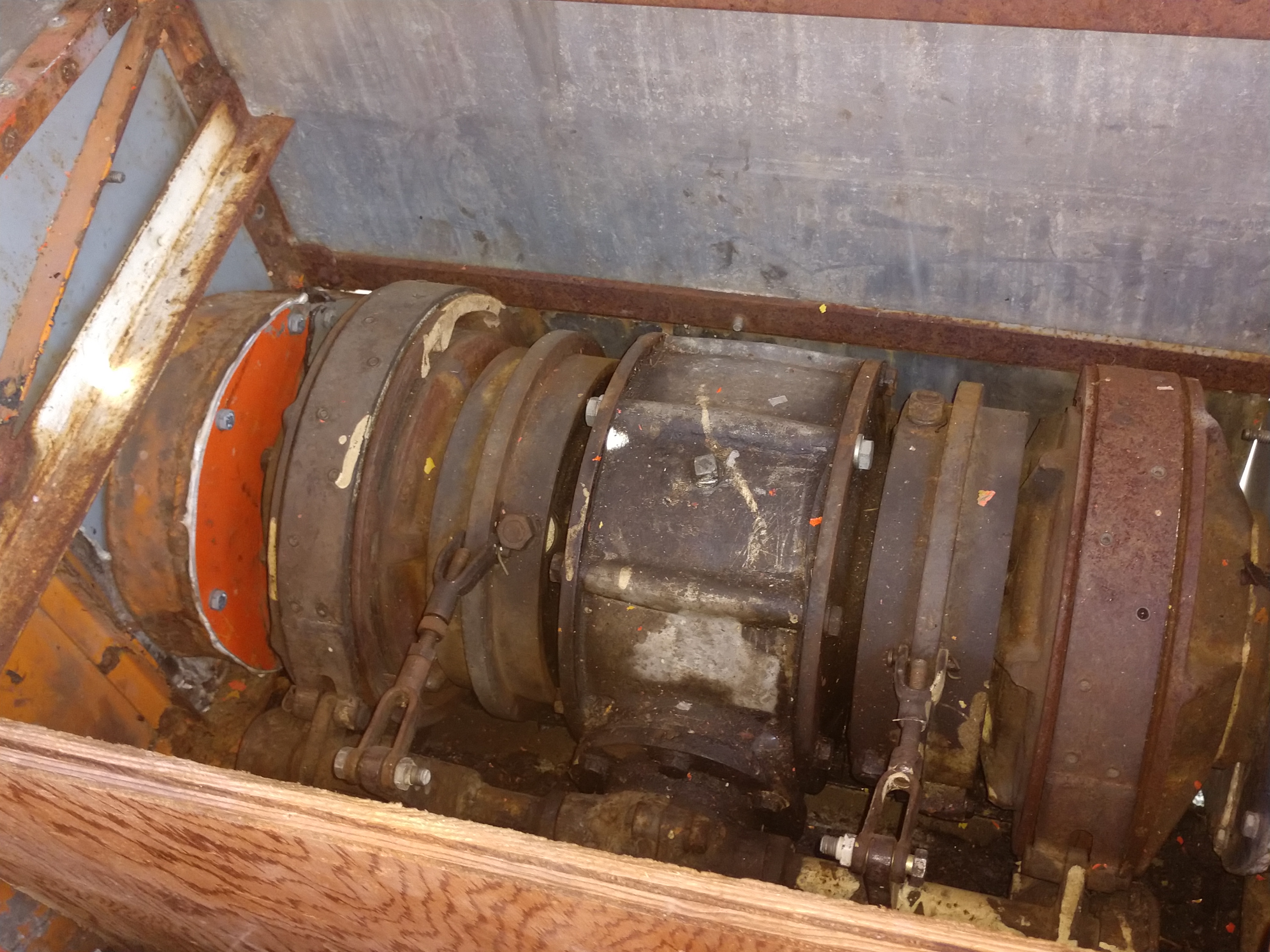

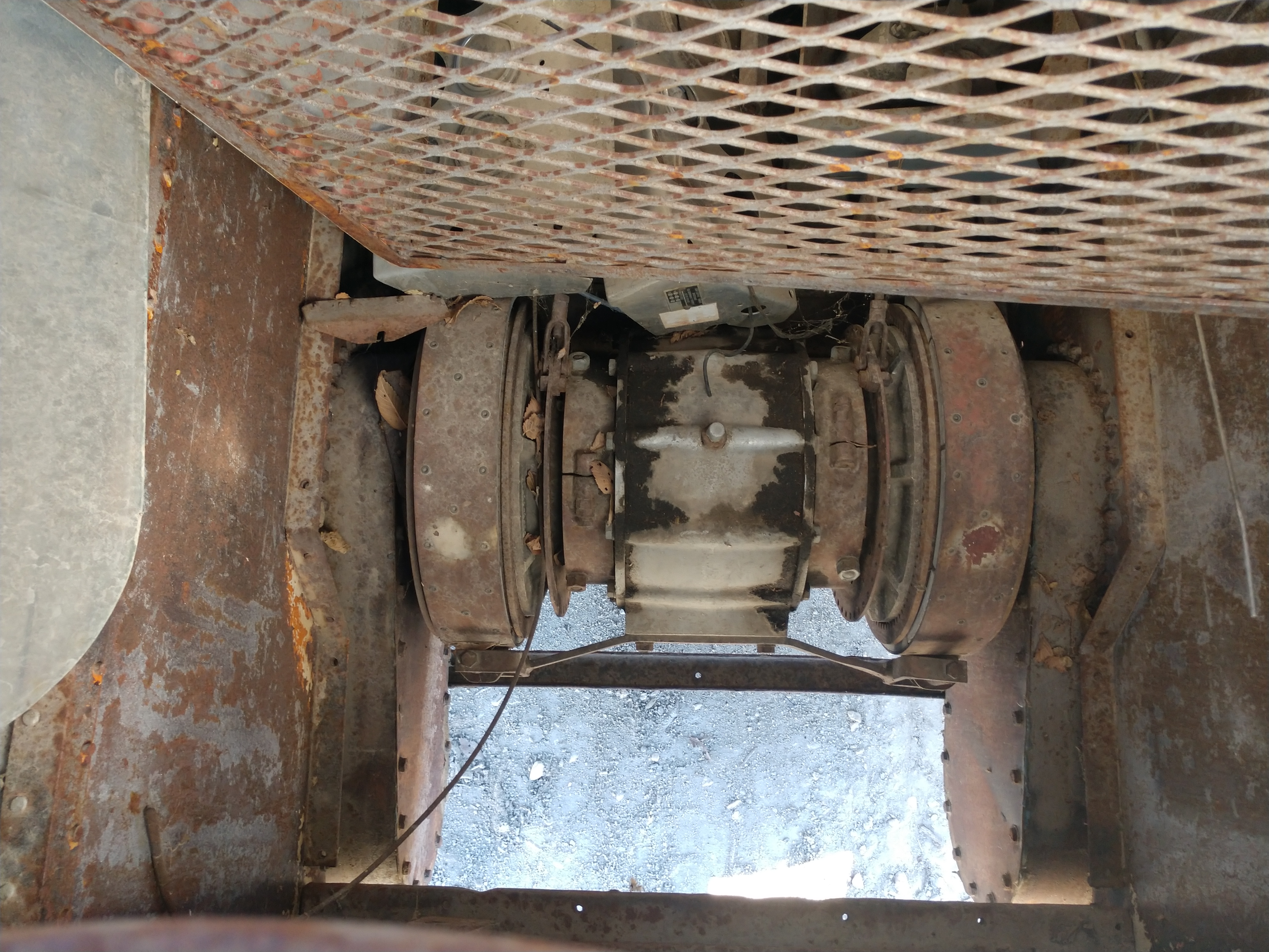

Help needed. Can anyone tell me what I have here. Are these OC4 rear ends? Please educate me, I know nothing about these drives. These are from two different cats, are they the same rear ends? They look similar but different.
4VL? Pretty sure the 4T's came with the Power Selector with two pickup differentials in the rear. Not sure what those differentials are, but they look the same as what @mkntrakes has in his 4VL.
One of these is a 4VL, the other has no model number on the tag.

Unlikely that Utah State developed the 4VL rear end for its earliest Trackmasters. But then where were they sourced? One of mine came with a new set of plates and discs but the previous owner had recently passed away and no one knew where he got them.
Thanks for the info.

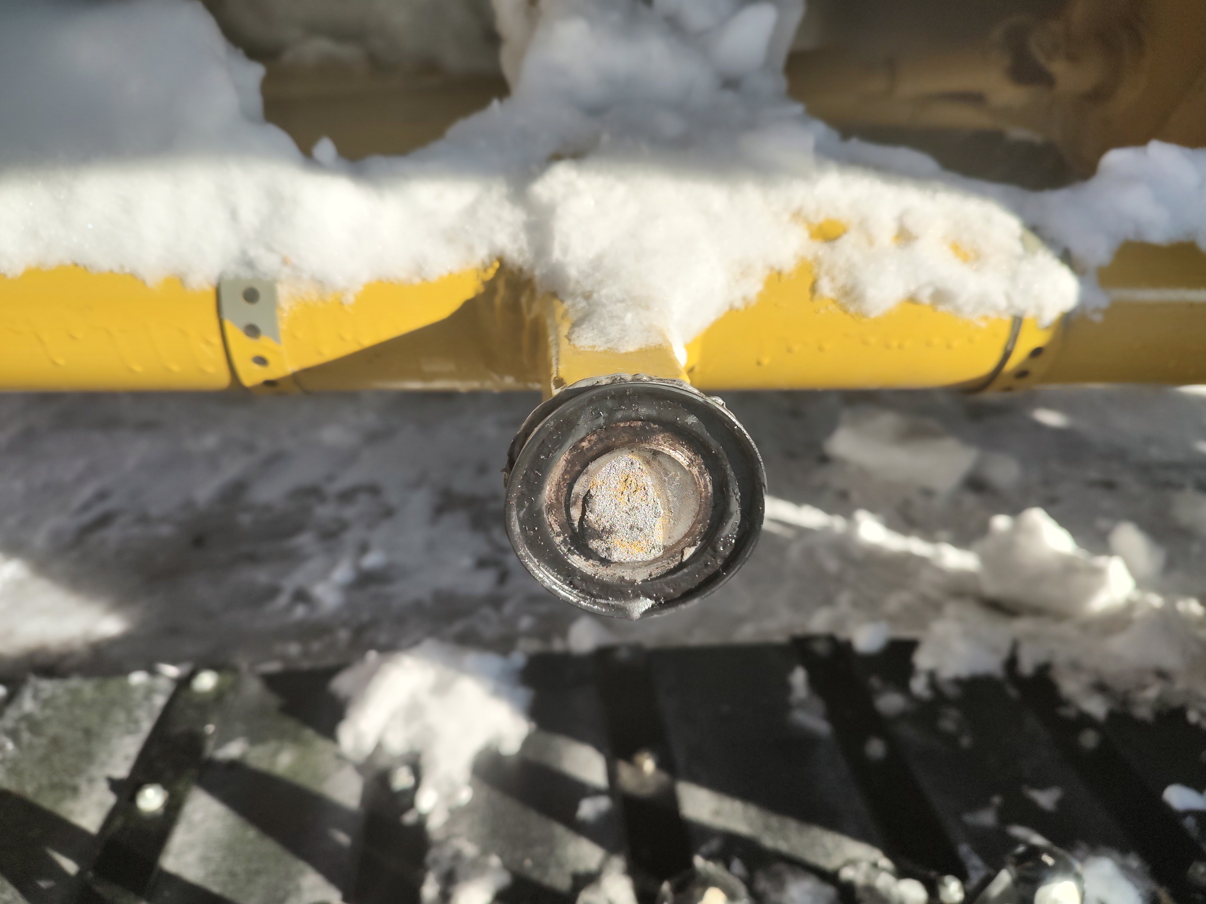

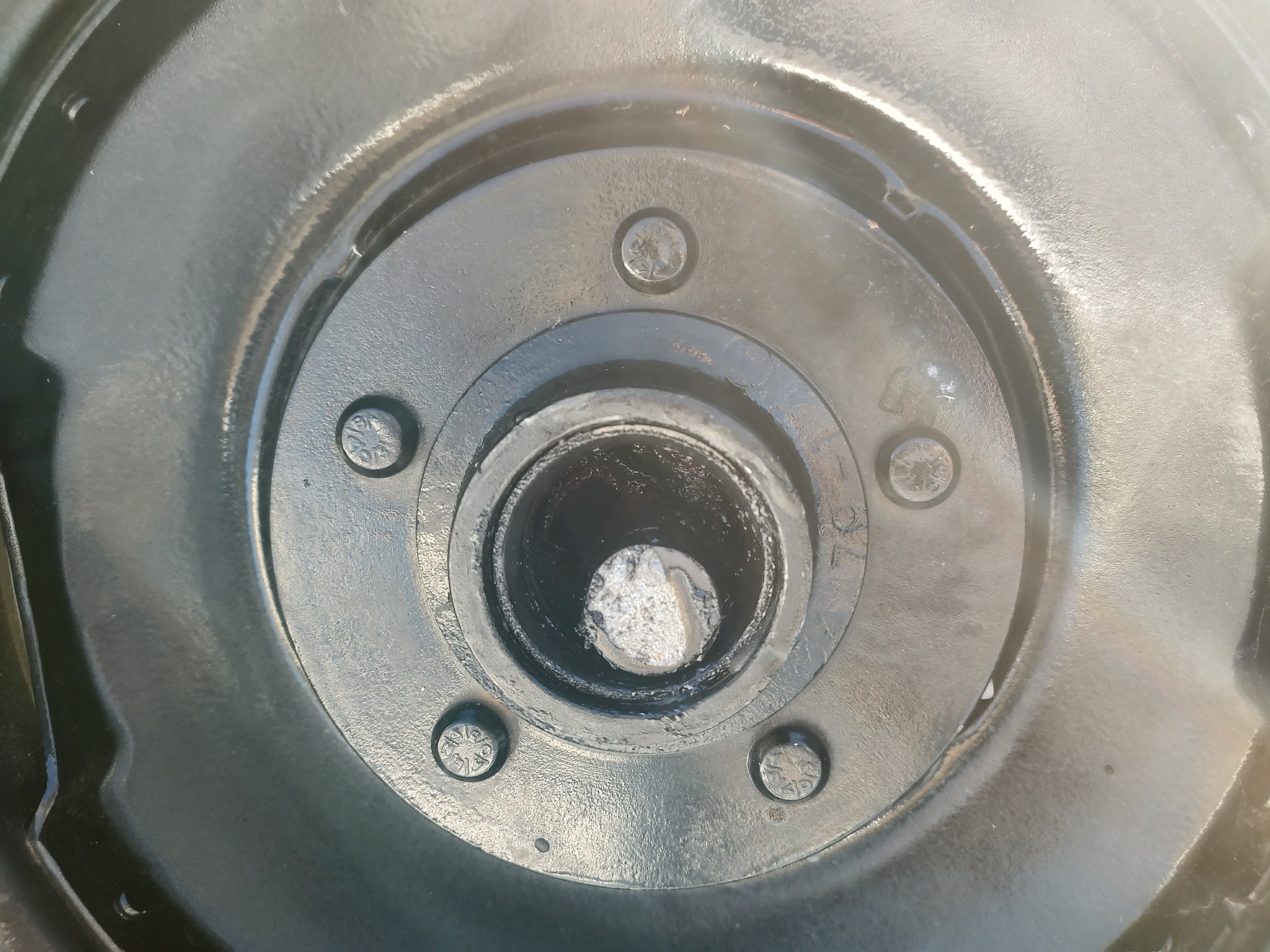

Frandee 37 broke one of her legs loading on the trailer a couple days ago. Near miss, this could have happened at the Alpine Cat Jamboree where I had just come from.
This does not look good......
Replace the spindle ?????
Looks like the axle tube is welded to the chassis ?????
I will make a fixture to keep the spindle concentric with the seal which is still attached to the cat. Then grind away to make a weld bevel, then weld away. About a days work, but it has been snowing here a bunch, is very cold, is windy, and I don't have a place in doors yet to work on the cat, so kind of procrastinating on fixing it. However, I want to take it out and play so soon I will jump in with both feet and get it fixed.
Copy on the indoor work place
Can you remove the old spindle from the Square tube and replace it with a new one????
Should be a standard spindle
There are many places online that sell universal spindles that can be welded onto square tube axles....

Hey I know a couple people that have experience repairing that on sight. Takes them about an hour, includes chips and snacks.
Oh, one of them just responded above me.
(and I can't find the picture I want of them repairing our local search and rescue cat when it sheered off the axle)
