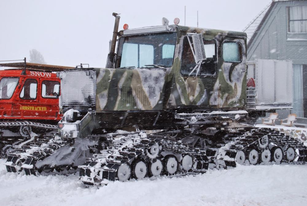

This Camo Tucker had a Cummins in it, It was at the last Leavenworth and first Mt Hood event. I believe his name was Joe and was from the Tri-Cities area of WA and quite a character.
:thumbup: That thing was a beast

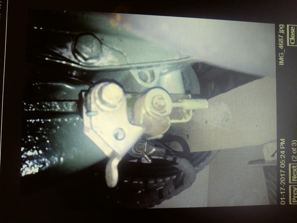

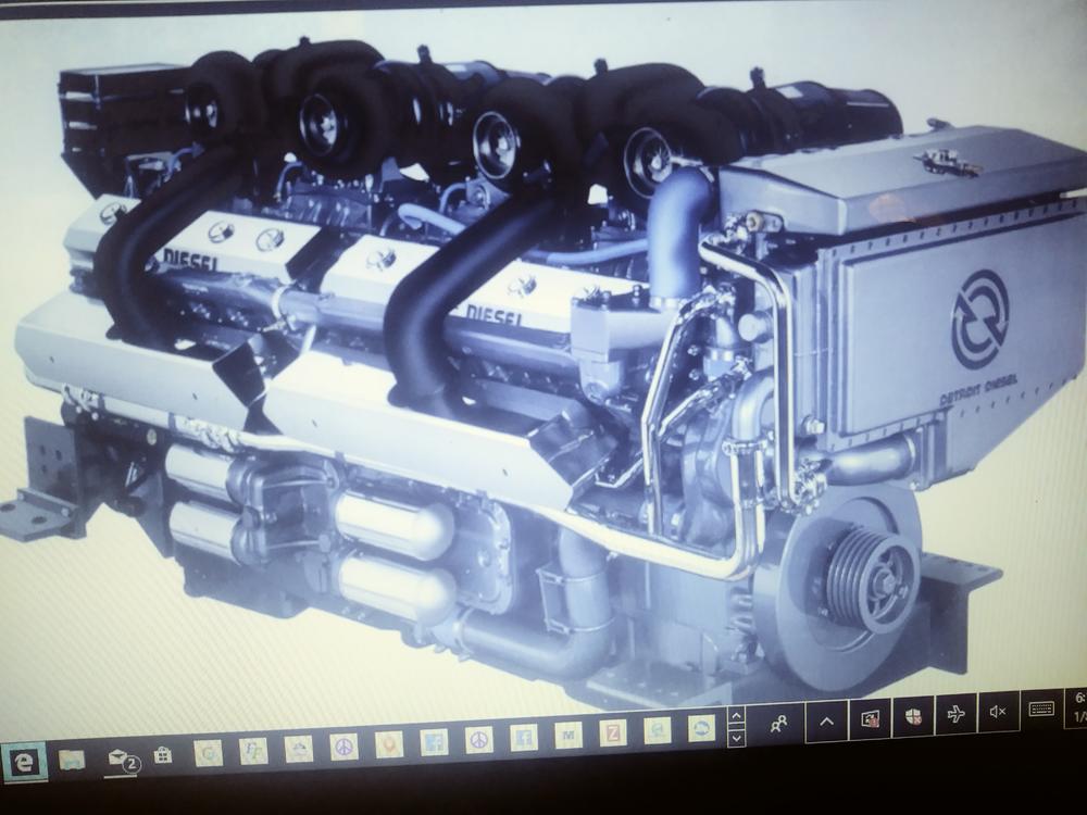

…………. maybe someone removed it, those were a factory item. oh they sure will run on oil (compromised blower seals, piston rings, etc.)… when you break the fuel supply line off , suck a shop manual thru the blower, and the bluw smoke starts rolling....all you can do is ''RUN'' ….. always good to have the rocker cover off. here's a pic of the emergency latch.... the engine pic is for a MEGA-SNOCAT....lol

Hahahhaaaa! It's not a 4-53, it's a 3-53!
Ive been calling it a 4-53 and expecting 4-53 power output. Its a 3 cylinder. I think I'm getting all she's going to give!
Well that sucks, I had to go back to your photo to take another look. Sure enough you are missing a port on that exhaust manifold. That is the first time I have heard of the 3-53 in a Tucker. The 3-53 tops out at 100hp and the 4-53 is 136. The 4-53T in my cat is 175hp.
