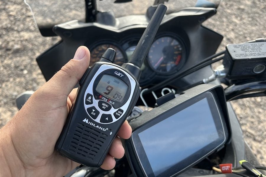

Midland GMRS radio
Photo: Justin Hughes
Writing about the Sena MeshPort Blue reminded me of all the problems modern motorcycle communicators have. They can be tricky to pair, Sena and Cardo don’t play nicely together, their range is limited despite manufacturer claims… The list goes on. It also reminded me of an alternative that I’ve been using since long before Bluetooth was even invented: radio. FRS and GMRS radios may be a viable alternative to traditional helmet communicators.
I’ve been an amateur radio operator since I was a kid. Even now, I carry a handheld radio with me on the bike. If I run into trouble and I’m out of cell service (all the best riding seems to be out of cell service), the national calling frequency or a nearby repeater might get me the help I need. I don’t have it set up to use while I’m riding. Years ago I did, with a helmet headset and push-to-talk button on the handlebars, but soon realized I’d rather enjoy the ride than chatter on the radio. That would be different if the people I chattered with were my riding buddies, but you need to pass a test to get a ham radio license and at the time equipment was quite expensive.
A recent video by Jake the Garden Snake has made me rethink this idea. He and his friend Rivet have been experimenting with various radios for some time, and have some specific recommendations in this video, which I’ll get into later. Rather than ham radio, where my experience lies, they’ve been testing FRS and GMRS radios. FRS requires no license at all. GMRS does require a license, but all that takes in the US is a $35 fee to the FCC, with no test, and it’s valid for 10 years. It allows more power than FRS. In the US, but not Canada, you’re also allowed to use a different antenna than the radio comes with and even use repeaters. It’s no wonder why Jeep, UTV, and other 4×4 enthusiasts have been flocking to GMRS as an alternative to the CB radio they’ve traditionally used. Even better, FRS and GMRS radios can talk directly to each other, because they share most of the same channels. There’s no conflict between different brands, either. A high-end Kenwood GMRS radio can talk to a cheap no-name FRS radio you picked up from Amazon or Walmart with no trouble at all.
Of course, off-road motorcycling has a few more challenges than driving a Jeep. We’re wearing helmets and need both hands on the grips, which rules out holding a walkie-talkie style radio up to your face while you ride. Helmet communicators work completely hands-free, which is why they remain popular despite the difficulty of pairing them and keeping them connected. They also have a limited range. Bluetooth transmitters are only 0.2 watts on the 2.4 GHz microwave band. This is because it was originally designed to wirelessly connect your phone to your car. The distance involved here is only a few feet, and there are no obstructions, which block microwave signals. While some helmet communicators claim half a mile or more of range, that’s only in line-of-sight conditions, where you can literally see the other people you’re talking to. Go around a corner in the mountains or the forest, and you lose that line of sight.
FRS and GMRS radios operate on channels in the 462 MHz range. That’s a much lower frequency than Bluetooth, which means it’s not affected as much by obstructions. FRS radios also put out two watts of power, ten times more than Bluetooth. GMRS handheld radios can go up to five watts. You can even go crazy with a larger mobile radio that can transmit 50 watts on certain channels, but this is far more practical in a 4×4 than on a motorcycle.
