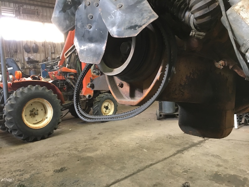

I've not owned a 1984 Tucker. I've had a 1979, three 1980 models, and a 1986. The 1986 had a Chrysler 360 Industrial, and the other four had 318 Industrial engines.
But every single Tucker used the same system for mounting the engine. They have a casting that bolts to the front of the engine, and it has a single bolt (oriented vertically) that attaches to a pad on the frame. Pics are helpful.
If you look at the front of the engine below the harmonic balancer and pulleys, you can see that casting I mentioned. This is a 318 engine.

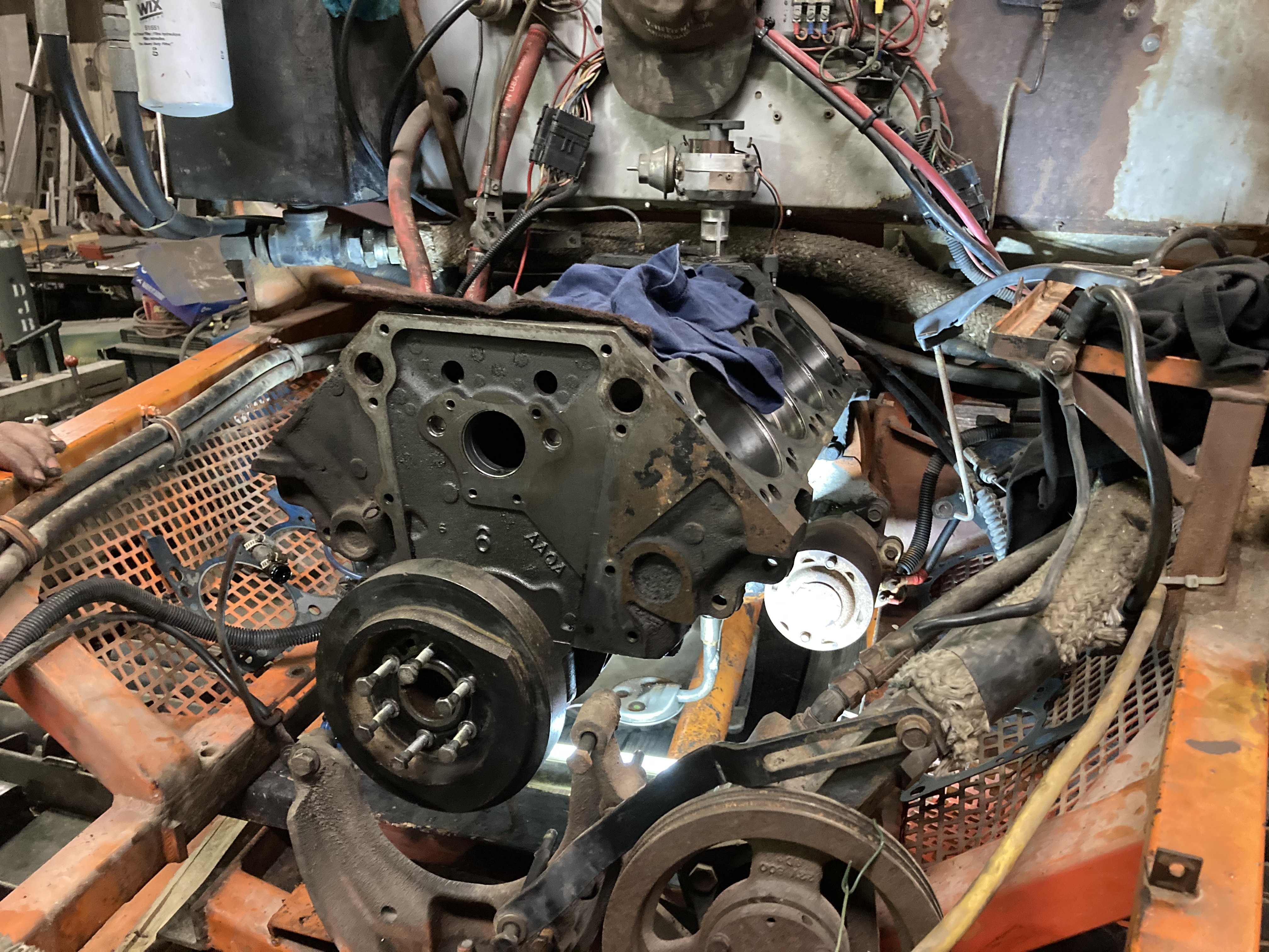

Here's a pic of the 360 engine (note the counterweight on the harmonic balancer. 360s are externally balanced) You can see that casting has been unbolted from the engine, and it's still attached to the Tucker truss frame.
And here's a pic of the frame where that casting attaches to.
You can see a frame weldment offset to the left side of frame's longitudinal centerline (right side in the photo) with a single hole in it. That's where that casting attaches
