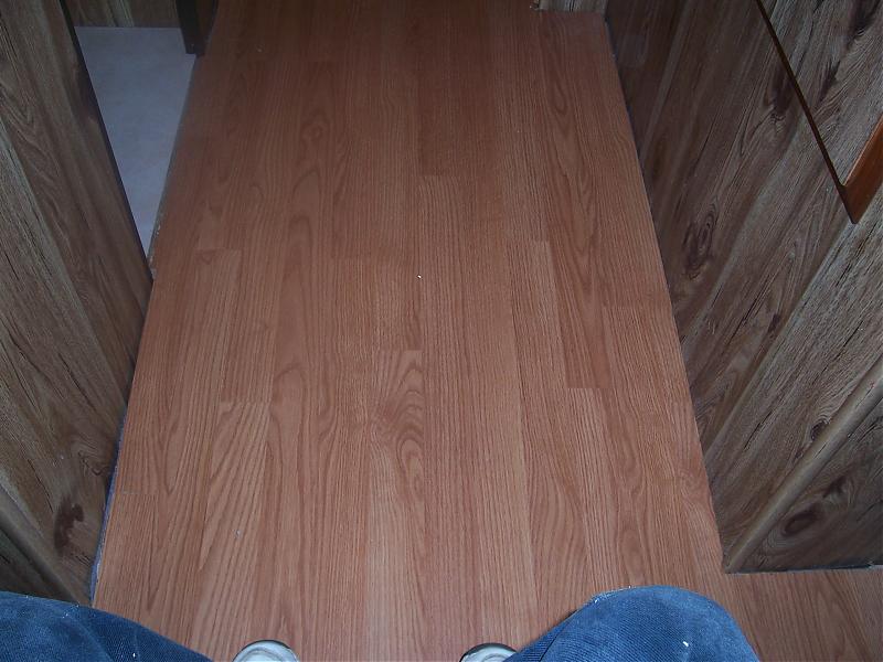

Monica went today and bought some trim. Instead of buying 1/4 round she like the cove. So that is what I'm installing. A little harder to install because of matching corners which I can't do well anyway and even harder in something that isn't square. She also bought a sheet of laminate. We are now going to recover both tables.:smileywac
Anyway, as promised here are a few pics of the floor and she can see some of the trim I got down. This allowed us to put the couch back in and the living room table.

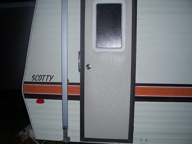

I've been meaning to give an update, but haven't had a chance. I was able to get the back door rebuilt to match the front door. I actually think it turned out a little bit better than the front one. Go figure.

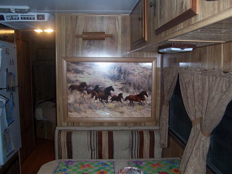

Behind the booth there had been a mirror. Following the western them we replaced it with this picture. It was a poster that was mounted. Monica bought a sheet of plexiglass for the front and we used some prefinished fake lumber for the frame.

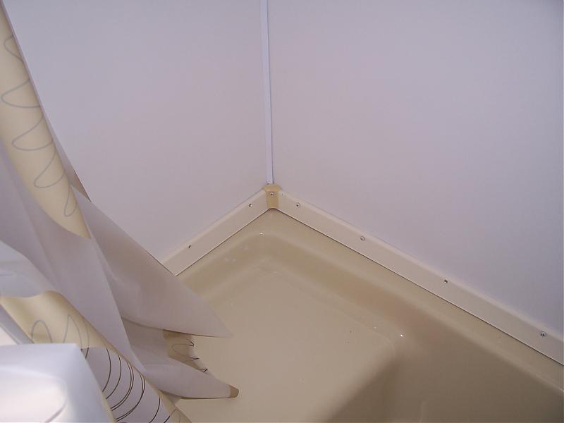

We couldn't decide how to "finish" the bottom of the new shower walls. We ended up putting the old trim back around it, but we used new stainless steel painted white screws screwed through putty to prevent water from seeping through.

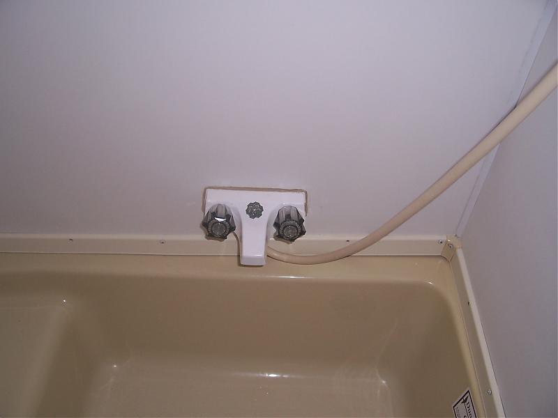

Next is the new tub faucet. We reused the old shower and hose. Wish they were white, but I couldn't believe how expensive new ones were. Maybe later, but for now these will do.

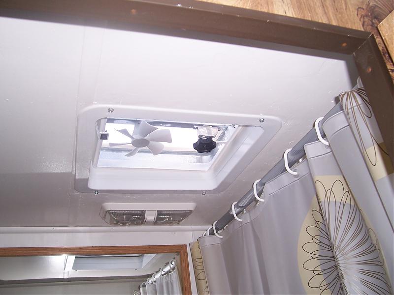

It took awhile, but we finally got the vent for the bathroom. That really helped the looks of the bathroom.

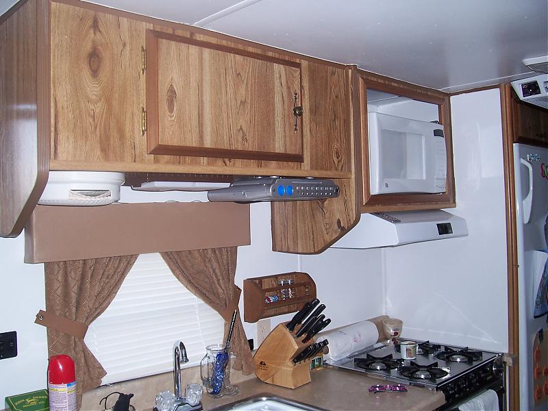

This is now what the kitchen looks like after the clock radio was installed and the curtains were finished.

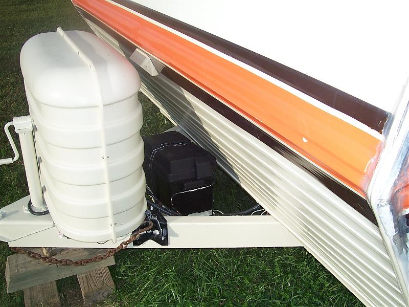

Here are some pics of the new battery box. I installed a little larger box & battery than was there originally. It was originally a group 24, I installed a box that would hold a 27 - 31. I install a group 29 battery. Eventually I'll cut the one bracket out and have some weld it back in. You can also see the tongue frame after sanding a paint.
Next is the new break away switch I installed. The wires had corroded off the old one and since it was 23 years old I just replaced it.

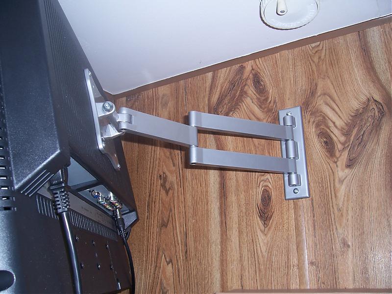

Finally are some pics of the TV.
First is the TV in "travel position." It is back flat against the wall directly inline with mount. The TV itself also rests on the valance for the curtain. There is actually an angle bracket directly below it. That keeps the TV from "bouncing" on the mount.
Next is a pic of it pulled out for viewing from the couch.
Third is a pic of it flipped around to see it from the kitchen.
Lastly is a picture of the TV mount.
