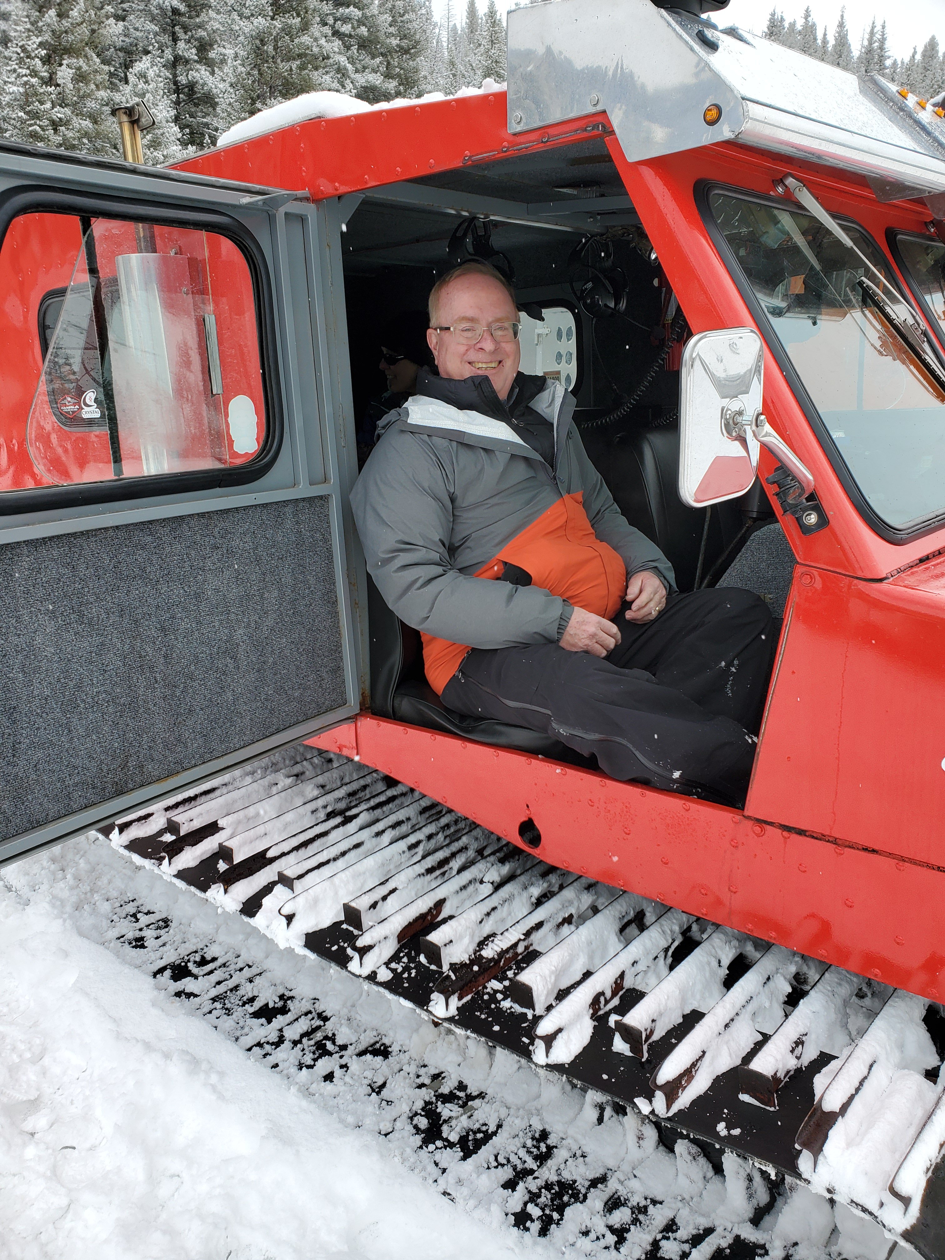

I'm down for a Kristi jamboree!! Here's #121 coming at you...
