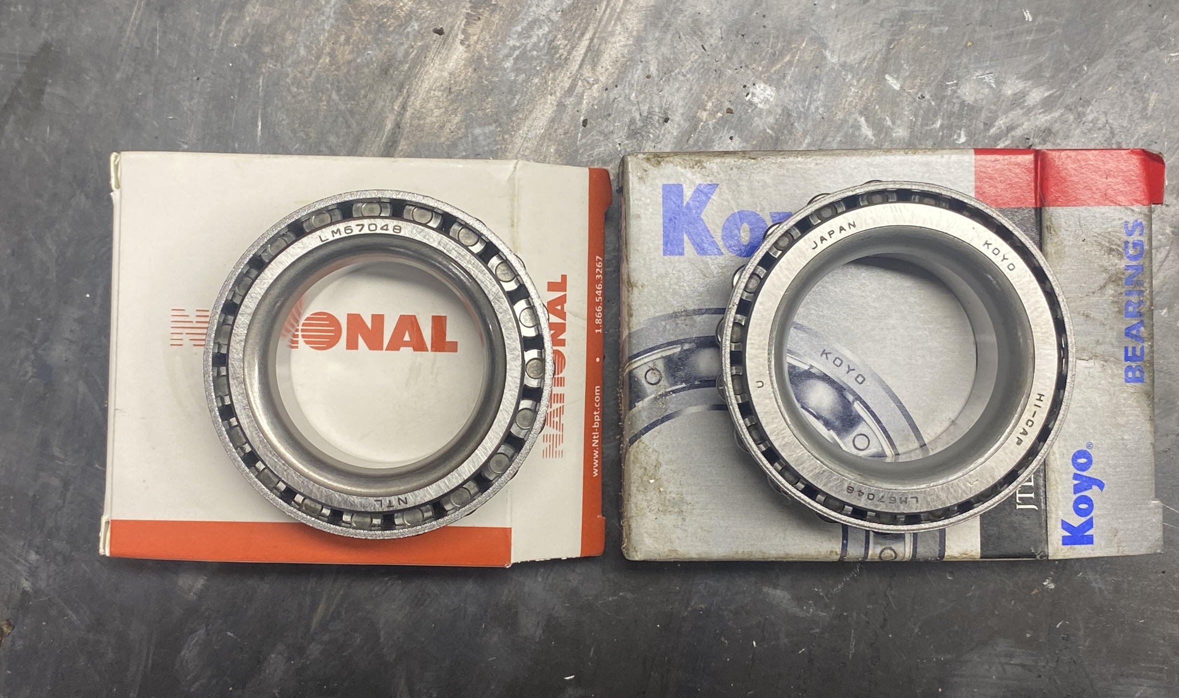

No. Some bearings were just about reusable, but 75% were junk.
It appears some bearings had lost most of their grease, and some had the grease converted to brown soup.
I decided to start over and do all the bearings and seals in preparation for using Buddy bearing hubs.
I ordered new bearings from a different supplier. I’m told they are the same specs, but they look different.
I was using the Koyo and now using the National brand.

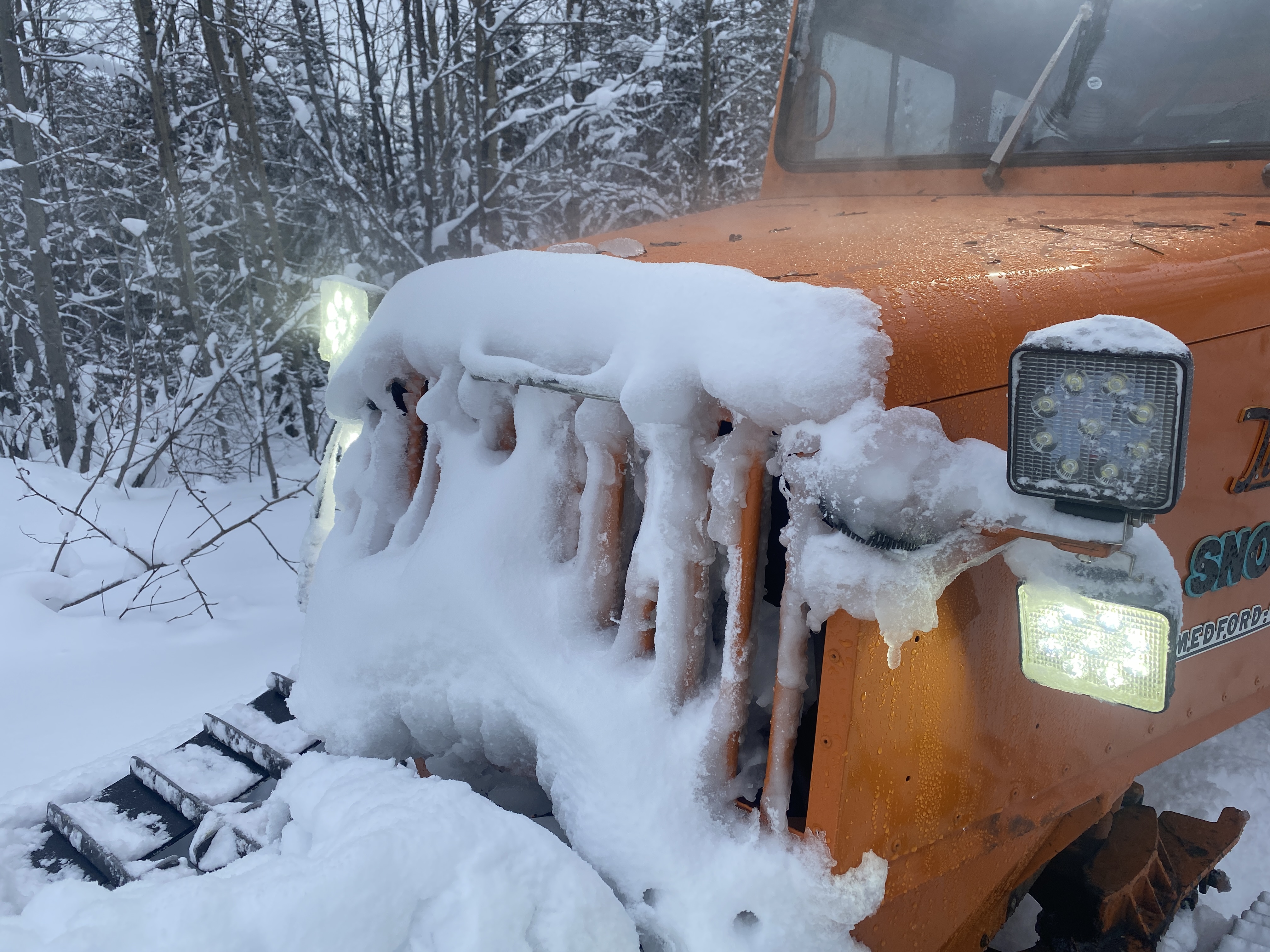

The new wipers were much better, but they built up with ice from the blowing snow. I’m wondering if lifting the back of the hood to let hot air hit the window would help?
The new style grill worked much better as well. I only had to clean the ice off 4 times in 74 km on the way back to the highway.

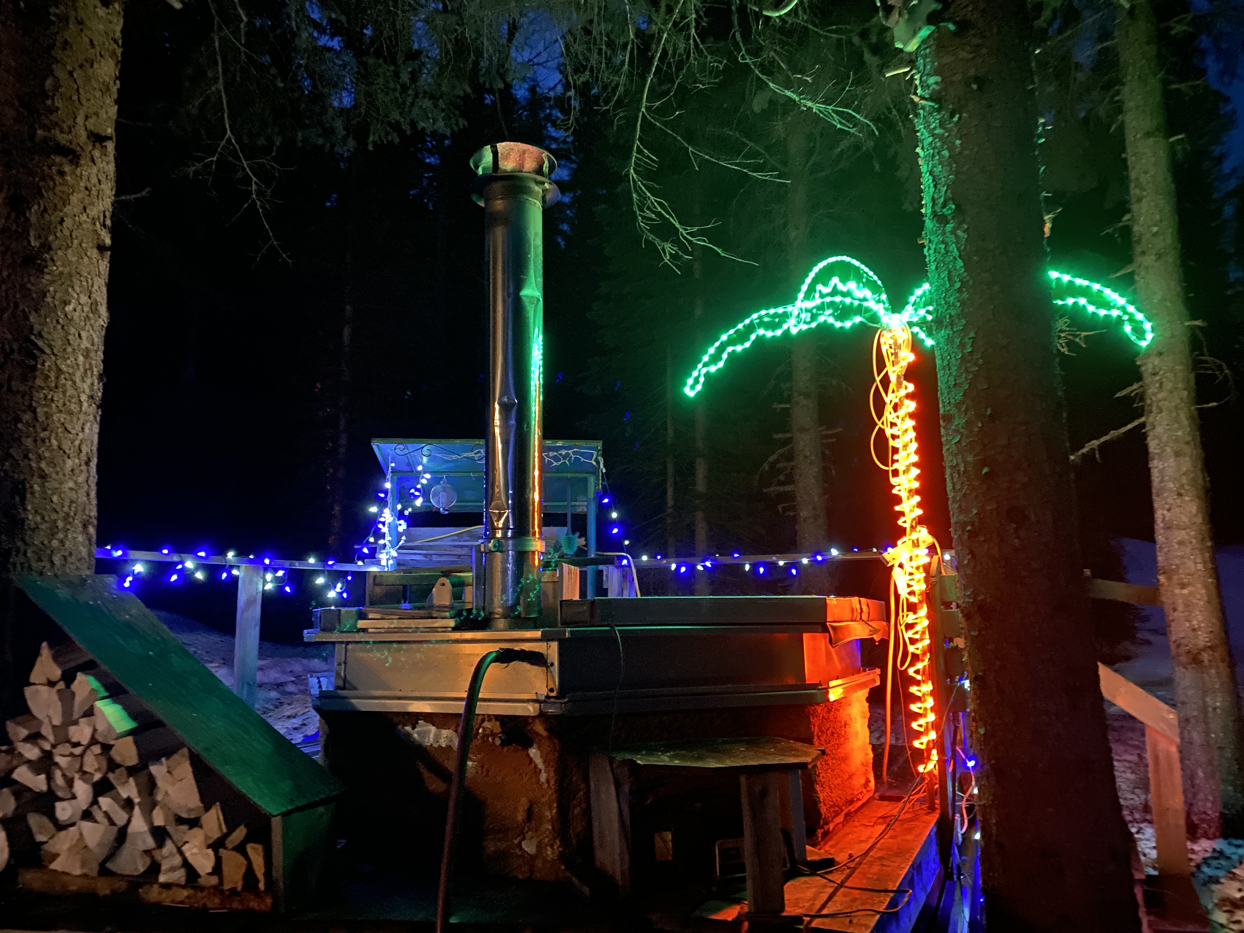

The hot tub at our club cabin seats about 10 people, 11 if some are female.
I calculate the tub holds 750 gallons of water.
We use a 2” sump pump from the creek to fill the tub. It takes less than 30 minutes to fill. The tub is aluminum with spray foam insulation and removable cedar seats and floor. We empty and clean the tub in the mourning or before next use as we use no chemicals, so we keep the heat on.
For heat we use and in tub fire box and big double skin boiler that takes 3’ logs.
At -20c and I fill the tub there will be a skim of ice on the surface when I finish and put the hot tub lid on. At that temperature it take about 4 1/2 hrs to raise the water temperature to 102 f. We use an in tub pump to circulate the water through the boiler with 1” rubber hoses.

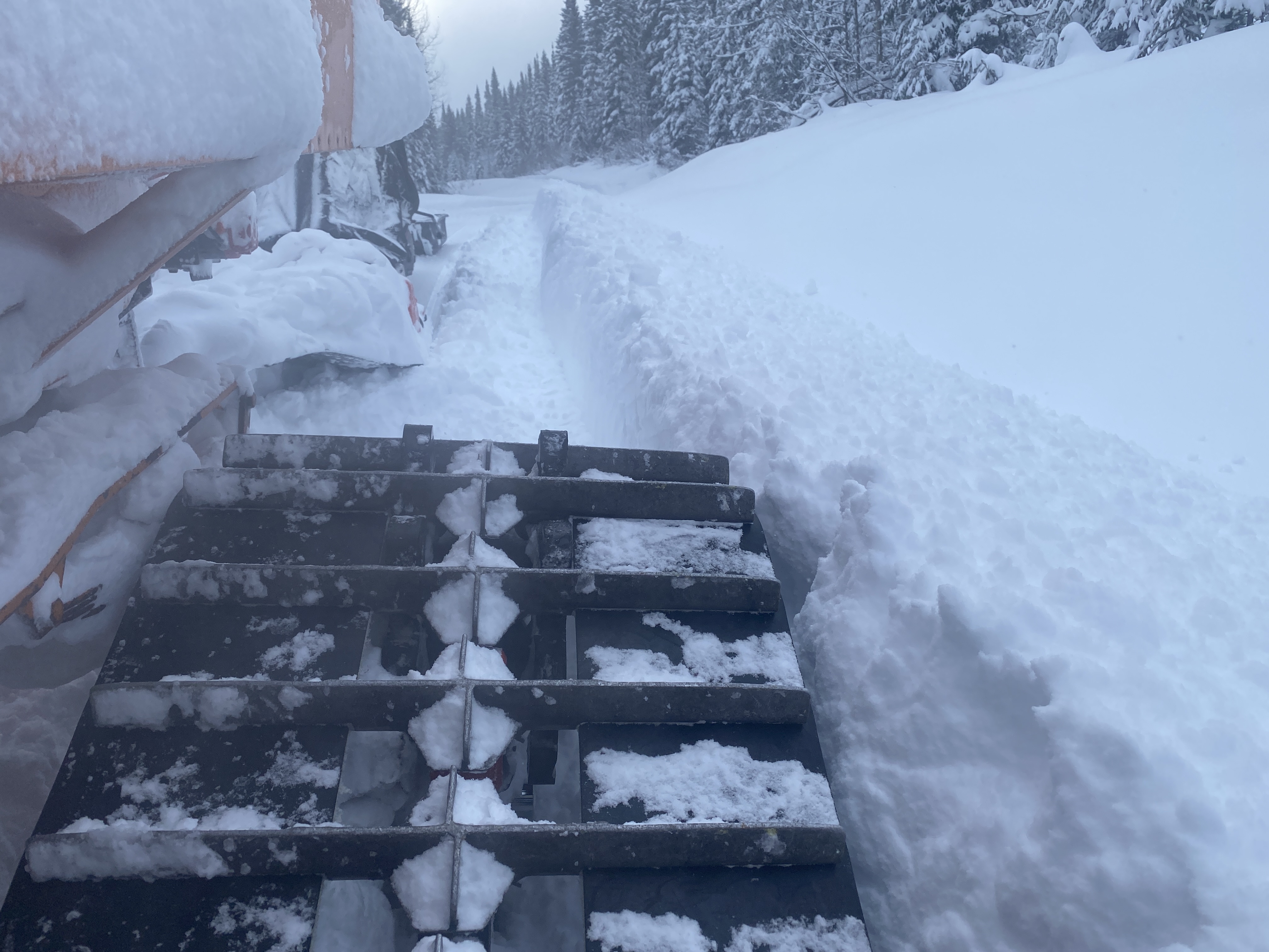

The snow was reasonably deep as even with the blade up as high as it would go it was still scraping the snow.
So most of the 74 km trip out was in 2nd gear and 1st gear on any incline. This was while pull a V plow under the fuel skimmer, with my snowmobile on the back and a second skimmer behind the snowmobile.
The fellow that packed up the cabin and travelled out behind me says the Tucker combination left a good trail and he was able to hit 90 kph on the way out.

I know you changed the grill. How was the engine temperature during the long trip?
The grill change worked out good. There is no horizontal grill work for the ice/snow to build on and block the flow. The vertical rods do eventually build up but air passes by for a much longer time.
