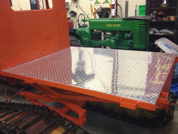

I got all the diamond plate floors and rear deck cut. Hope to fasten them in tonight. Will post pics soon!!

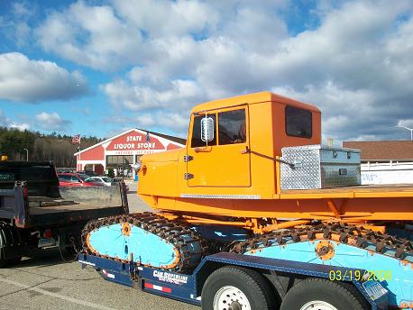

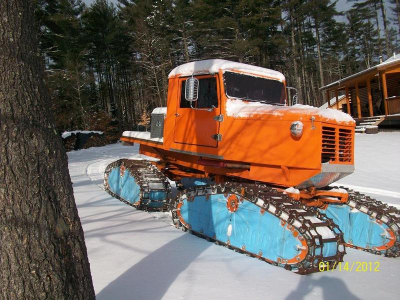

OK here you go. I hope. Attached are three photos. My Old Tucker was purchased in 1996 for $ 500.00 from an older gentlemen who had a small ski area in Woodstock Ct. The area closed and I tracked him down and bought it. Wife thought I was nuts. But it sat for about 12 years with little attention. Then in 2008 I decided it was time to get serious and the restoration continued. It is not as straight as the pics show. The hood and roof where rough. All lower side panels are new. Each fiberglass pontoon was rebuilt and repaired. New pans on bottoms.All bolts where replaced and cotter pins replaced on tracks. I would recommend Bolt Depot out of Mass. Each track link was removed and greased. All rollers were greased and are being rebuilt. Last winter we took her
for a ride when I moved the machine to NH from CT. One of the pics shows the NH Liquor store in the background. I have to say I was impressed with its ride. Anyway, this year the project continues and will be removing the interior gas tank to move the seats back. My tank is in the tool box. Anyway. Thats the short history of my Tucker.

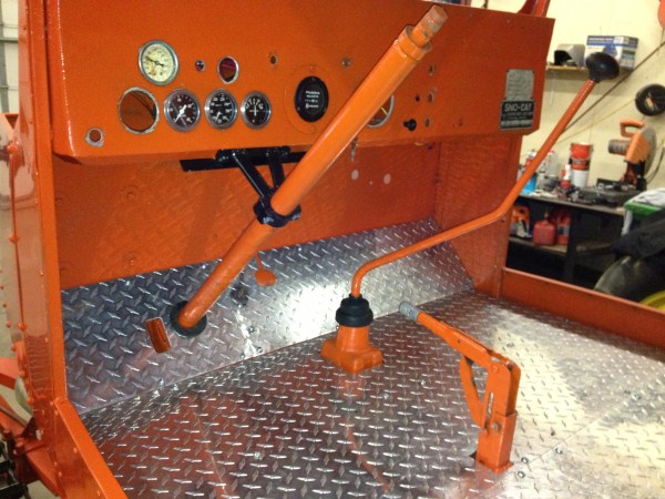

Finished the interior floor last night. Pictured is that grommet I mentioned earlier. I made this panel two piece so you don't have to take the clutch and wheel parts off to do most service.

drilled and tapped 1/4 20 for the floors. 1/4 20 clip nuts worked well for the thin metal on the firewall.

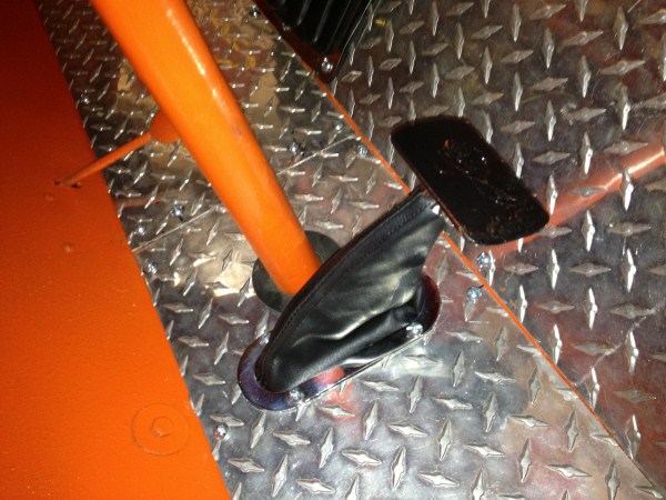

Got the rear deck on last night. Found some boots at pep boys for he shifter and brake that worked well.
Think I have something for the clutch through the floor but am also looking for ideas.
on the military vehicles with that arangement the pedal coming through the floor had a plate with a gasket on it so the hole is sealed with the pedal in the up position

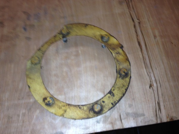

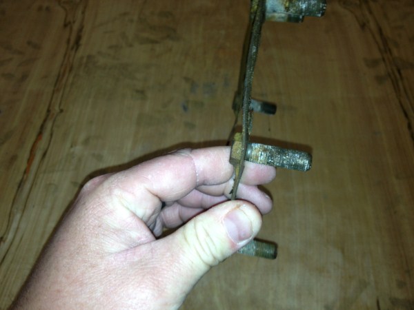

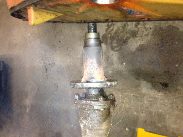

Took the front pontoons off last night and here is what I found:
1. They are in fairly good shape. Little repair and reinforcement and should be good.
2. The ring that holds the outer bearing and carries all the weight is flimsy. There must be a better design. Anyone cut new thicker rings?

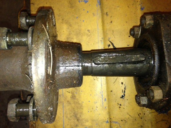

3. One hub is cracked at the key I plan to weld it. The other is frozen on. put a bunch of heat into it and hit it hard. Nothing. Any ideas?
4. Has anyone made new shoes? I have one or two for spared but I am thinking about just cutting the rails and welding them on to a new 1/16 sheet of steel.
I have two spare hubs but the ends are threaded unlike the ones in the pictures. Did they change at some point?

Good Morning. Snowing in NH this morning.
Regarding your Tucker.
1. I built up the strength of my fiberglass pontoons by adding fiberglass and fabric to the inside area where the axle goes through. This is where the weight of the machine axles sit on the metal collar and I had a lot of
fiberglass fatique there. I also welded a 1/8 in plate to the same collar on the inside same location. I then bolted through the fiberglass to strengthen this are.
2. The ring that you talk about is flimsy and I believe it is just a template to hold the bolts in place and prevent them from spinning as access is difficult. Again I reinforced the inside fiberglass around this area.
3. Dont know much about the hubs.
4. I had four new shoes/ bottom plates fabricated. Painted up real good to slow down the rusting. I think the steel was a bit thicker than original. I can check them later if you need more info.

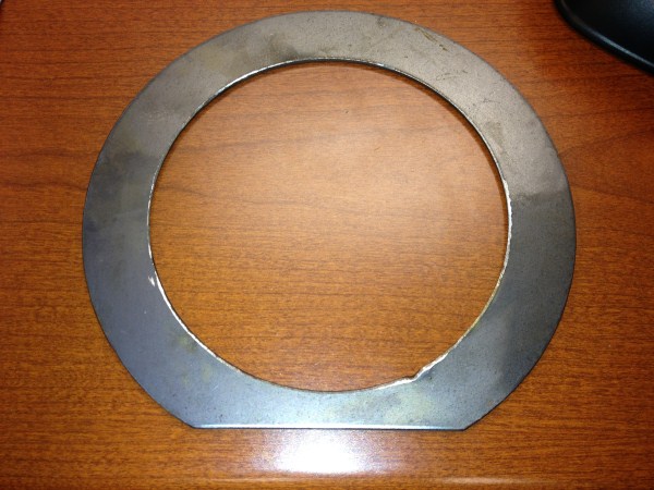

Fortunately mine are in real nice shape. I plan on using some west system to add some extra strength anyway. My friend is making me 4 new rings out of plate today and new shoes for the bottom.
The seals on the axels look good. This has definitely been apart before. I received a broken Axel extra with it so who knows .

Found a lokar parking break boot that worked well for the clutch.
Welded the hub and started the pontoon repair. Hopefully putting my glass back in today.

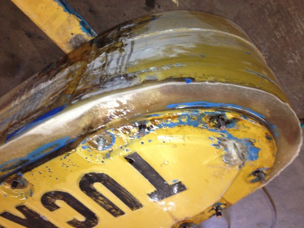

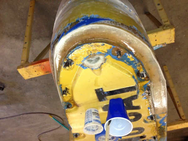

Got the fiberglass repaired on one side. That West system is amazing. The white is just thickened so it wont run. Will sand it down tonight.
The area where the rollers wore the fiberglass I took tape and made and edge/mold. Poured the fiberglass resin in to it and this is how it came out. Better than new.
Also got the new backer plates from my friend. This should increase the strenght over those flimsy backers.
Also epoxyed in washers cut in half for the adjusters. Now it will push on metal supported on the out side edge which is strong. Should eliminate the bolt pushing in like on these.

Have finally come to the worst part of restoring which is the pontoons. Fiberglass work is slow. Can only work one side per night and it usually takes two nights per side.
Will be done the front two soon and will restore the last two with spare I have and swap them out when done. This way I can at least use it if the snow ever comes.
