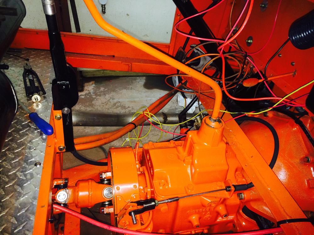

Transfer painting in progress. Seals here this week. Hopefully pop transfer back in. New ignition runs sweet. Shifting is great. All is well moving forward!!

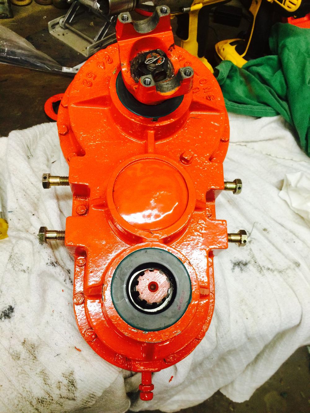

New u joints for input shaft. Seals in tomorrow for xfer case

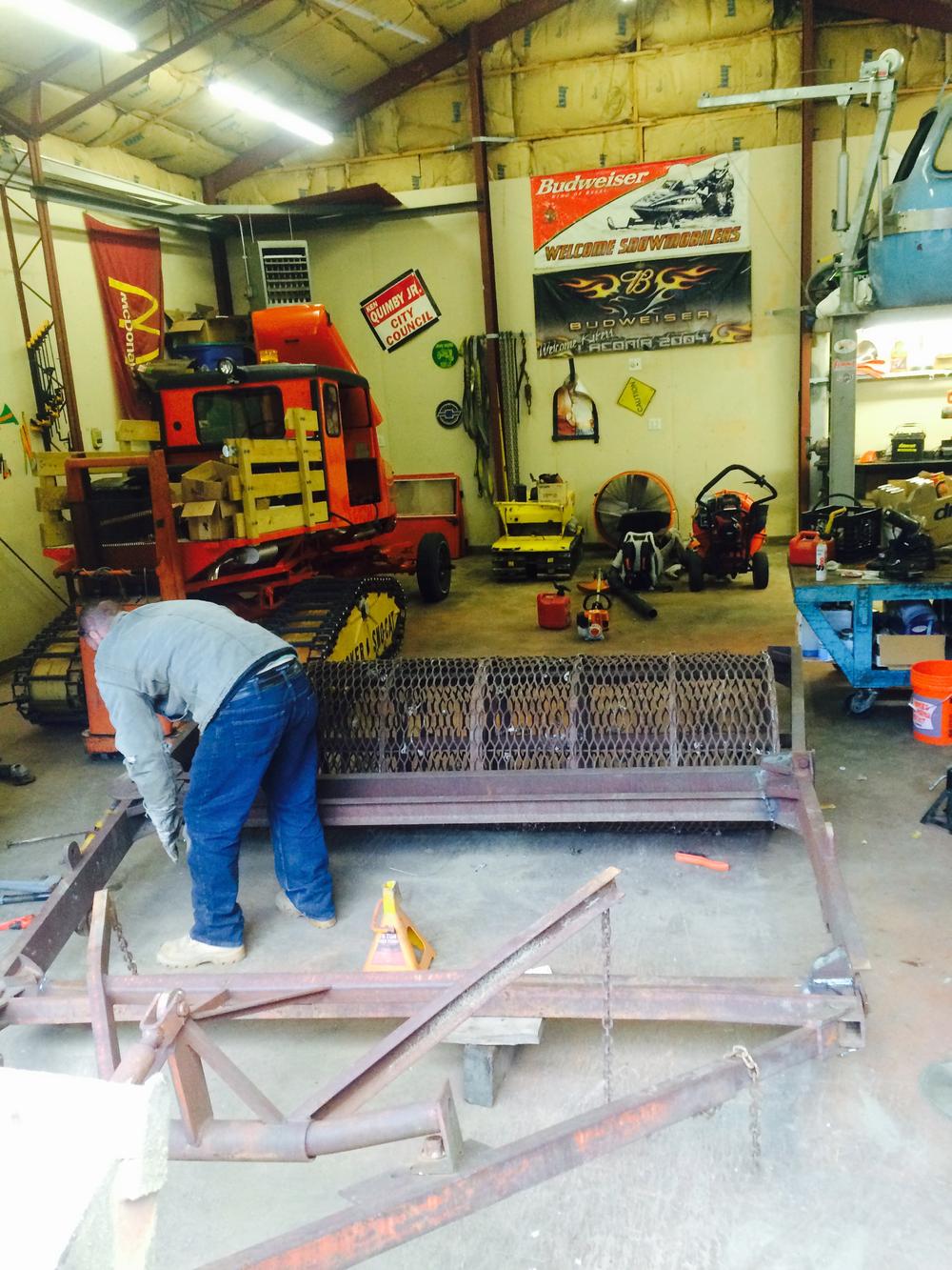

Hit up the topsfield fair antique tractor pull. 41 jd h came in 8 out
Of 10. They still look and sound the best. Friend dropped off my seals there for home with e time for install. Case in frame tomorrow then steering time!

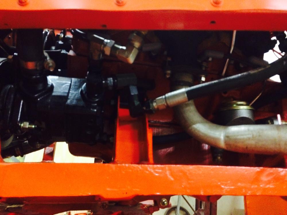

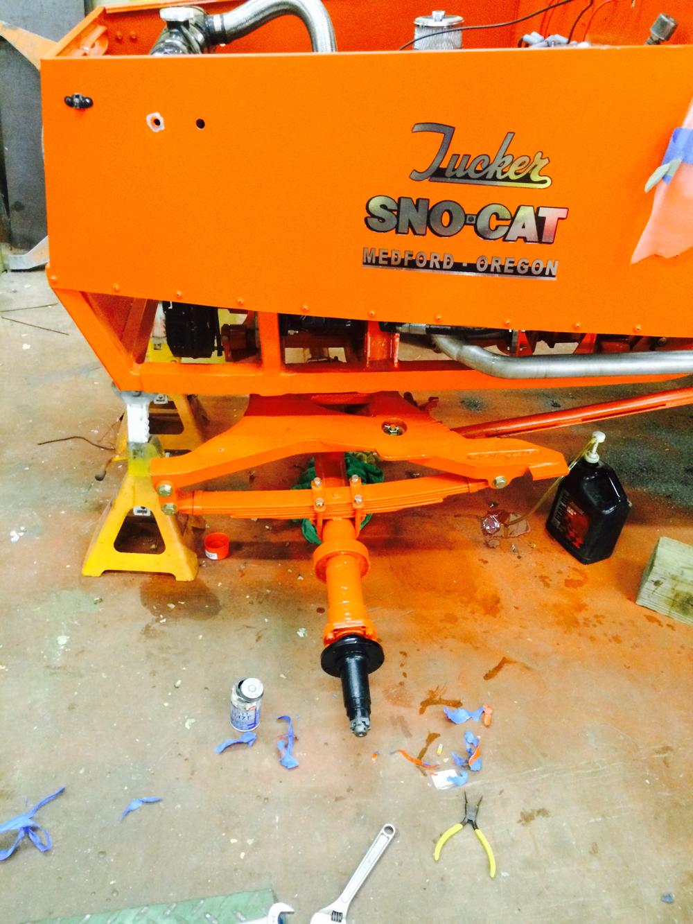

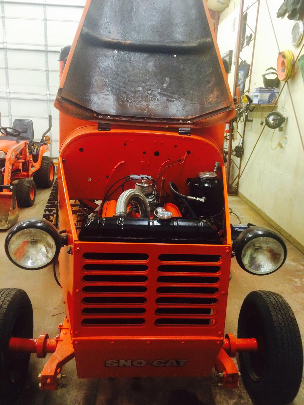

Steering back. Hydraulics check. Transfer magnetic plugs and front diff. Front tires and rear driveshaft tomorrow ! Driving by this weekend.

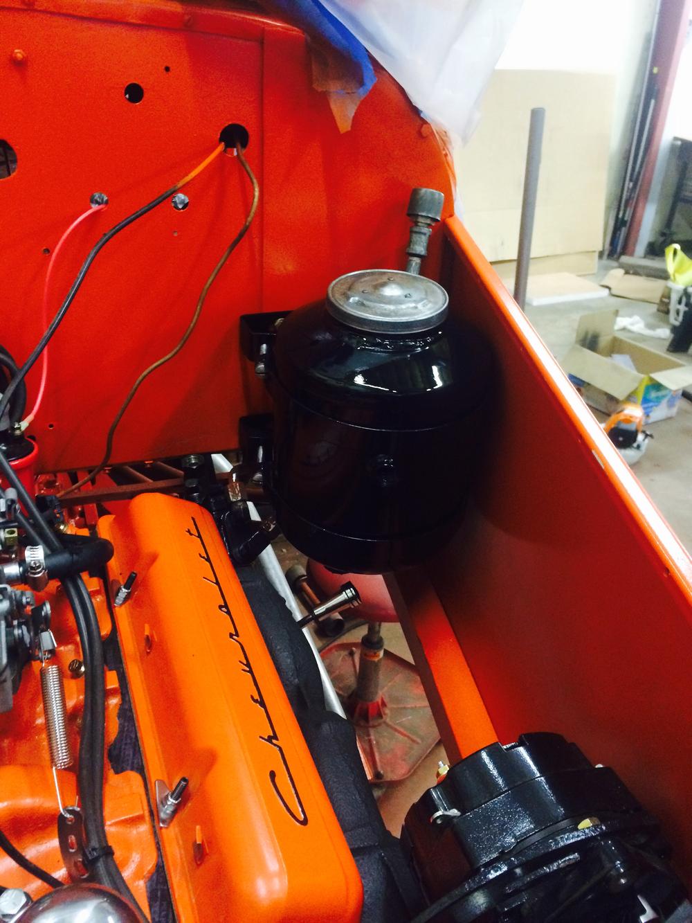

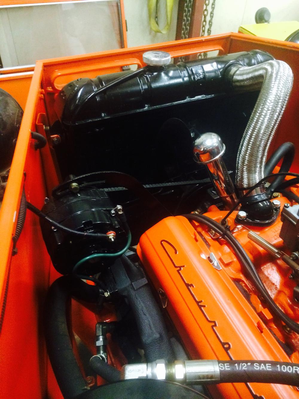

Do you have any problems running an open sided air filter? The engine compartment seems fairly open to snow thrown up and around by the tracks.
Cletis
Never had an issue with the open filter. Snow doesn't seem to get anywhere in there. The under hood temp is pretty warm and generally just the sides of the motor down low might have some water from snow dust.
Little electrical work. Set some wires on Fire with plasma cutter. Little char on the cat paint but will live. Put the powder maker together.

Wired up cleaned up. Positioned for pontoon and track install.
