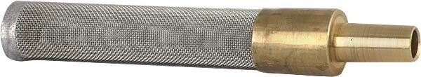

One thing I just remembered is the fuel tank if original has a shutoff on the bottom and they love to fill with rust and varnish one time on a cruise with one of mine I had to walk several miles because of this. get a gas tank filter (macs auto parts part number A9189FS made for a model A ) and better yet install a electric fuel shut off that opens when the key is turned on macs number A9190V12 that way if your float sticks open you don't fill your engine with gasoline.
Picture of the gas tank filter it goes in the tank above the shutoff
The screen is stainless steel I know without it on my model A it was a constant
Battle with it never have had a problem since it fits thru the 1/4NPT hole
It can be soldered in but it has a taper so it wedges in tight
