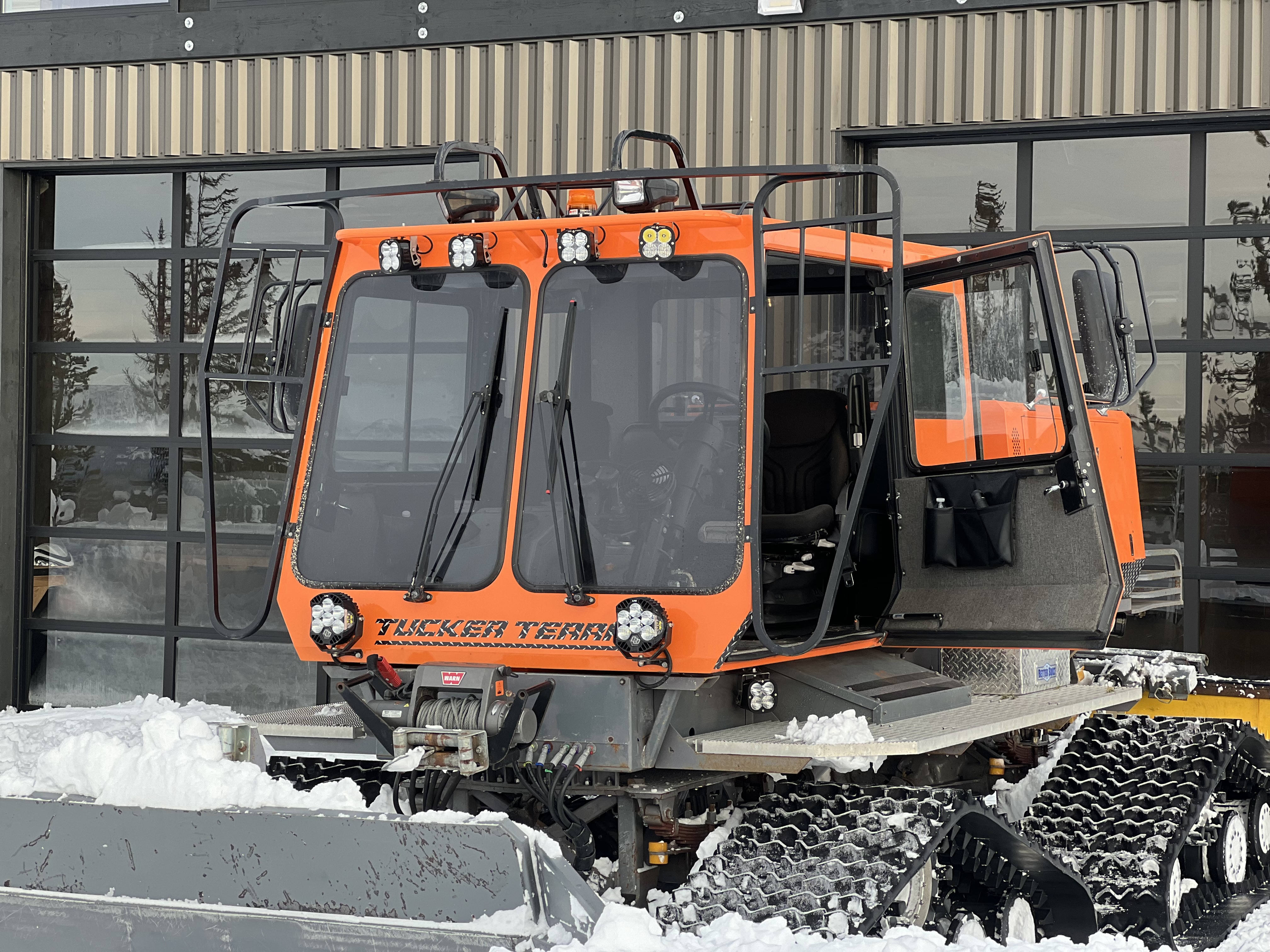

I bought a 2008 Tucker Terra last year to access our cabin and keep the road maintained! It has lockers and they are working great! (My problem and question is that when I’m trying to climb a steeper incline I get a bad ratchet noise coming front the tracks! I’ve confirmed that the track tension/sag is correct! Any idea what I’m missing? Thanks in advance!!!

Take you foot out of it.
Your over running the engagement abilities.
Snow packs and raises the track off the cog. They chew up quick so be mindful.
Sassy here, but absolutley no one agrees on track tension. Different snow calls for different set ups.
