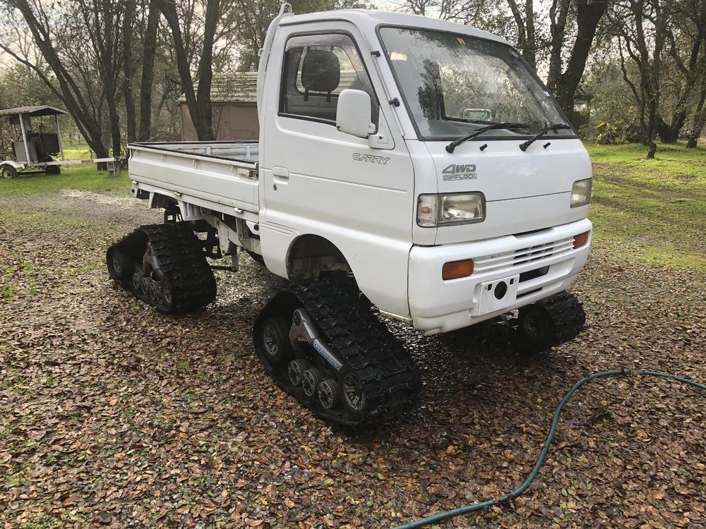

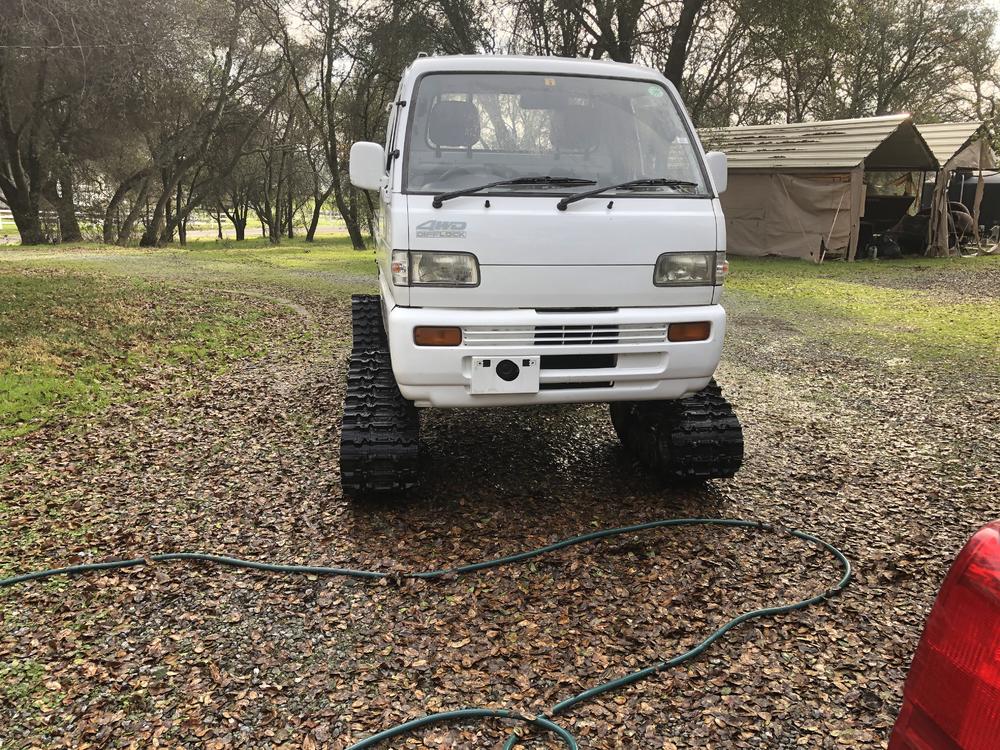

Suzuki mini truck on tracks
m1west
It Lives!

alryA
Some grooming guys tried them and they didn't do very well. Not enough ponies and many have manual trannies. So they'd be going up some hill and need to shift. I'm not a fan of camso either.
m1west
It seems to have a lot of power for what I am going to use it for. All of the mini trucks are not created equal. some do not have 4-low and lockers they have a granny low 1st gear and all the other gears are hi range ( I don't think that would be conducive to pulling heavy objects up and down hills, 1st. gear too low and the other gears too high ). Mine has 4-hi,4-lo and lockers. It is a cabin access machine not to be abused. As for the Camso tracks I got them on a trade deal. I have a question you said you don't like Camso tracks but every picture you have posted of tracks look to be Camso??I looked at the Soucy tracks they are very heavy around 140# each but look to be built well. Everything has its place and I'm sure the guys grooming would be happier with a snow cat rather than a quad but costs get in the way. I still have my Tucker if I find it won't do the steep and deep but right now I am optimistic. Marty

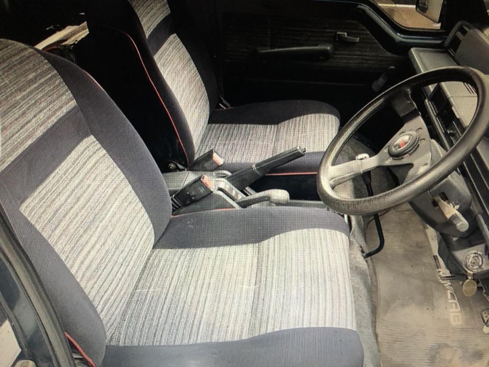

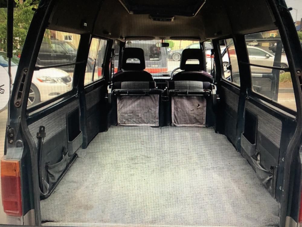

Hi all, I am thinking about another project. The same guy that I got the Suzuki mini truck from has a 1988 mittsubisi mini van, it has a supercharged engine 5 speed with hi and lo 4X4 just like the truck and I can get it for the same price $5k I was thinking of putting the tracks on the van for winter use as it.
1- is a van
2- has rear seats that fold up and down for passengers or cargo
3- even with the seats up there is a good sized cargo area and also luggage or gear can go up top.
It would just be more comfortable than the truck with the wife, dog in the front. it even has a large powered sun roof.
Then put tires on the Suzuki for summer use. Also later if another set of tracks come up for a reasonable price I could put them on the truck too. Opinions please. Marty
