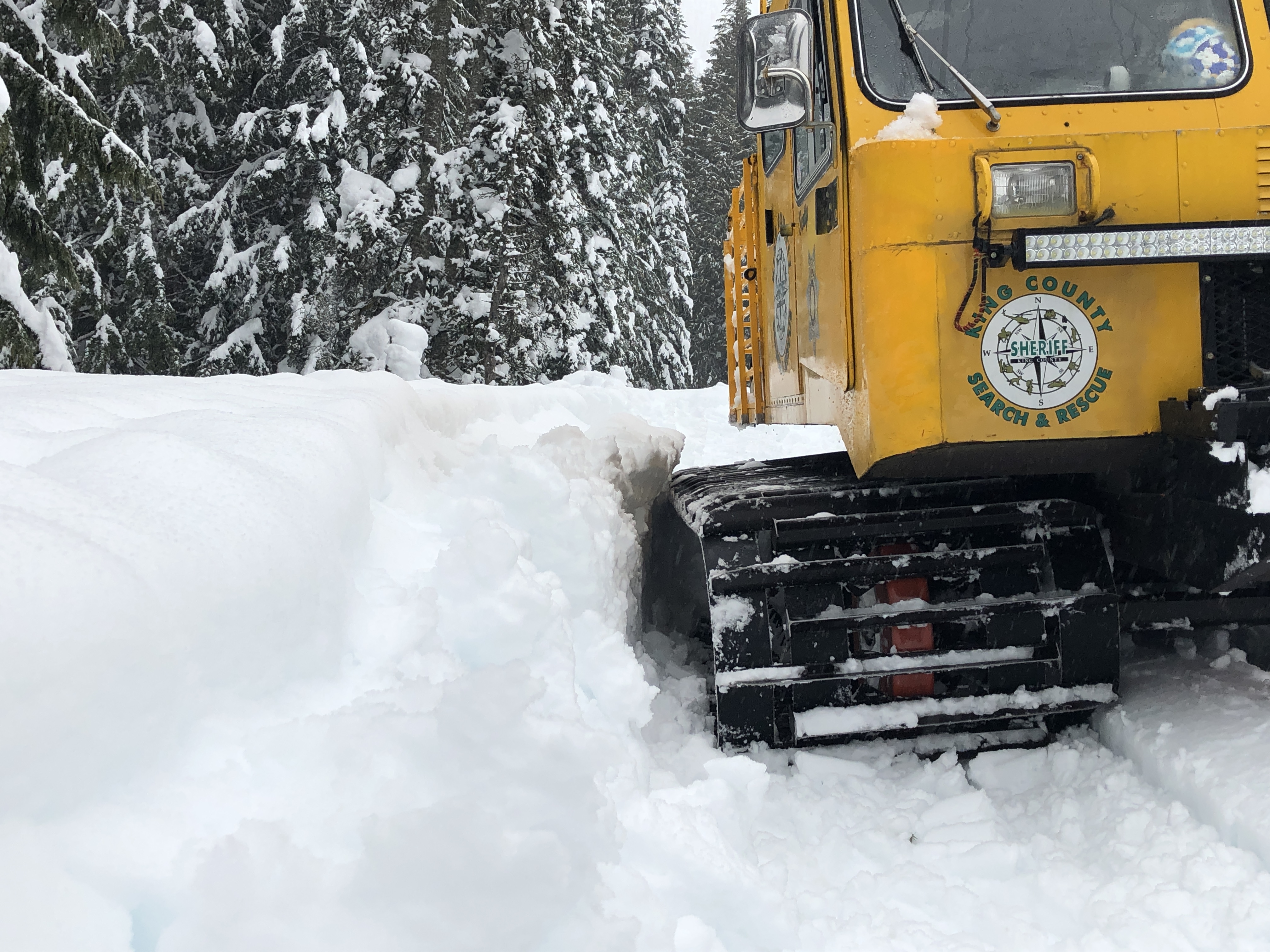

Sno-Surfer, that must be an LMC trait. Mine digs deep trenchs then stops moving. Luckily the transmission has a retreat mode and it got out.

PJL, it was interesting to me to see the side by side comparison between the LMC and the Tucker 500 series. The Tucker’s stayed on top of the snow and leaves a real nice smooth xc ski quality track behind them. The snow doesn’t get chewed up at all. But the LMC, even on flat ground leaves more of a tilled garden effect behind it and you wouldn’t want to use the track to ski in. With the LMC, if you’re doing any turning one track is already spinning and digging and if the snow is spring slush, it gets even harder to go up the hills. The LMC seems like a nice cat though but doesn’t come close to climbing like a Tucker 500 series.
I wish I had a blade on it but I don’t. But so far I’ve been able to go about anywhere. If it gets to be too much of a side hill I just turn and go straight up the hill. But sno drifter has the best set up on his with both a blade and packer/groomer/track setter. A blade makes a lot of friends in the search and rescue groups and his packer/groomer makes a lot of friends with the xc skiers, both groups we want to get along with.

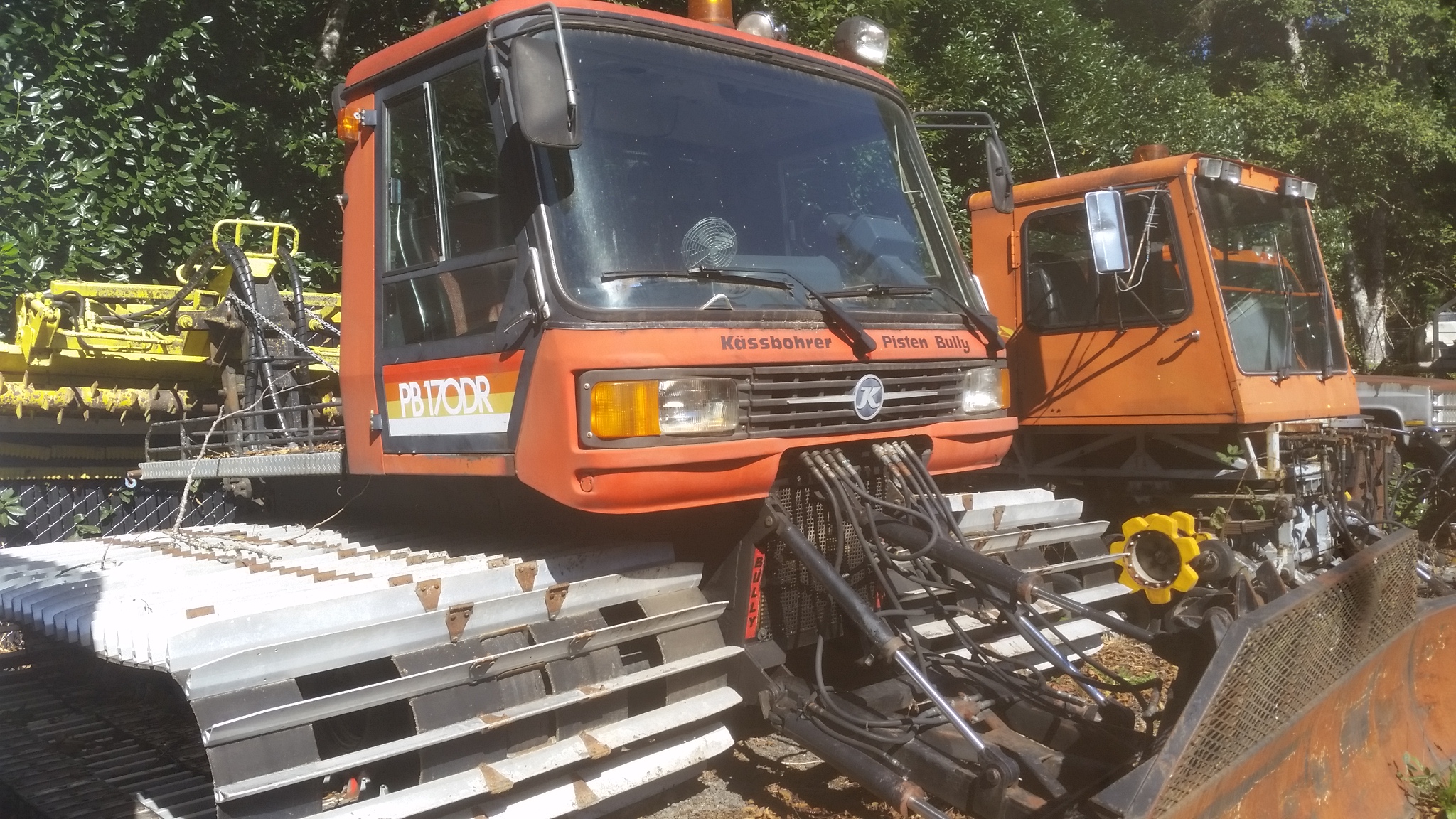

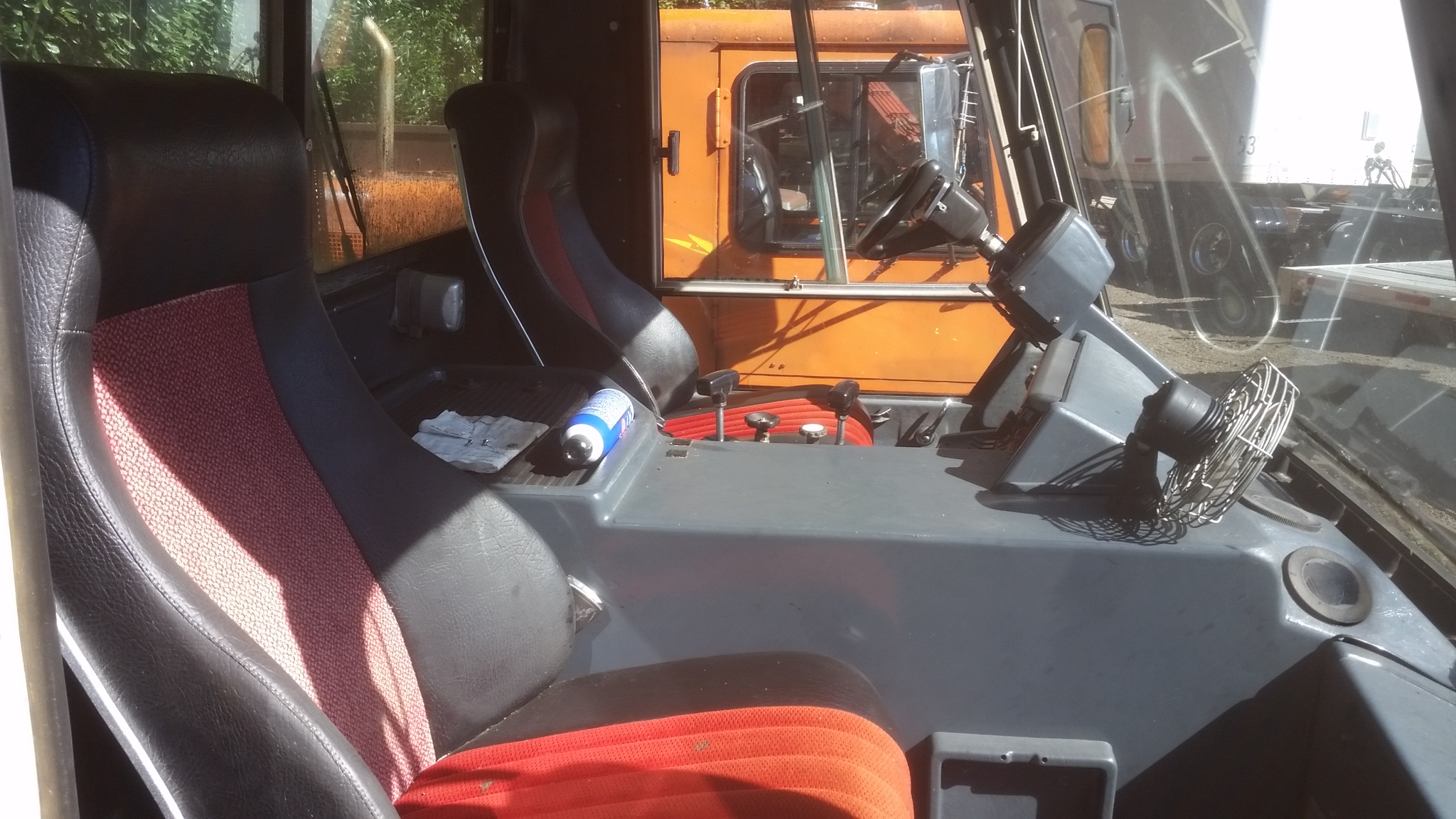

Hi HR,
I have a PB170DR Groomer that is in very good condition and would work quite well for you. See pics. It is too wide for my trails so, I want to sell it to someone like yourself who needs it and will appreciate it for what it can do. I am located in Washington State so I'm relatively close to you. I also know of a transport company that works with all the ski resorts in the Northwest who could assist you with transporting the machine. PB170DR Groomer.jpg20201006_PB Interior.jpgGive me a call.
