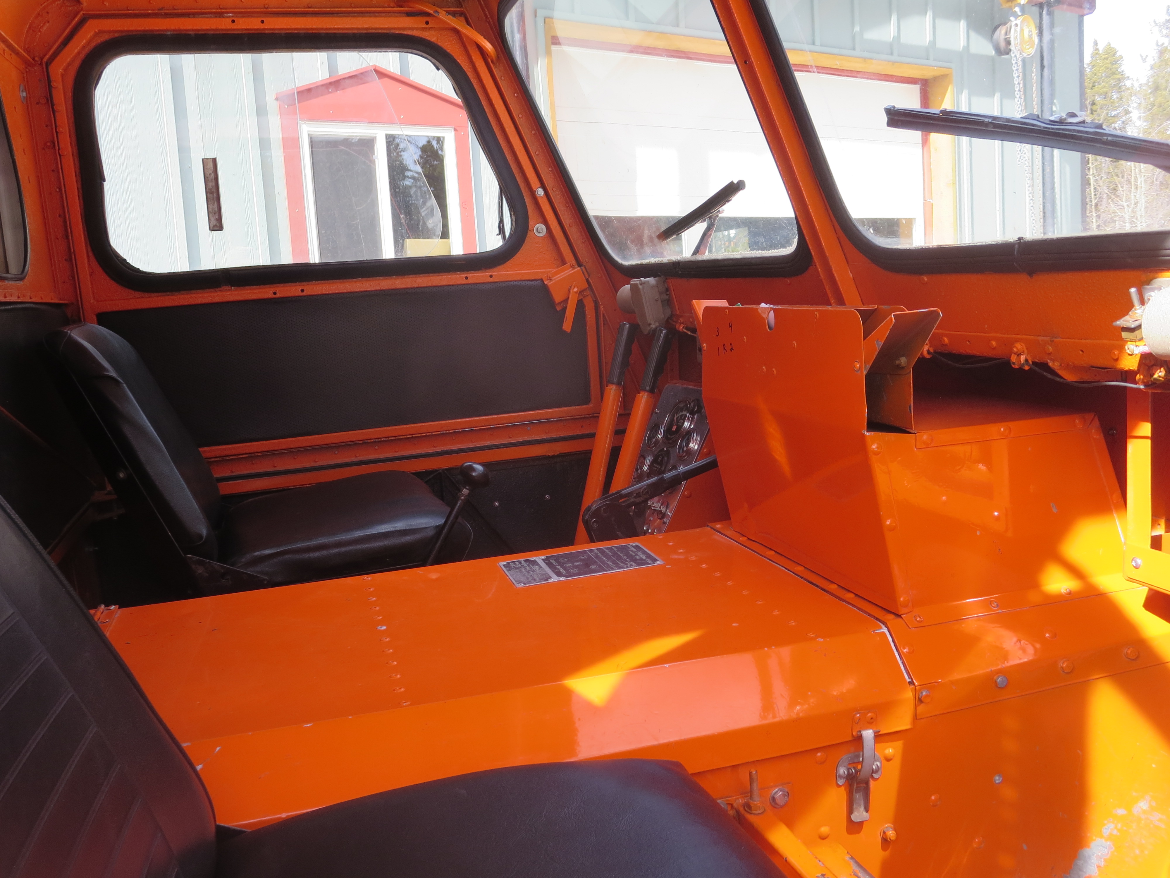

I have a 1202 B thiokol with some bucket seats. Big on the bolsters (?) and kinda a pain to get in and out of as well as not very forgiving while driving. I see in some of the cats they have some nice low back seats. I have looked around on the net and find those suckers are very expensive. anyone have ideas on where to get a reasonable priced set? The ones I see are $300 plus each. If Not, I guess I'll live with what I got. If you look closely, you can get an idea of what I currently have.

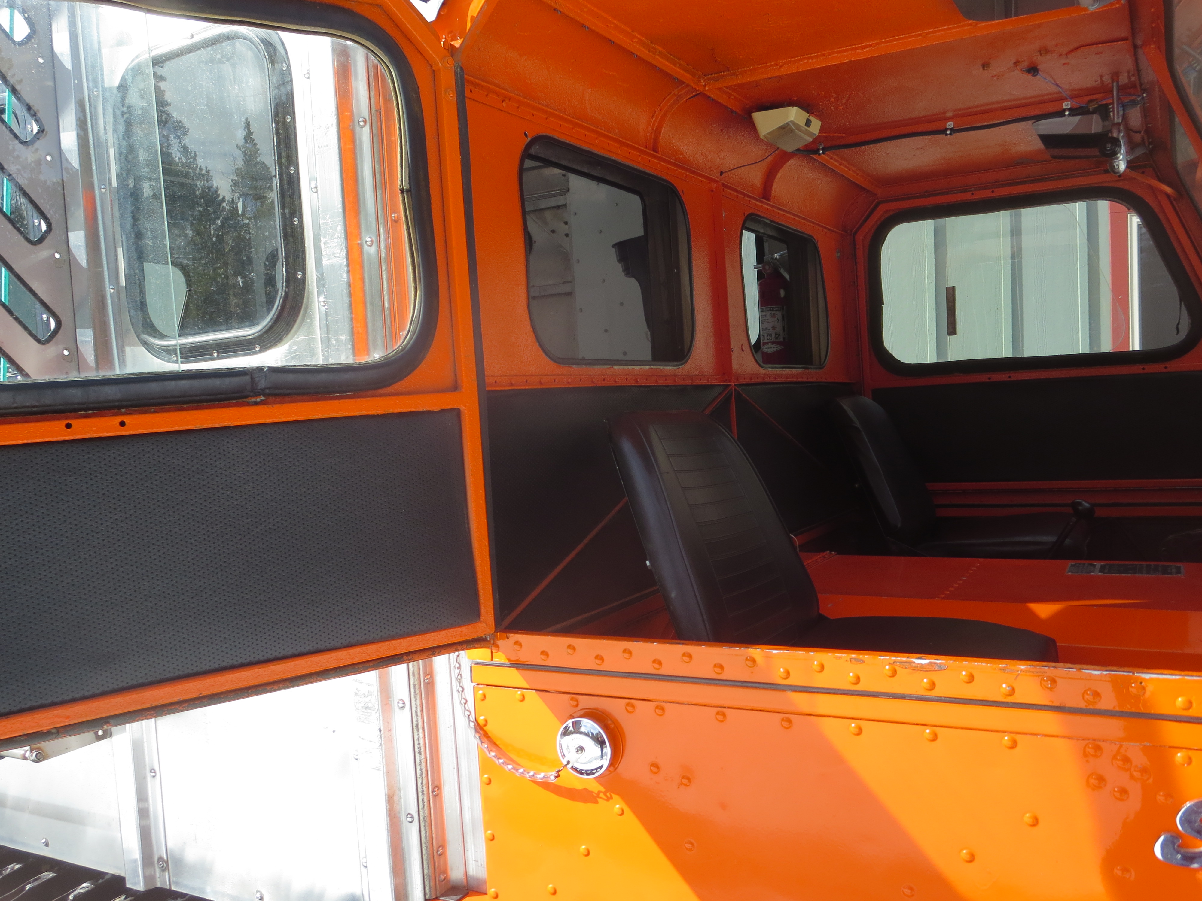

These came from Northern Tool. I have used seats from Four Wheel parts that were CJ-5 low back replacement that work very well. It is important to get the seat angle correct when fabricating the mounts. Re-used high back car seats are cheap and junkie looking to me.

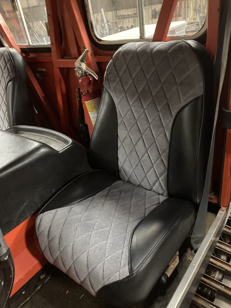

On our TUG project we decided to get the stock seats reupholstered, and chose a combination of cloth and vinyl for the new upholstery, with a diamond stitching pattern on the cloth. They turned out very nicely.

Thank you all! Great information and insight on the do's and don'ts with the seat options. My current seat bottom is reclined a bit which I do like as it gives support for the whole leg and keeps the butt from carrying all the weight. However the bolsters are large and do not allow me the ability to easily look backwards (no mirrors, yet!).
I checked all the suggestion provided and feel the Probax looks like a nice seat with considerable padding. Have not decided on cloth or vinyl. Probably go with vinyl as they are to easier to clean. If in the future I want the cloth, I'll hit my friend up for a swap. A day in the cat for making custom covers??? I do like the diamond stitching, looks great!

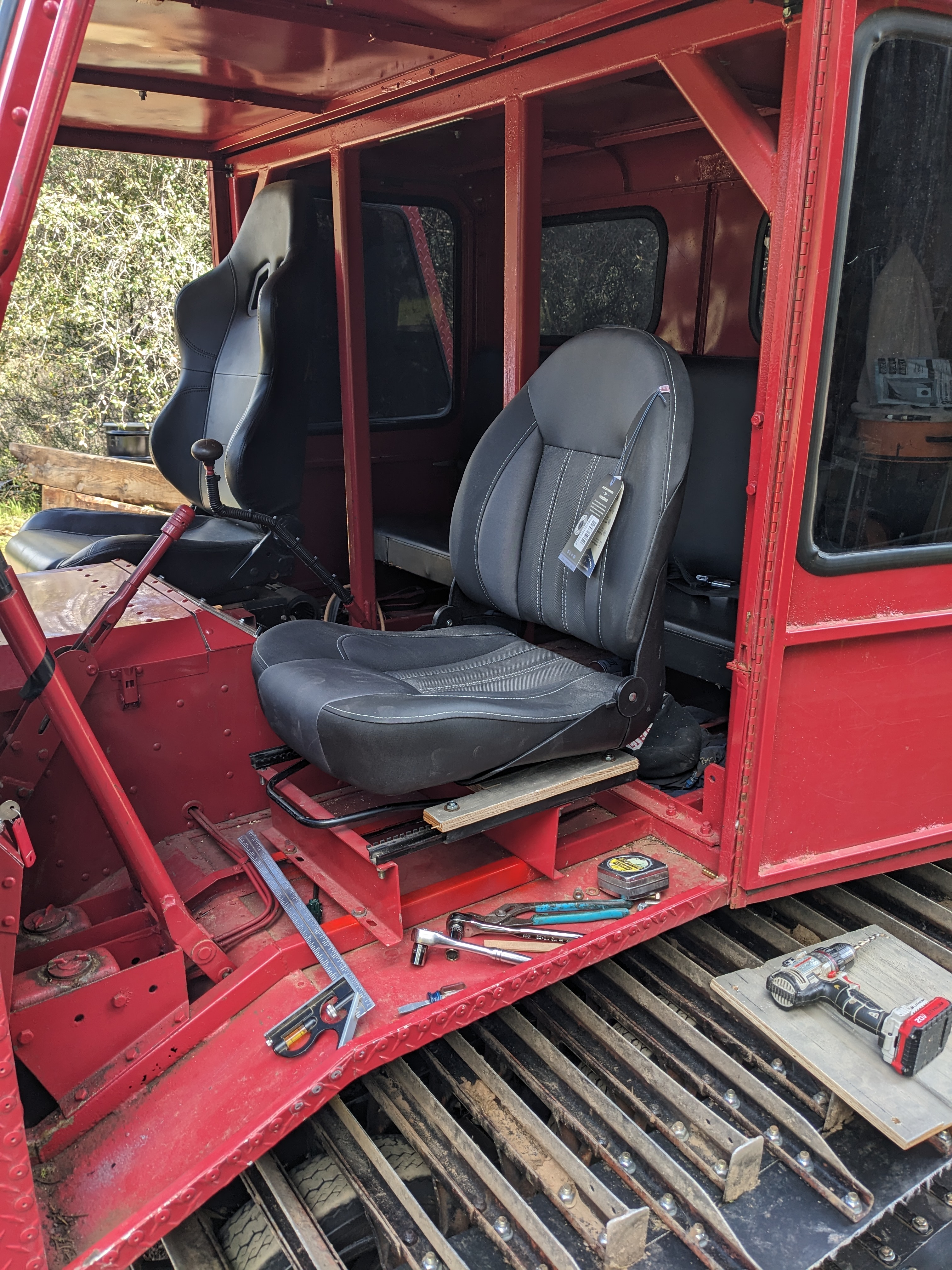

rockaukum
I pulled the wallet and got a seat for 200 as a trial. Had to retrofit some things but was able to reuse the track from he old seat. I think I will have to reconfigure the pedistal as my head is very close to the roof. I have yet to get it out on the snow to see for sure. Thanks for the insights and help!
