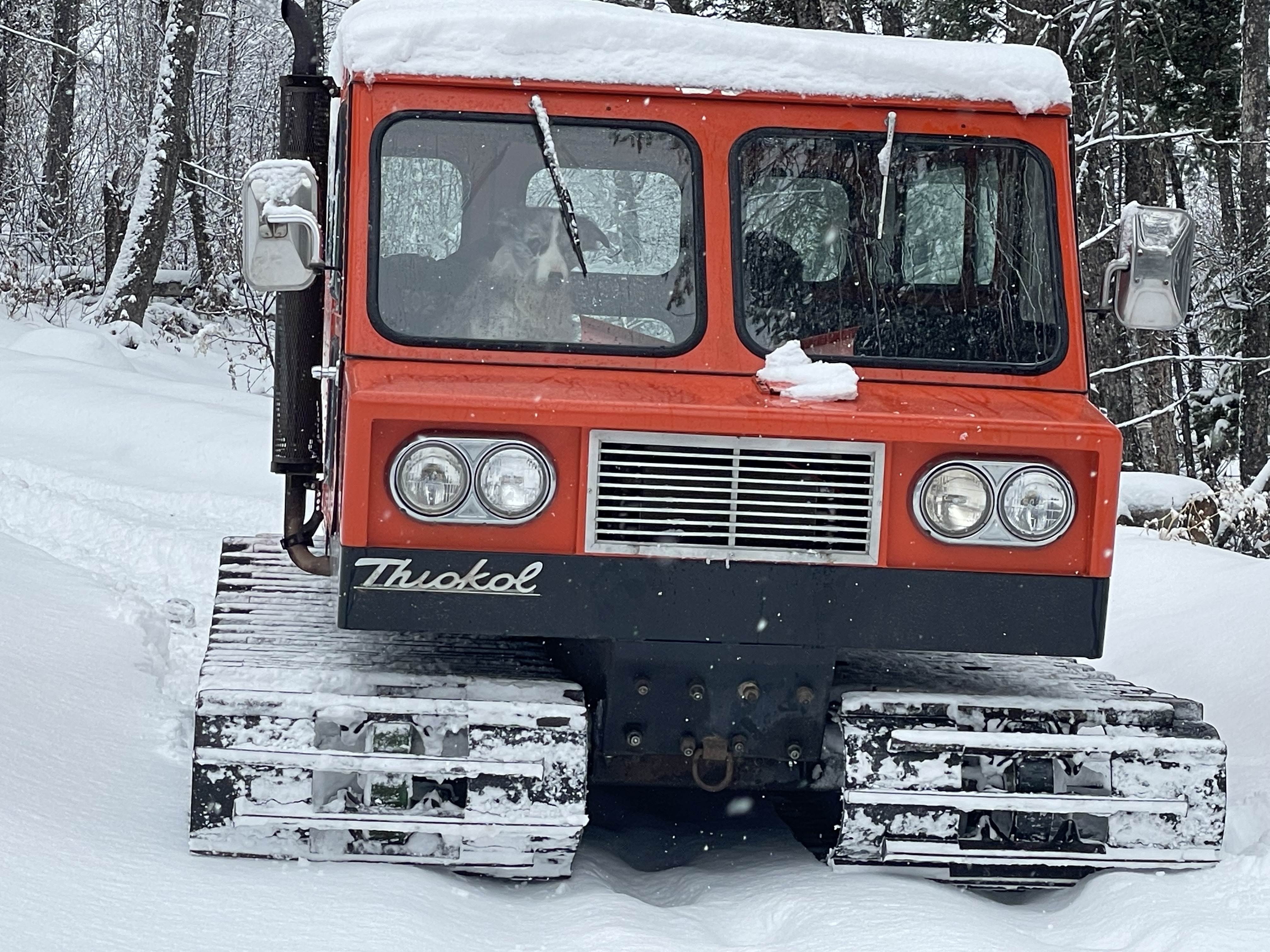

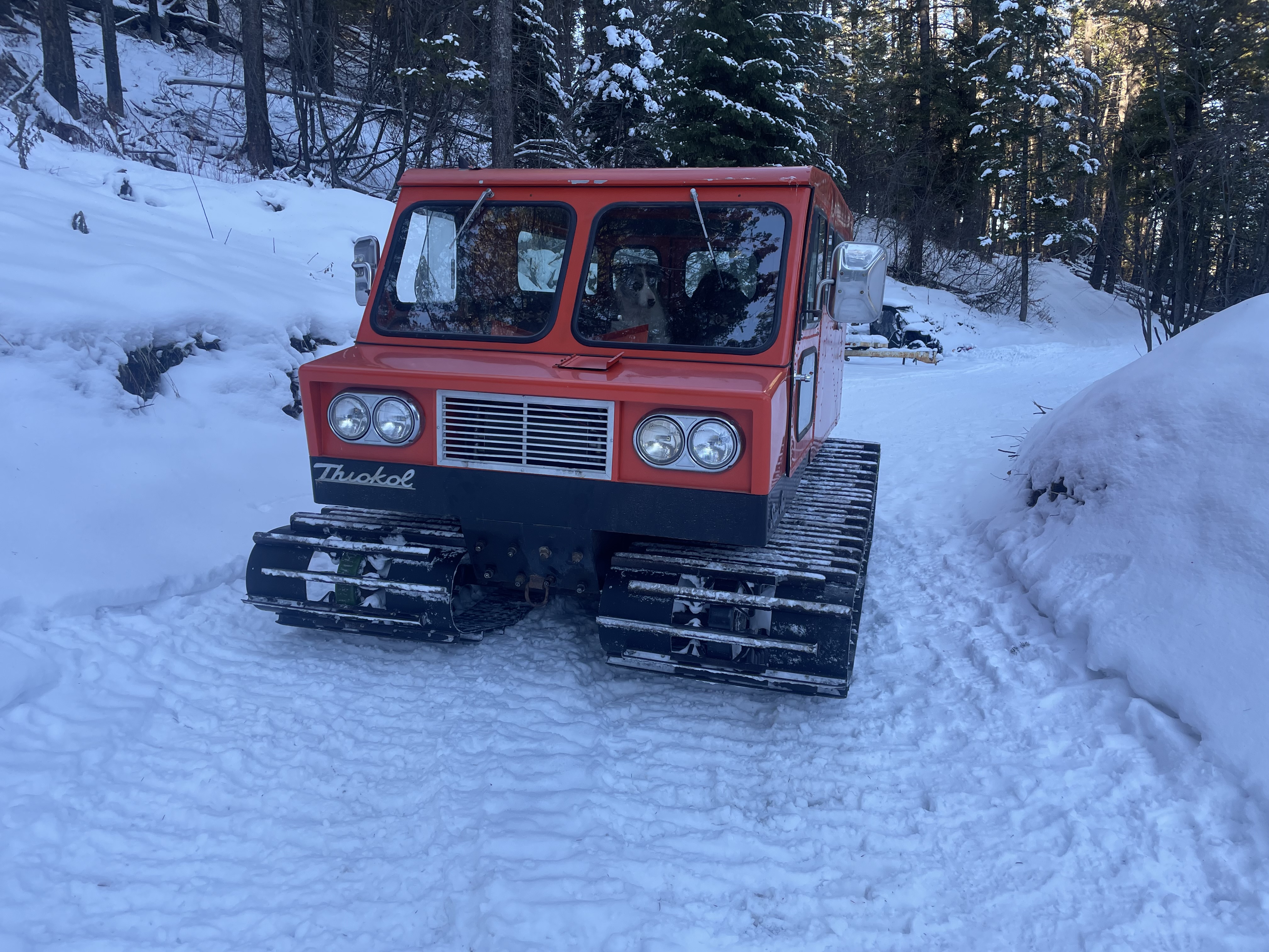

As I said, everything seems tight and right. However, I’m getting a pretty serious vibration/shaking upon acceleration. Vibrating enough to cause my plug wires to vibrate off my distributor cap lol. Noticed that the guides were hanging pretty low with the new belts breaking in, and they were hitting the support bars for the leaf springs, did a track adjustment, tightened it up, everything clears now, was expecting that the vibrations would go away.
No.
Next thought was U-joints/drive shaft. Checks all the boxes for the symptoms. Pulled the drive shaft, took it to the shop for U/joints, rebuild and balancing. Installed it, expecting a dramatic improvement in the ride. Better, but it still will rattle your fillings loose on acceleration.
I realize that this is a steel box on a steel frame on tracks and it’s not going to ride like a Cadillac. I also realize that my driveway is a hard pack cat trail currently without recent snow, this obv affects the ride, but interested to hear everyone’s experience with the noise and vibrations in regards to normal operation? Am I chasing my tail, it is what it is, or is there possibly something not right…..?
Appreciate any input from the Cat whisperers.

Thanks for the reply, please elaborate on “other drive components”
It seems to be the drivers side mostly, and seems to originate there, makes me think it’s track related, the entire wall shakes, the door rattles, the gas tanked is mounted inside on that side and shakes also, maybe that’s what’s making all the racket, will look at its mounting tomorrow, really thought the rebuilt driveshaft would solve the problem, checks all the boxes for symptoms, maybe making something out of nothing. It’s basically a tank. Not sure what my baseline for performance is with no experience. Just want to be sure I’m not damaging something.
