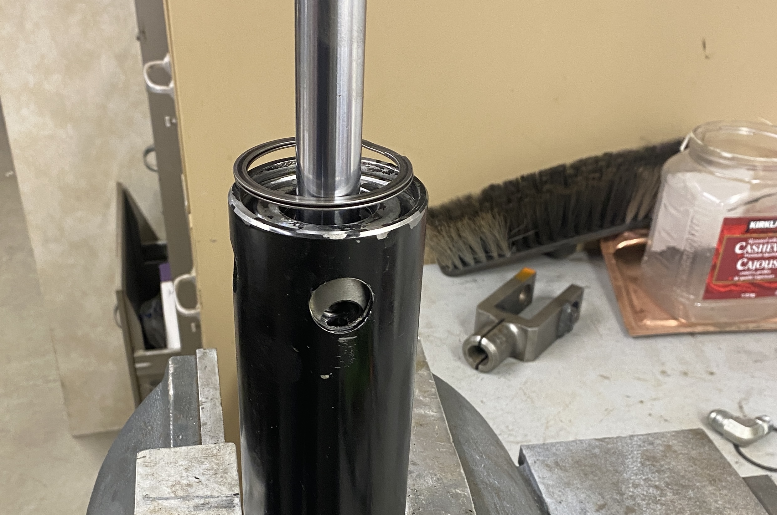

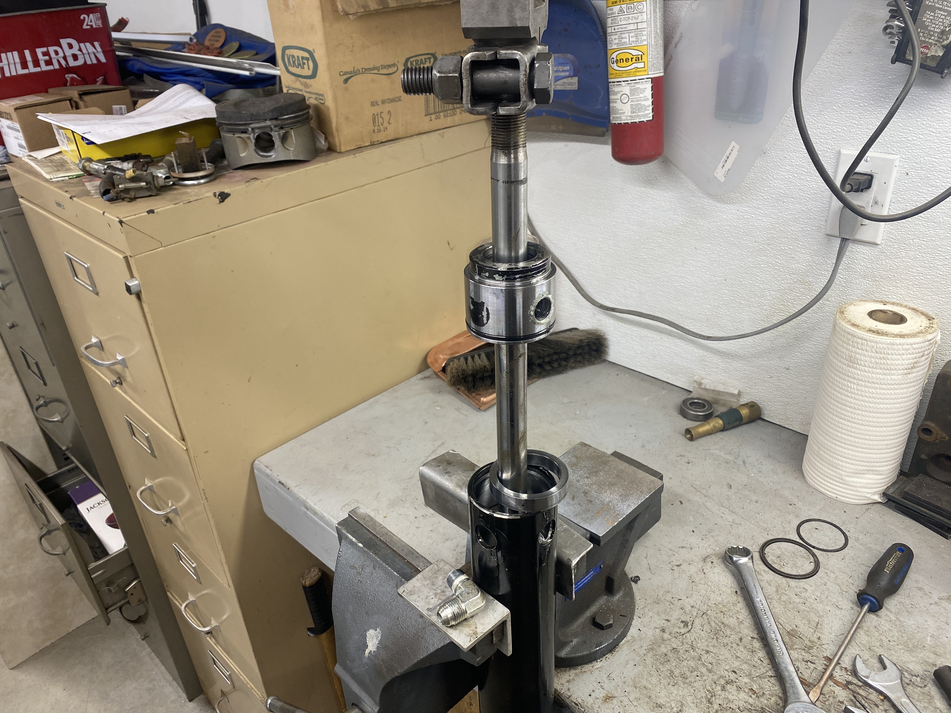

That brand new steering Ram from Tucker started a slow leak. So I took the ram apart.
The ram is a little different than the rest of the rams as the end where the rod moves through virtually floats a little bit between the two lock rings.
The advantage I guess is you can use either of the ports in the cylinder for the end fitting.
The bore seal is a single O ring so it doesn’t have a lip seal style.
I guess it works, so all I could do was replace the O ring. The original O ring did have suspect areas, so had to try something.
It hasn’t leaked so far, might get out this weekend.

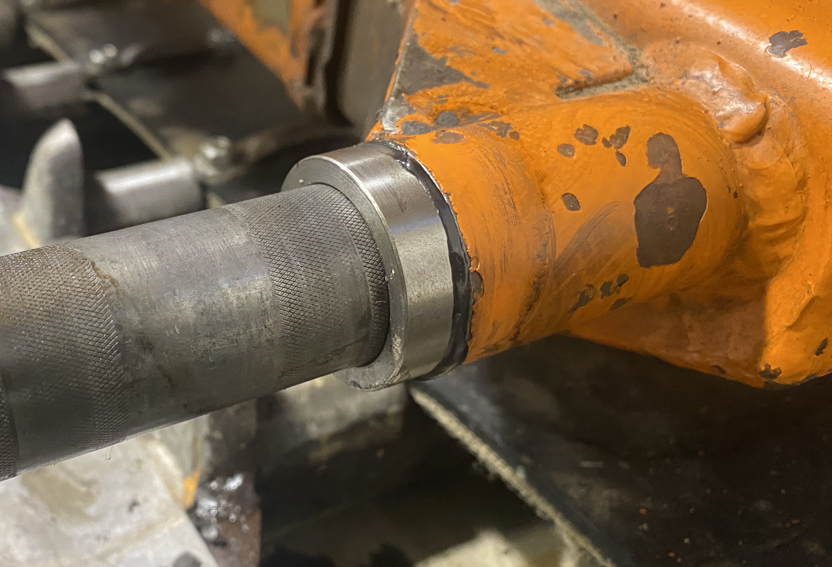

Wondering if anyone has tried Bearing Buddy’s for the idler wheels?
Looks like they should work same as trailer applications, and address the same problems we have with expanding and contracting and keeping grease in the bearings. Not cheap but cheaper than doing bearing, race and seals.
They also sell a stainless slip race for the inside seal that makes sense and might stop the seal from grabbing the steel sleeve on the stub shaft.
YamaDooPolCat
Part number 2441. Which happens to be the diameter. The seal is .2437” so the fit is excellent.
Going to look for thick washers 1 1/4 opening by 1 3/4” wide and that will do away with the outboard slip on race.

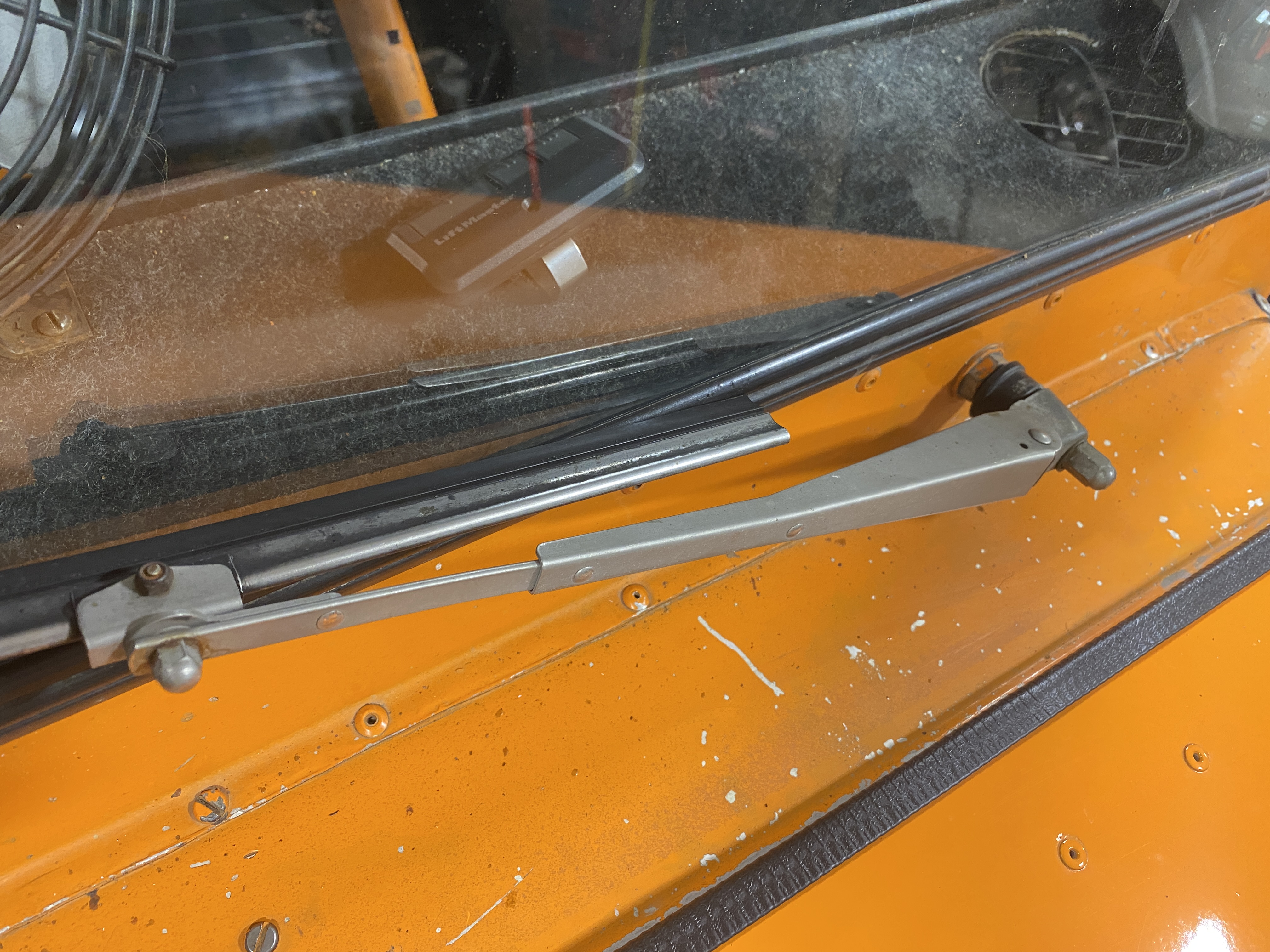

The windshield wipers are crap. Might be original 1975 wipers.
I am wondering what people have tried and worked or didn’t work
for replacements?
The length is 13”.
YamaDooPolCat
One solution would be to unrivet the end of the arm and find a J hook arm to rivet in place of the straight end.
Then there are lots of wiper blade choices.
YamaDooPolCat
Found replacements at auto parts store.
It is Trico #61-130
Bolted these on. Won’t know if they are any better until we get some precipitation.

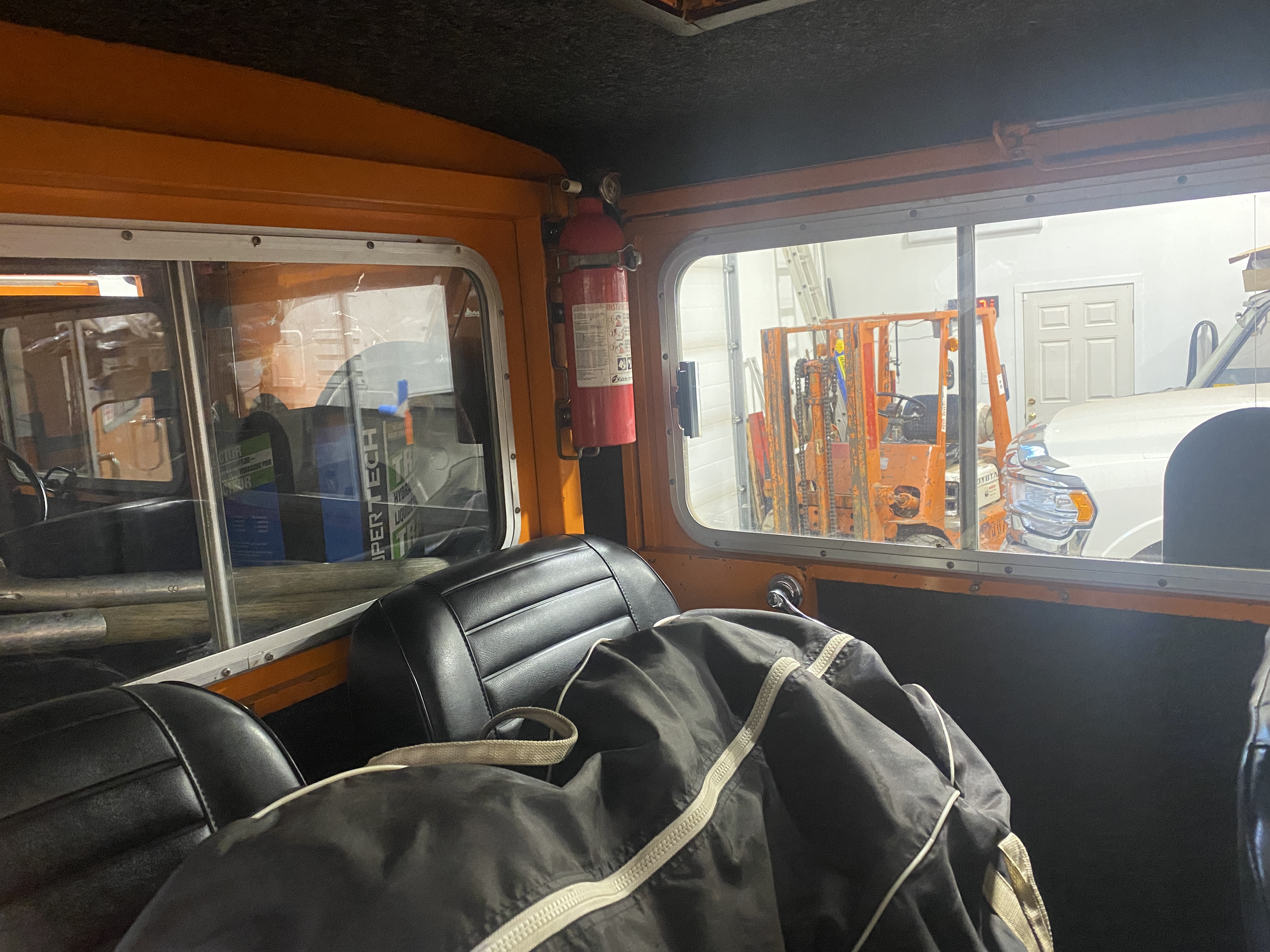

Got tired of the fire extinguisher rolling around behind the seat. This about the best I could come up with.
Different cab configurations probably offer other solutions.

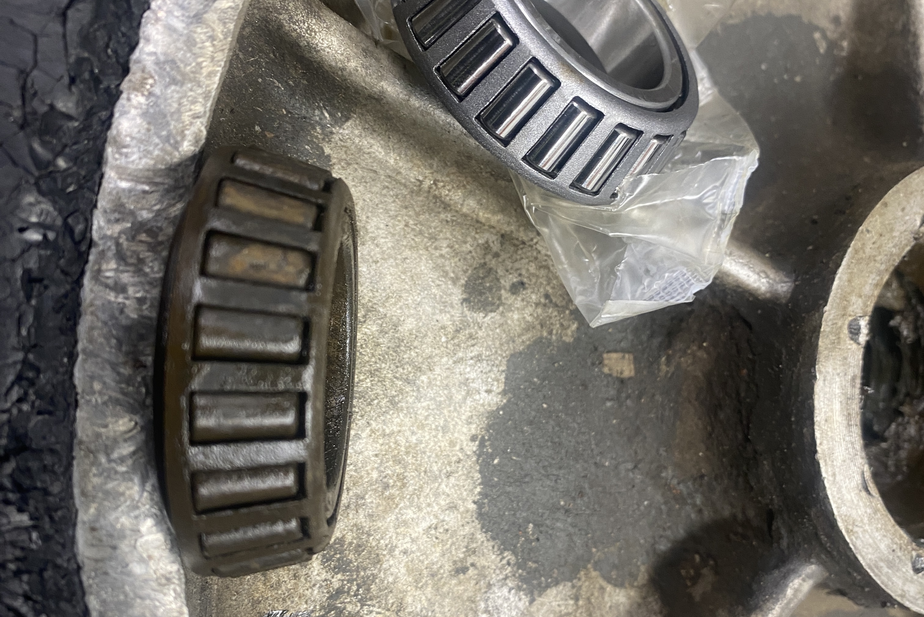

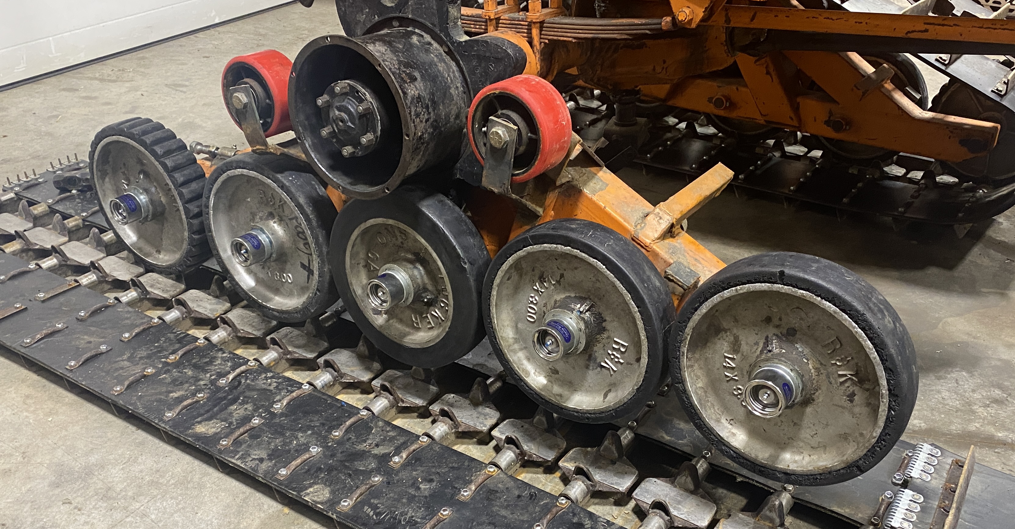

I started with install of the Buddy Bearing caps. I thought the Buddy’s were a little expensive until I started pulling off idlers. All the new bearings I put in last year are shot.
YamaDooPolCat
Thanks for the suggestion on using a flat piece of steel and a large hammer. I only wrecked one seal so far. I didn’t have the seal set correctly that time.
YamaDooPolCat
That’s all I could do for now until I get more bearings. I think the rest will be junk as well.
YamaDooPolCat

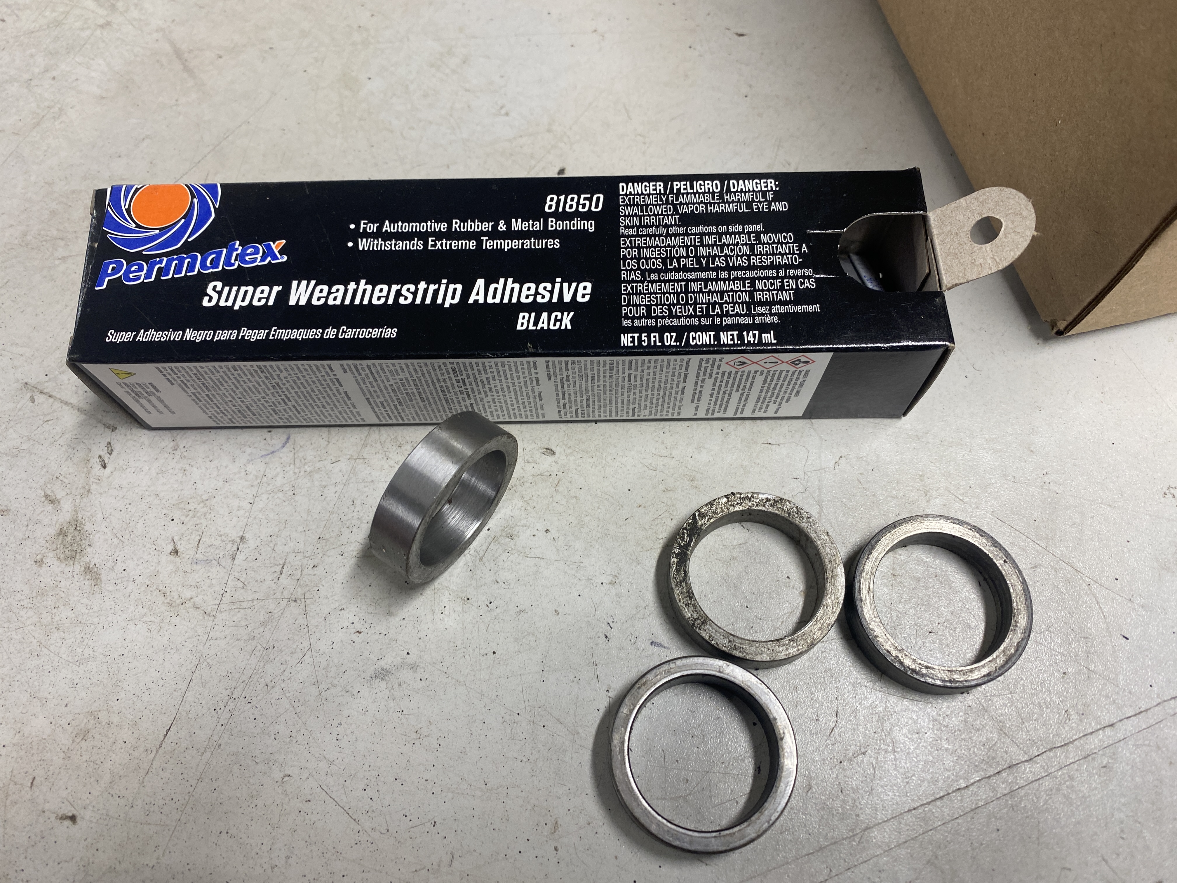

The seals seem to be okay so the water has to be going under the races the seals ride on.
Now the only race that sees air and water is the one closest to the track frame. Since that might be a problem I glued the races to the spindle with windshield urethane.

Couple of points to consider. Bearings in use get warm. warm causes expansion of what's inside. on shutdown they start to cool off, causing contraction of what's inside. Snow packed around the hub is melting and that contraction will suck in outside atmosphere, which is laden with the moisture of the melting snow. which then condenses. Doing communication work, we used hot melt adhesive, special bonding tapes etc, and the only certain way to keep the waveguide dry was a positive pressure of dry air / nitrogen /sulfur hexafluoride. There will be no way a rotating seal on a bearing will resist the effect. The springloaded bearing buddy is a great option as it will keep a constant pressure of grease. but it will need to be watched and kept full. I run double lipped seals on my bogies, and still expel water when I regrease at the end of a run.
Wrench9
The newer races that the seal rides on come with a grove cut in them and an O ring to seal them to the shaft. If you have access to a lathe a grove can be cut in your origionals and an o ring installed to seal them up
YamaDooPolCat
I have couple of those installed somewhere. I’m resigned to pulling everything apart so we’ll see what those look like when I find ‘em.
Hopefully the Urethane glue has enough flex to seal, plus a little pressure from the Buddy bearing might get some life out of these bearings.
Still no snow so I am happy to wrench until we get snow. In our neighborhood if you want it to rain you dig a hole. I you want it too snow take your snow machine apart and order parts.
Wrench9
Were they all equally bad. We recently pulled apart my sons 1970 to redo the rear slides etc and suprisingly enough all his bearings were still good.
