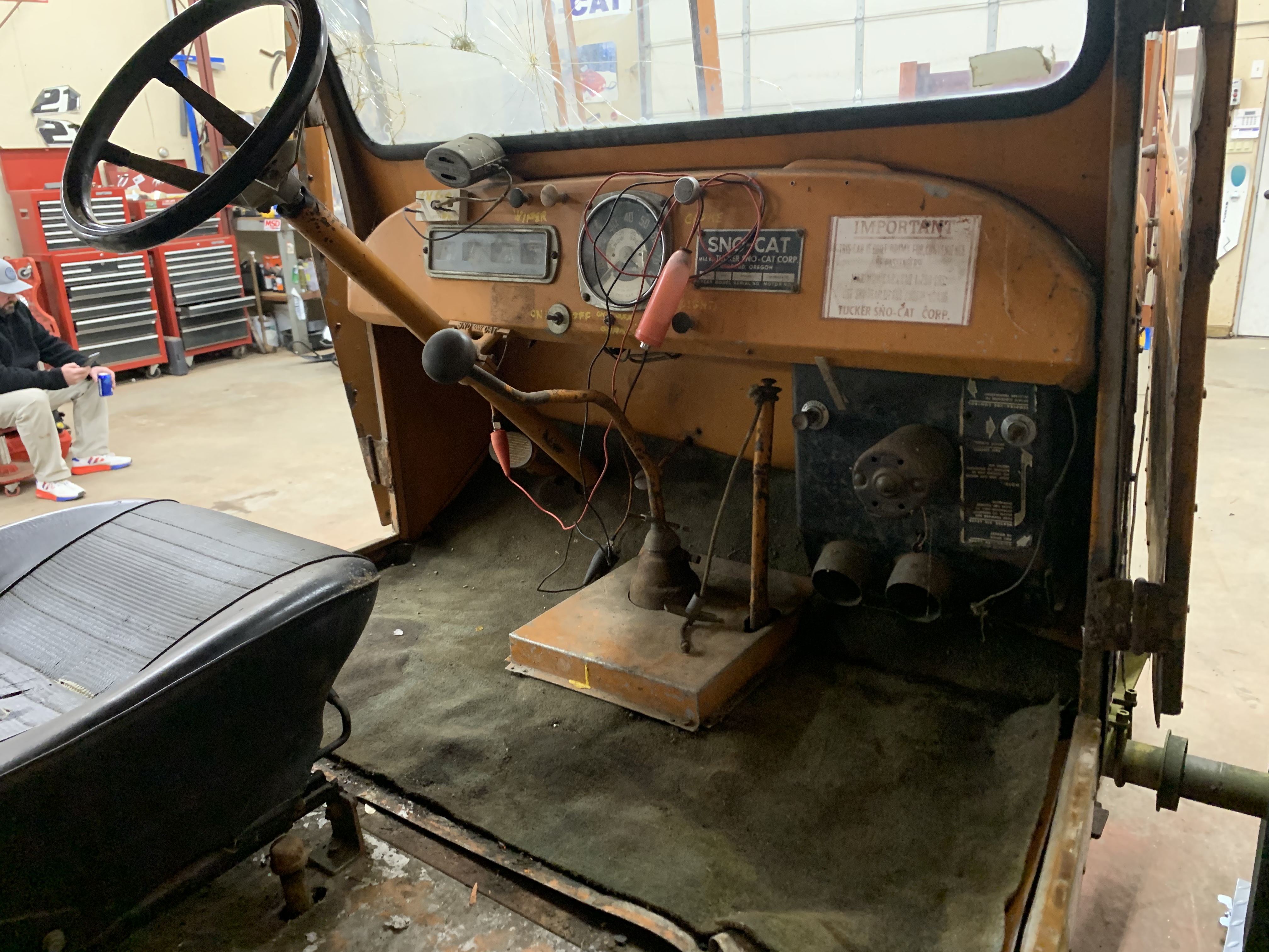

Moved the cat into position. Boys did a great job vacuuming it all out.Next steps are to remove everything that doesn't belong on the cat and assess.
I put it on some car dollys so we can move it around as needed.
Motor hasn't run in a few years so will get it fired back up.
As much abuse as this cat has seen it is amazing the tie rods and still straight.
Curious heater and it looks like the front would have had a bench seat.

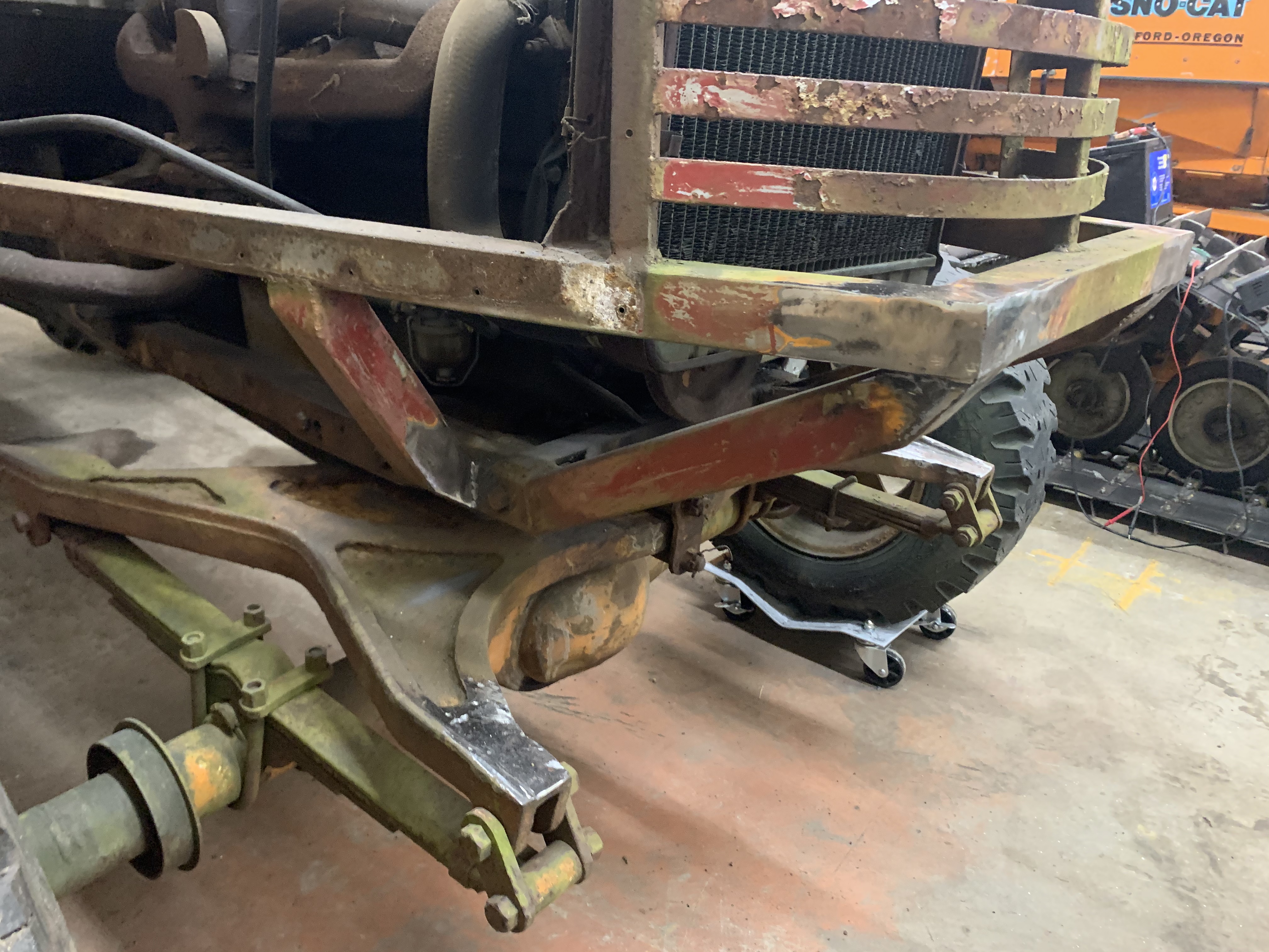

Put some time in today. Used some plasma infusion to remove the frame added on in life while careful not to damage the underlying frame. Machine is pretty solid but It will need some patching and filling.
Lost the step added as well.
