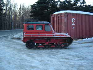

Welcome to the proud crowd! You will love your toy and soon you will be looking for another, no worries tell your wife its a sickness!LOL!! Have fun !!!
I have attached a small move to make it even harder to wait and a picture for a future use!! Have a blast!! Keep us all posted!

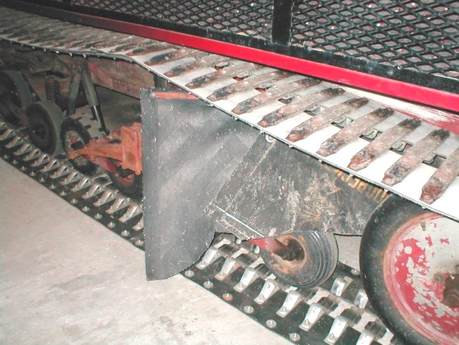

I have a question on the new rig. It is in excellent condition and everything is there except the snow thrower flaps. Did these snow trac always have them? How important are they? Being at 10,000 ft above sea level the snow here is mainly very light and dry until the spring thaw.
Does anyone know where I could get a set or how to fabricate them?

Lyndon had sent me some stuff on them along with others i will go back and look some time today but mu understanding is that mudflap material works the best its just a deflector to keep snow from packing on the track where it could over tighten the track and snap the ears on the axle housingsor cause you to walk out of a track. with the 2 band track the problem dosn't seam as much of a factor as it is for the newer 3 band track i still plan to add some to mine before spring but at 25 below the only thing sticking to mu tracks are some kids toung . or overflow wich i avoid like the plauge.

Ask and you shall receive !

i like Big AL's solution also take a look at snow trac repair 101 for other solutions i have thought about hdpe because i also run mine in the summer and i worry about rocks getting traped in the guides but will likely use rubber i has always worked fine why re invent the wheel.

hello, Just attached a parts diagram to assist in the fabrication.
I need to make a set too... I didnt realize that the snow /ice can freeze on the rear wheel axle and actually break the axle. This happens to ATVs all the time.
Notes from the previous owner of my ST stated that they ALWAYS removed the snow they could prior to sitting it overnight. It looks like good old truck flaps would work and some angle steel.
