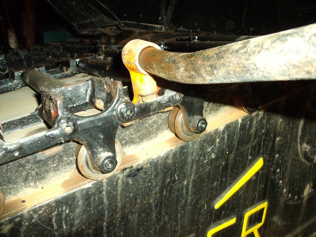

OK Looked Somemore
Even after seeing a terrible b&w picture in an old manual, that is not what I expected it to be like.
What is keeping the two bottom 'hooks' from sliding out when the bolt is leveraging down in the center of the link? It seems like the gripper section would be slipping toward the center of the track and thus forcing the link sideways instead of straight down. Obviously it works, just not how I thought it would.:ermm:
I do not understand the use of both fine and course threaded bolts unless that was all that was on hand when the tool was fabricated. I do think that there are 2 so that the inner and outer links can be bent while standing along side the track with the ability to reach under the body. The tool pictured needs to be rotated 90 degrees to engage the "pins". This is not my tool-just a picture I picked up a few years ago. I can not get it thru my head how it bends the link the "hard way" or in a vertical plane and not just roll the track over.
I have the pleasure of meeting another member last night and he brought his tool which is similar to this one. You bend the links down and they bend real easy. Just like the picture with the yellow one above.
