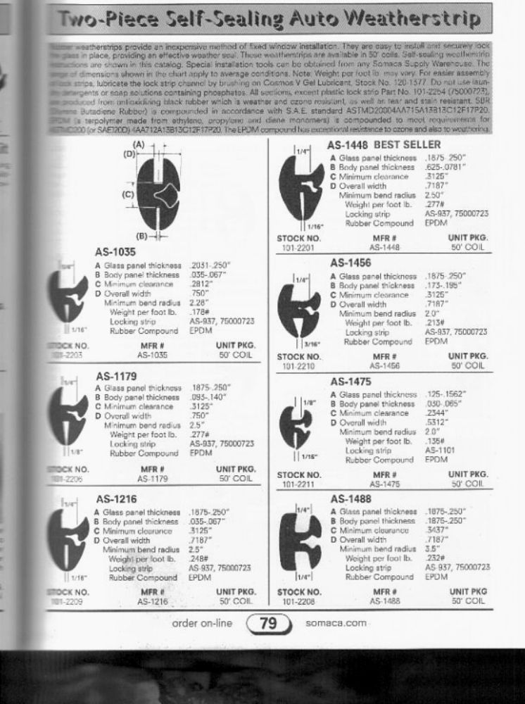

what do i need for the other windows? would it be the product on the lower left of that picture, part# 184-4121? ill need to do all the windows in the cat.
The molding on the lower left (4121) is what you need for your slider windows ALONG WITH glass run channel 103-2174 spacer rubber 104-4122 and rigid channel 103-2066. What you need for your other windows is a glass thickness of .25 & panel thickness of about .625 two piece window weather strip.

It turns out that the company I bought it from offers 2 different widths and I failed to find the wider type..... Could be because they don't show that dimension in thier drawing but list it farther down the page :rolleyes: :bonk:
