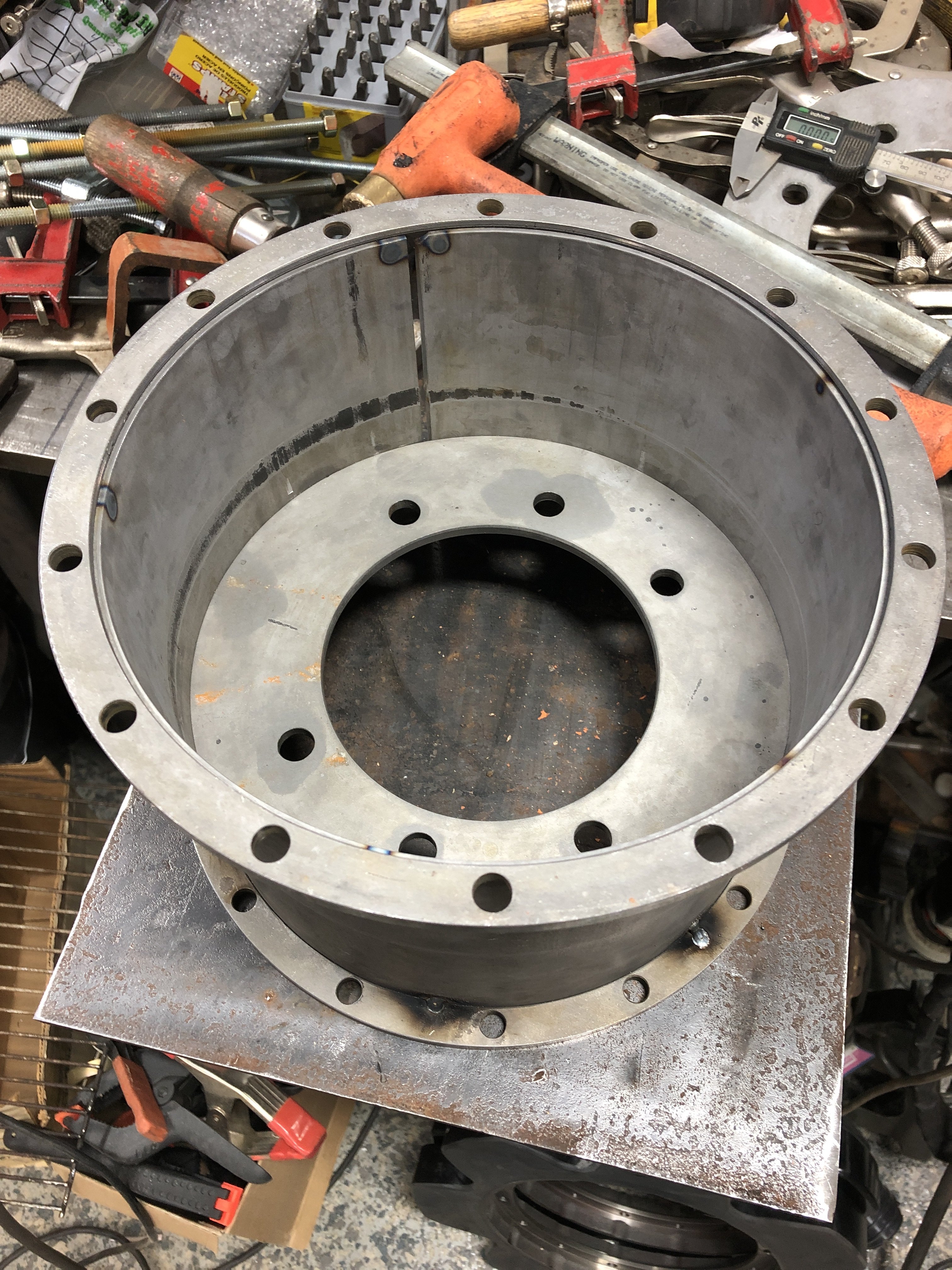

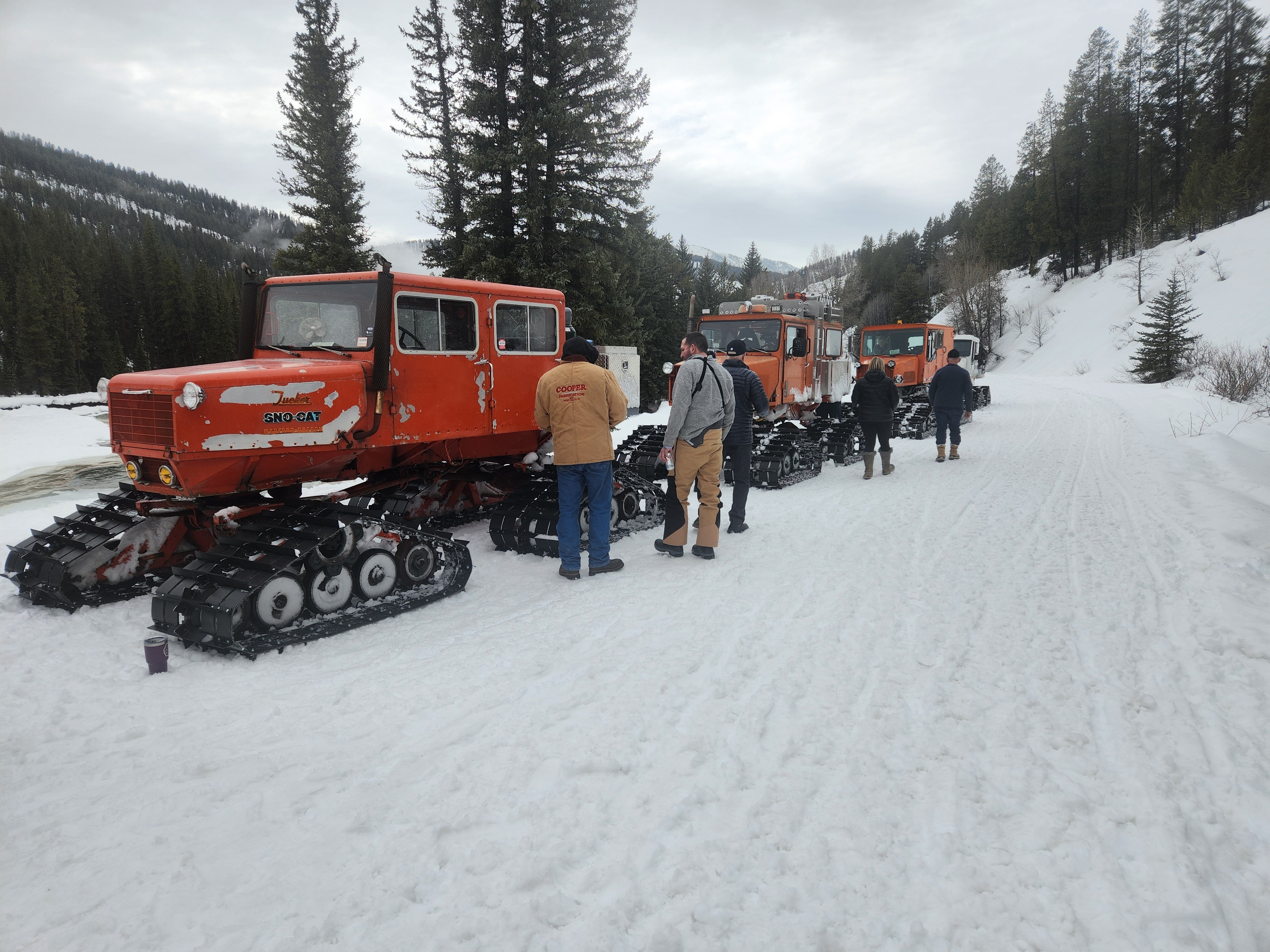

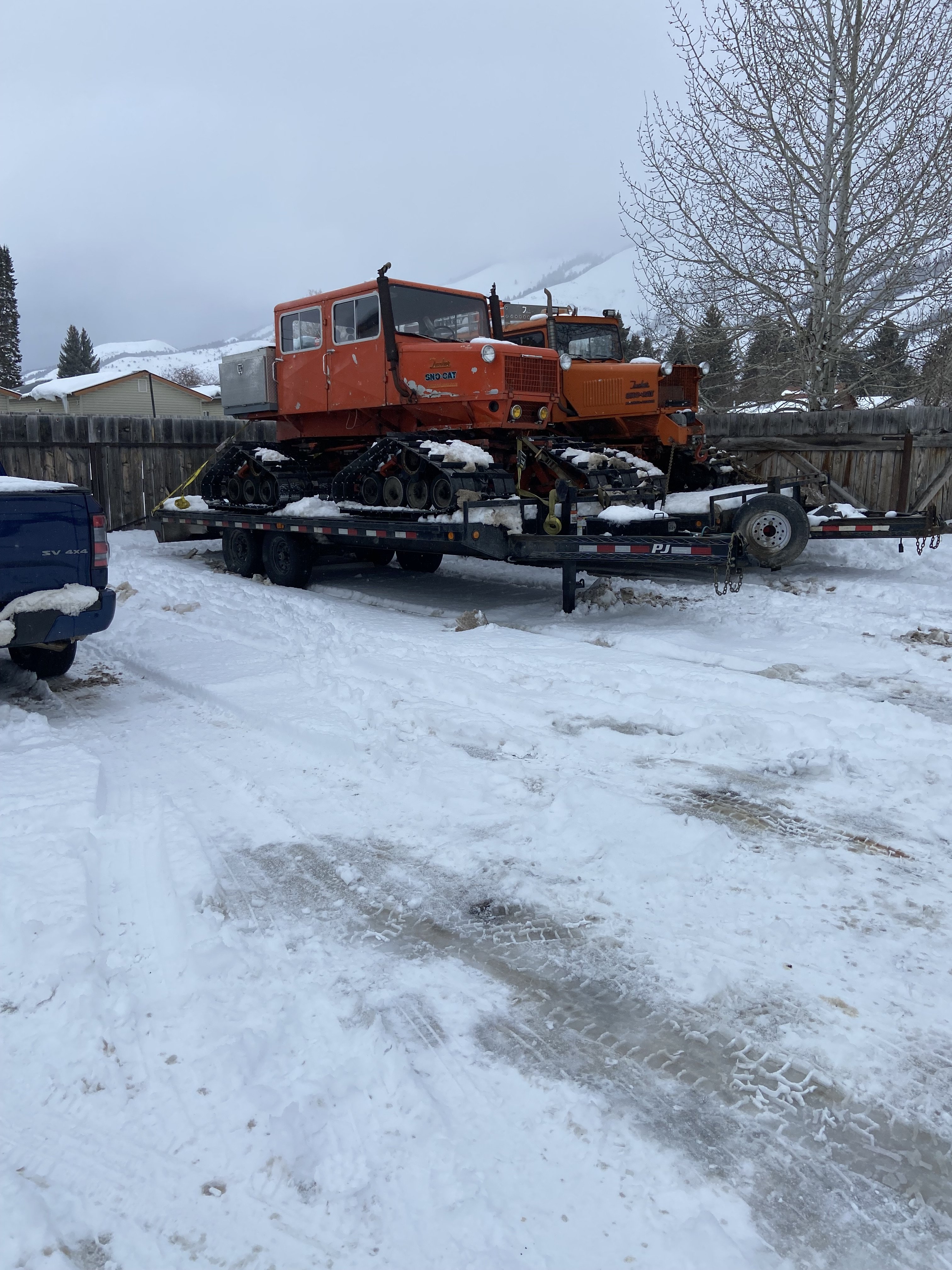

Sadly, we had to bail early on Monday. Just after leaving the trailhead I heard a noise. It was not a good noise, though it’s one we’ve heard before.
We went back to the parking area and confirmed there were some loose drive sprocket to sprocket drum bolts. The outer sprocket bolts can be accessed, but the inner sprocket bolts are another story.
If those bolts are loose, you can destroy a sprocket drum. I don’t know what Tucker charges for a new sprocket drum, but last time around I looked for a used one and the only price I got was $550. Ouch!
There really isn’t that much to them, so The Gorilla and I investigated making one. He used his CAD system to create a file to have the outer rings and center mounting plate water jet cut. Once we had those he had to figure out how to roll the drum. Being a crafty bastard (a compliment), he created a fixture. Then once that was done, the pieces needed to be carefully held in alignment while they were welded together.
After getting home and unloading the machine we split the tracks, removed the necessary damper and idler wheels and then the sprocket drums. Fortunately there appears to be no damage! We had been using stainless steel socket head cap screws and Nylok nuts, but if they are getting loose, we must find a better alternative.

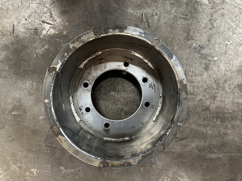

Everybody loves pics. Here is the previously trashed sprocket drum. This is the outside.
This is the inside. You can easily see the elongated bolt holes but note the cracks in the drum.
A pic of the drum showing cracks. Ugly!
We have some work to do, but we will be ready for the 2025 Serenade

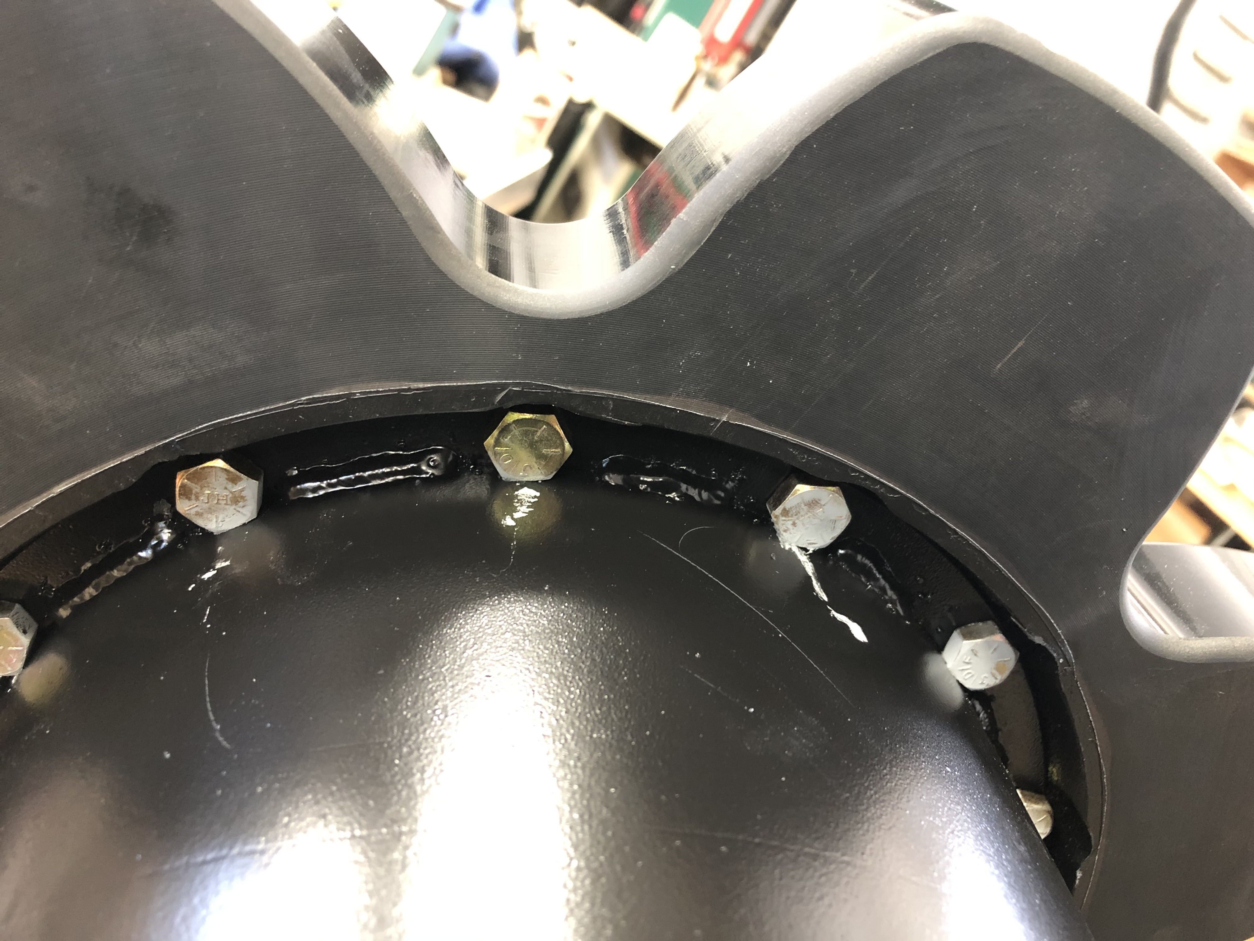

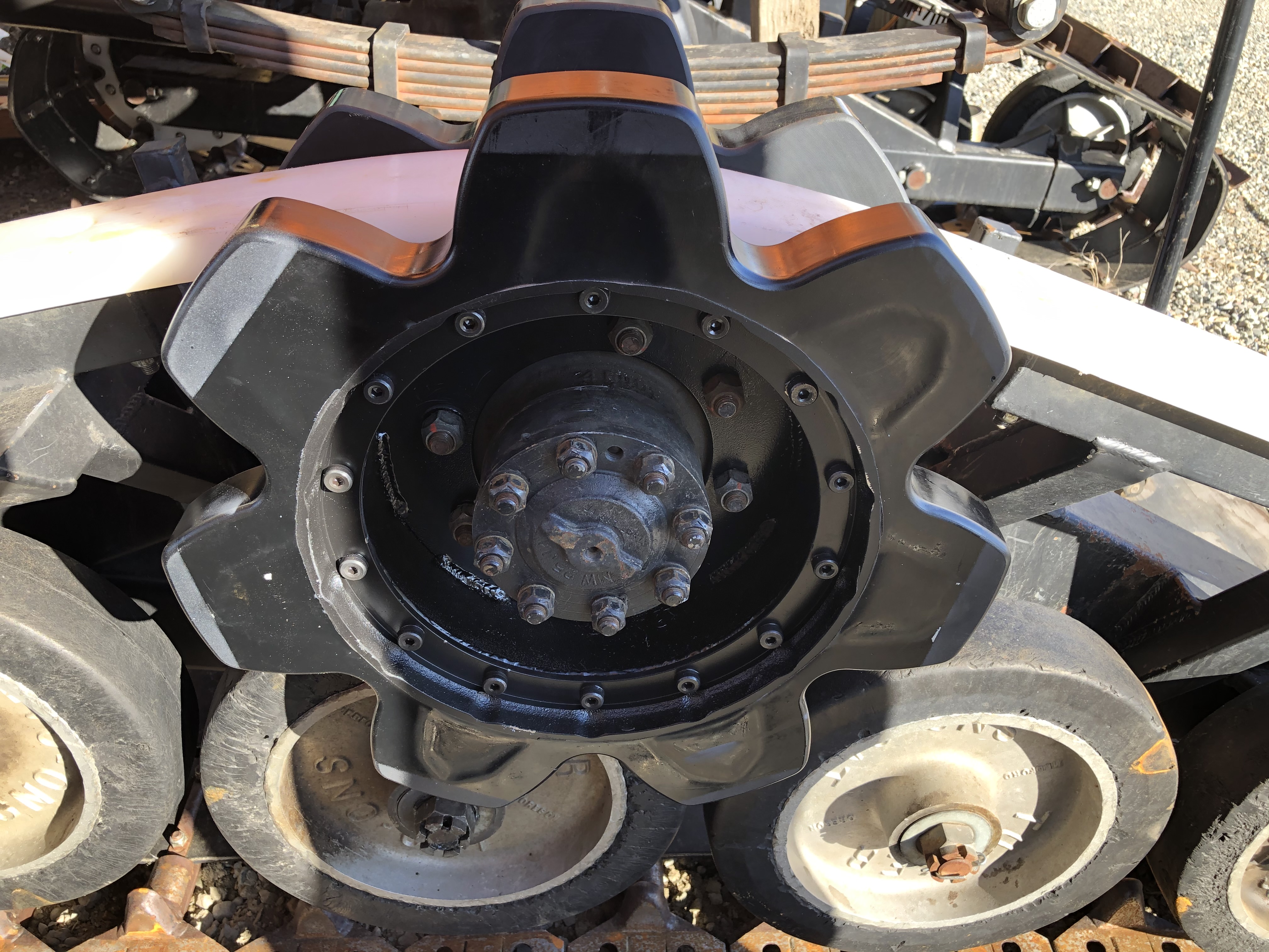

Been there and done that, good thing you caught it before leaving parts on the trail. My new sprockets from Tucker had 14 mounting holes and suspect this was the fix for the tear out, the drums were no longer available. I was running with BHCS with stover lock nuts. I think going from 7-5/16” bolts to 14-3/8” will give more clamping force and help prevent loosening and the tear out. I switched to nylock nuts and think I may have put a little red juice on them as well.
Stock configuration
New heavy duty configuration
Rob,
I remember you had made new drums, and you did a really beautiful job of it!
I didn't realize they were no longer available from Tucker. When I was quoted $550 for a used one, I just assumed Tucker was even more expensive!
The Gorilla and I talked about going to 14 bolts (they were already 3/8-24). But Tucker welds the outer ring to the cylindrical drum continuously along the outside, and on the inside of the ring they skip weld it. The extra seven bolt holes would be through those skip welds. Certainly possible, but we thought we'd evaluate the changes we made before going that route.
We had used 3/8-24 x 1 1/4" stainless steel socket head cap screws, and stainless steel Nylok nuts. All of those will be replaced with plated Grade 8 socket head cap screws of the same size, and plated Grade C locknuts (aka: Stover nuts). My understanding is standard stainless steel fasteners are roughly equivalent to Grade 5, so the new Grade 8 fasteners are stronger and allow one to torque the bolts to a higher number of foot pounds. Scott had watched a YouTube video of Stover vs Nylok, and he said the Stover nuts have a greater resistance to loosening.
We will also change the fastener orientation from the bolt head on the outside, to the bolt head on the inside (with the nut on the outside). This was done for two reasons.
- Using 3/8" nuts, the wrench or socket size is 9/16", and on two of the factory drums there wasn't sufficient room for a socket to grab the nut, and the wrench engagement of the nut was lousy. But with the socket head on the inside, one uses a 5/16" Allen wrench and there is no socket-to-drum interference.
- When removing the stainless fasteners we could see that the grouser wheel guides had contacted (and worn) the ends of the bolts, which protruded a bit less than 1/4" past the end of the Nylok nuts. We think this may have caused, or contributed to, the loosening issue.
Scott suggested a further modification which we'll do. The sprocket drums are essentially like automotive wheels in that they attach to the axle's hub via studs. Automotive wheels are either "hub-centric" or "lug centric". A hub-centric wheel fits somewhat tightly to the hub, and is thus centered by it. Hub-centric wheels use flat lug nuts. Conversely, lug-centric wheels have a conical shape where the lug nut end also has a conical shape that mates with the wheel. this centers the wheel on the studs. (The Tucker sprocket drums are neither.)
The conical angle is 60º and we will chamfer the sprocket drums with a 60º chamfer angle and use conically shaped lug nuts. Is this modification worth it? I don't know, but The Gorilla is a smart cookie and I have found following his suggestions is generally prudent.
(On the infrequent situations when he says "You were right", I usually feign an inability to hear... and ask him to repeat himself. This annoys him, which isn't a good thing... it's a GREAT thing!)
Hope to see you at Hood River!!!!
You can see that my original drum had 14 holes but a previous owner drilled the 2nd set after having similar issues with loose fasteners. I also found that the drilled hole patterns were slightly out of time side to side which put more pressure on the leading sprocket. If I needed to make another I would probably make the diameter of the drum slightly smaller and then increase the height of the flanges to give it more clearance for the bolt heads and a little more material around the holes.
I did actually assemble them with bolts on the inside which worked great because they were a slight interference fit with one flat and didn’t need a wrench to hold them. I instead opted for looks over function with the low profile SHCS from the outside. I think I went to the other 3 corners and put a few small insurance tack welds to reduce the chances of the same thing happening on the others.

Have you had any issues with bolts loosening since installing your highly upgraded design?
