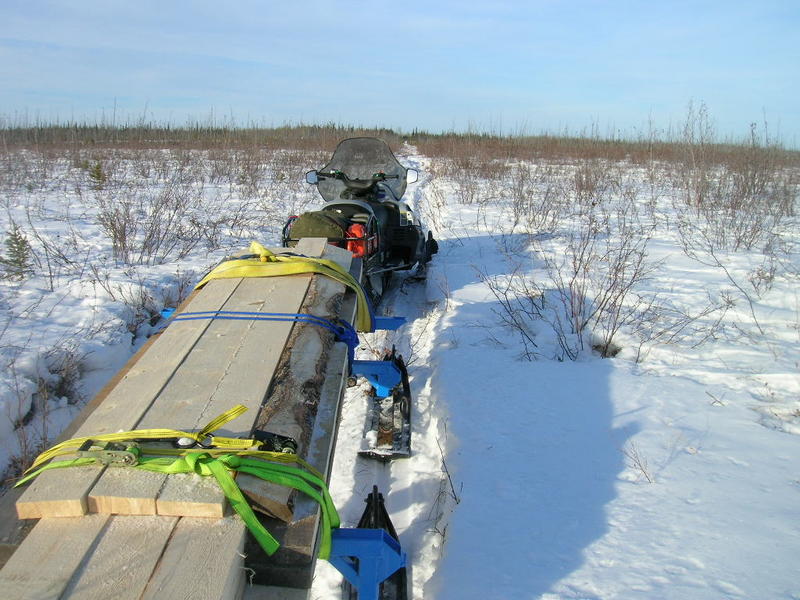

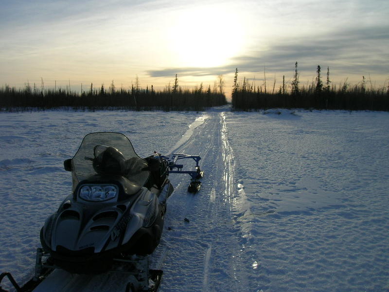

These are some photos of my 2005 Arctic Cat Bear Cat WT with the 660 four stroke engine. This model only has about 57 HP or so, the Turbo model is/was 127 HP and even more on the newer models and will climb mountains with the best of them and then some because it has so much surface area on the track to blow snow out the tunnel. Face it, you can only get to the top then fall off the other side anyways....
The reason I bought it was to haul construction freight out to my cabin site which was 40 miles cross country one way. The sled I built was exactly as wide as the front skis on the Bear Cat, it broke trail and the sled would follow in the ski tracks. There wasn't anything on the market that would haul freight the way I needed to break trail and go long distances fast if needed.
Unit will haul two adults with no problems, even comes with overload springs, and the rear seat comes off to haul additional freight if needed which is what I did a lot of.
The wider ski skins on it are only about three inches wider than the skis in the photo, but they now make a complete ski that is about 11 inches wide and I will be looking for a set this next summer, we don't have enough snow this year to make a differance or worth the effort.
