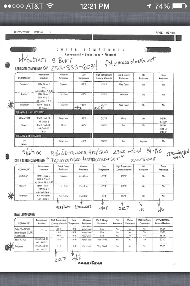

I built my own Goodyear "Pylon Defender" belts for under 1K. Bought the punch and belting from this guy (see my scribble "contact" notes on photo). Did a 4 cleat overlap and had fab shop water jet cut me a steel templet to maintain the correct spacing. Everything worked great.
