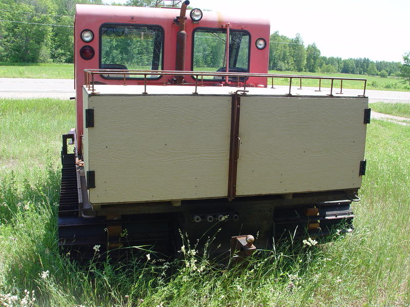

Hey guys im new to the snow cat world. I posted earlier but I think I poseted in the wrong section so I am posting here. I only own a bombardier jw 69. I am looking to get a older tucker snowcat because they are my favorite style. Anyways I found a 1979 tucker 1742. Detroit diesel engine /Allison automatic transmission / Front blade / Long tracks/ Very clean / Good condition / Present owner has reconditioned this vehicle / Good to go for snowmobile trail grooming. That is the ad and its listed at 7500.00 I know since it doesnt say the hours and stuff its hard to put a prie on. Ive heard that this has the desireable long track system. IS that 6 bogie wheels. Is the detroit diesel better than the 318 gas? Well any help is greatly appreciated.

I've never owned a 1742, or any of the ME (mid engine) Tuckers, so take this with a (large) grain of salt.
The 1700 series machines are a heavy duty version of the 1600 series Tuckers and have the long tracks. They are accordingly somewhat heavier.
The cab of mid engine models of the vintage pictured is essentially a one person cab with a jumpseat for an observer.
Tuckers were typically sold to government agencies, utility companies and to various entities (such as ski areas) as groomers. I've heard from several sources the most desirable are the ones formerly owned by utilities and the least desirable are ones used as groomers. My own experience (I've owned one of each) confirms this.
Based on the cab configuration I strongly suspect this machine was used as a groomer (why else would you order it that way). For me that brings about a significant reduction in value as does the mid engine and cab setup.
I can't remember his name (snowcruiser or something like that) but there was a forum member who had purchased a mid engine Tucker and re-bodied it with a 1960's era Chevrolet van body. It looked pretty cool and, as he had several children, suited him well.
