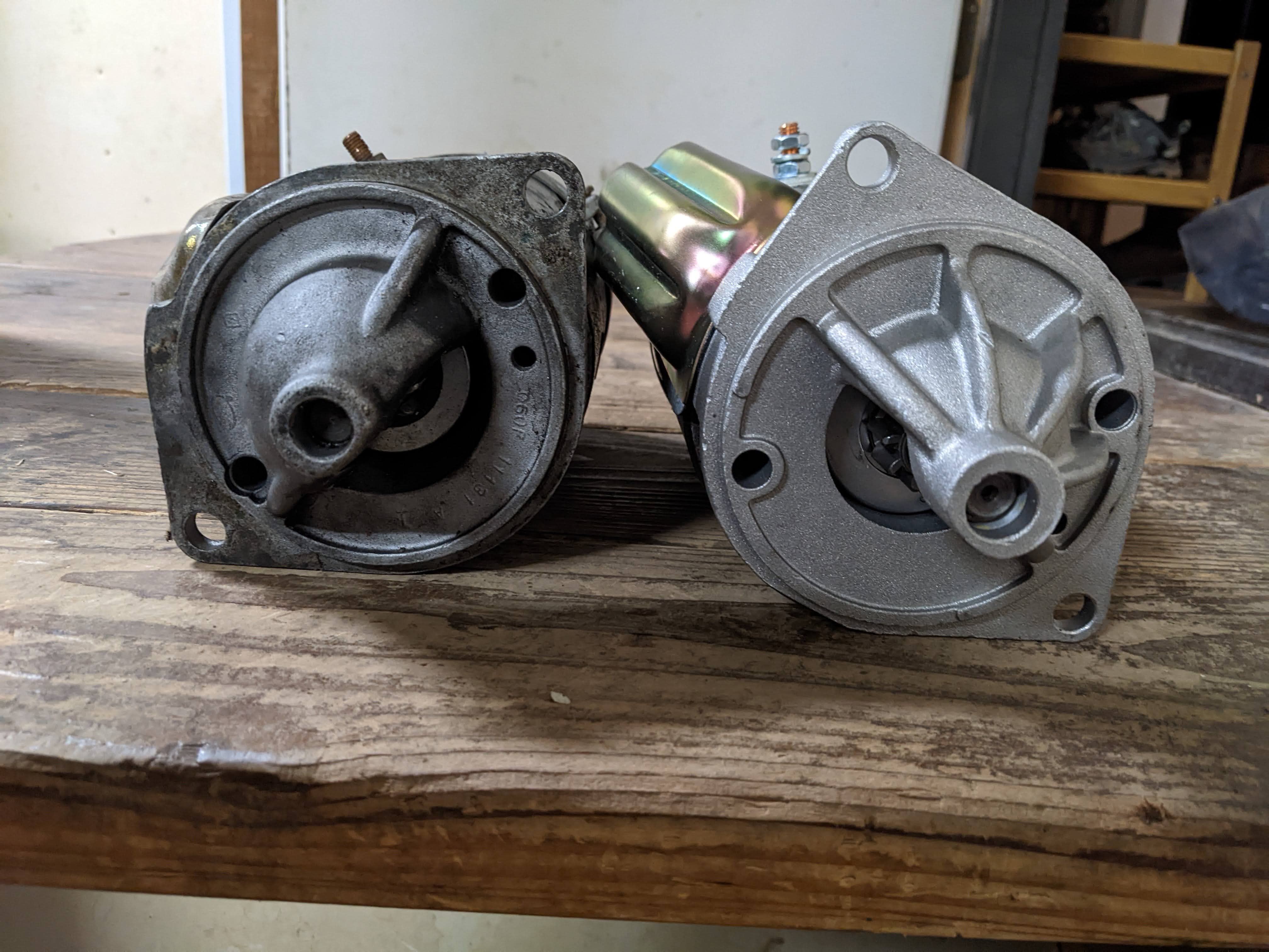

Here are two photos containing the old and new starter.
They are 4.5" in diameter, two spline.
Notice how they are clocked opposite of each other.
The new one hits the block when held in place.

I've never taken a starter apart, but is there any chance your old starter end with the gear was turned 180 degrees to make it work? I'm not suggesting you do the same, but it might explain things and make finding a new one easier.

I went to town today and hit up twos shops that don't need make and model ect.... We were able to source the exact same starter and it will be in tomorrow. So hopefully I'll be all set. I had my starter with me and compared the alignment and all looked good.
I had taken it apart before to clean it up a bit. I was getting close to looking into a rebuild kit and just do it myself.
No, it was not indexed as there was only one notch on the cone for alignment purposes.
Alright, lets close this one out for now. I was able to source a replacement starter the other day. I ended up with a Remy #25221 from a local parts house that had books and a bit of patience. His first questions was make and model. So, I said Thiokol 1202B. He was able to source it but took a bit more research to find a comparable fit.
It is in the cat now and worked just fine. I drove it around the field a bit to warm it up. Which is when the starter faltered. I shut it down and it fired right back up. WooHoo!
