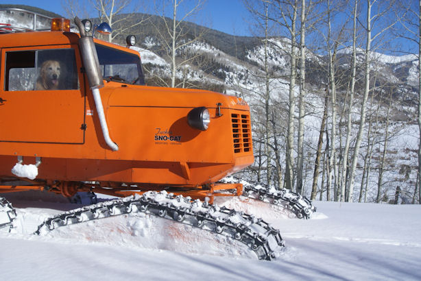

attachment.php
That dog just hates it in there doesn't he? LOL!!
