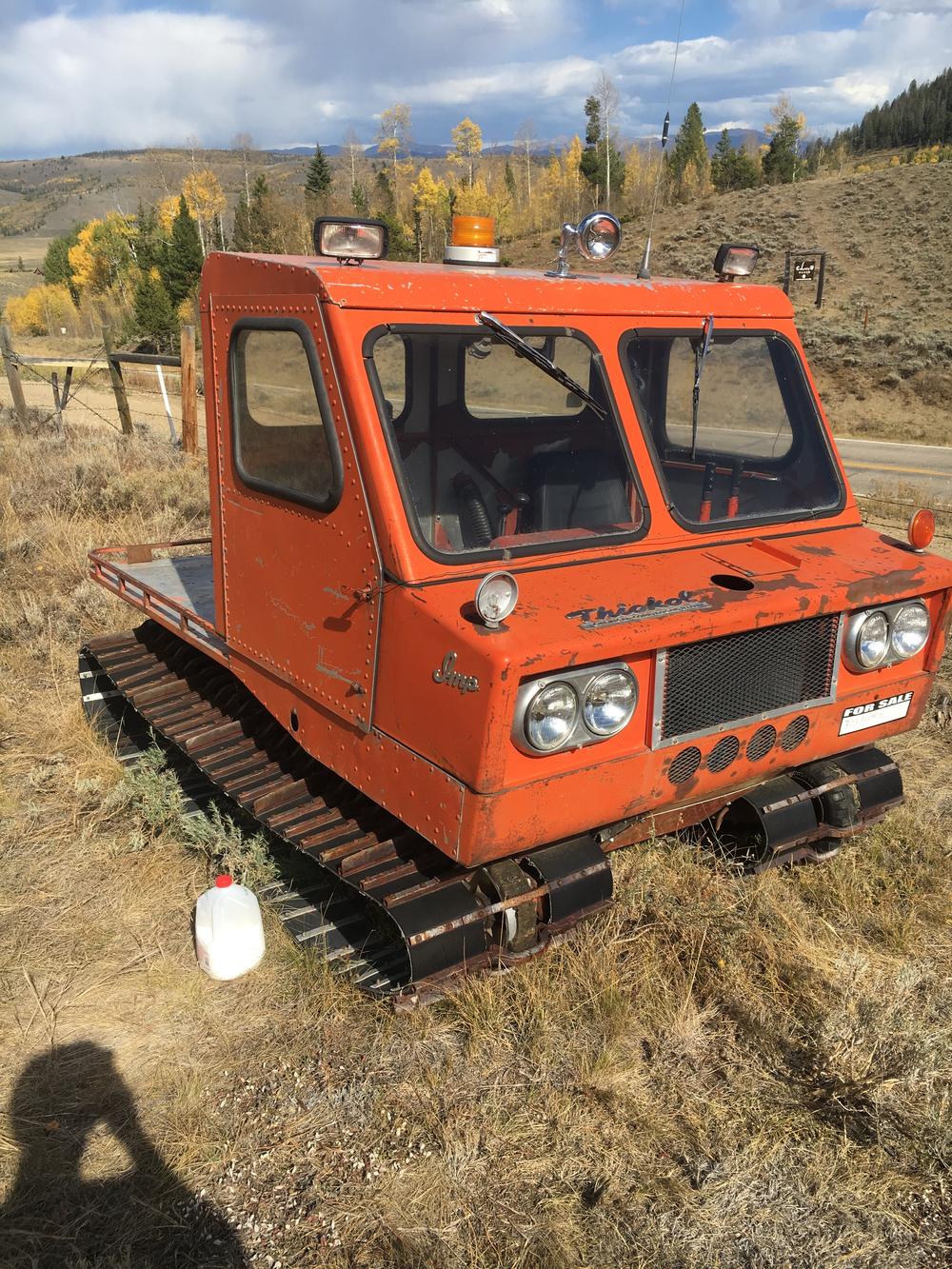

Happened to drive by this little guy waaaaaaaaaay back in the sticks today on the side of the road. Has a sign on it that says for sale best offer, sign looks to be very old. It looks REALLY rough too. That front boggy is worn down to bare metal, however, kinda looks like a neat toy. So..... what's a reasonable "best offer"

I'm not an IMP mechanic, nor do I play one on TV. BUT
just from the looks of it:
tracks, bogies, drivers,bearings $4k?
brake bands, cylinders, lines, fluids $1500
Would bet this cat needs all of above.
IF engine starts (comparable ) $7K - $5.5K = $1.5 K
No engine, or unknown: subtract $3.5 K
Owner should pay about $2K to have it hauled off.
OK, know that isn't going to happen...
If you want a chassis to rebuild, I'd offer 2.5K and dicker up to your choke point.
There are folks here who would argue with me, but a planning number for a small cat (non-tucker) is $20K to get running right. The lower the initial cost the higher the refurb, and vice versa. There are certainly cats that have been had for a song, but many more that in the long run cost more.
This assumes you do work, have tools, knowledge to do the work yourself.
CT
Don't get me wrong, they can be a hugely fun toy/ tool. But go in eyes wide open.
CT

its a tin can with a motor-----3 grand if it will start and move---projects r fun----but you will have more into it than it will be worth when its done-----I have a pb240 that is in great shape-----hit the key and go------I put it on the net at 18 g---I really don't need to sell it but I would----I get guys calling with the -----they only have just so much to spend story----but they will end up buying a cheap cat and dumping tons of money into it----cidertom is right on the money----no pun there lol

I cannot dispute the view point of Mr Squirrel. While cats are " simple" look at how many of our brethren (and the occasional sister) have started a project and found out just WHY it was sitting there. I think an imp is a fine piece of equipment, But, unless it runs when you buy it (even then it's iffy) you can't tell if it's a quick fix or "thee might as well buy a new ship, eh".
I will say: If someone is buying a cat with the idea of rebuilding it to factory (or better) and selling it. Save your money, it won't be a good investment. If your idea is personal use, cabin access, hunting, grand-kid rides, then the end sentence, ends with: "priceless". Of if you have the idea of proving that Cider Guy is cracked, go for it, no matter the cost.
Back to the original topic: $3-4 K unless it runs and drives.
CT

Not really knowledgeable about Thiokols, so take what I say with a grain of salt.
That looks like a 1404, with (obviously) a 2-man cab and narrow tracks. The 1404 was the follow-on to the 1402, which had a 30 HP Wisconsin 4 cylinder engine. The 1404 has a Ford V-4, rated at 80 HP. In my opinion wide tracks are desirable, as are larger cabs. As has been (correctly) pointed out, there will be significant costs involved in getting this machine fully operational. What are your snowcat needs, and desires? Do you want to operate in deep snow at high elevations? Do you want to carry more than one other person? What about in the future?
If you're convinced this machine will meet your needs (and wants) when repairs and maintenance are done, then I'd possibly pursue it. But if it won't, you could sink a pile of money into this, discover it doesn't really do what you need it to, and not be able to get your money out of it, and that's not even counting your time. If not convinced, my suggestion would be to continue looking for a machine that would do everything you need/want it to, and then focus your time and money on that one.
if the price is right -----buy it----if it does not fit your needs or needs to much repair----u can resell it----I had an imp----they r tin cans with tracks----if it was near me I would buy it----parts r parts
I would steer clear of IMPS. I owned a 1404 for a few years after building new tracks and going through all mechanical things and I was still nervous about using it anywhere remote. They are built for light duty applications. C4 transaxle is a weak point and they break axles pretty easy. I thought the V4 Ford was underpowered too. But It was fun to drive around and I enjoyed the project but I was glad to see it sold.
