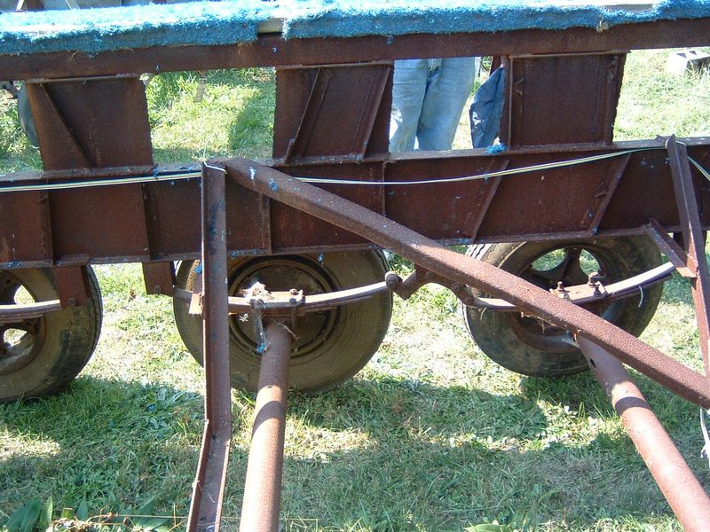

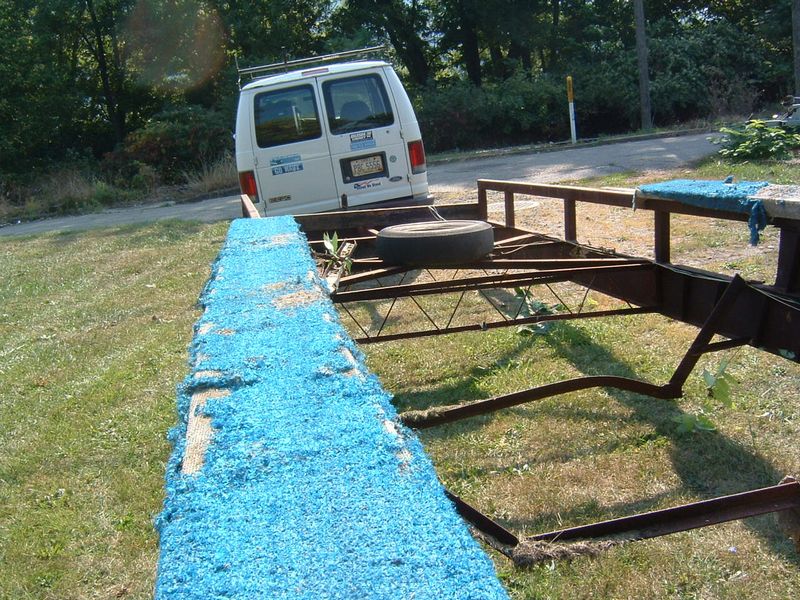

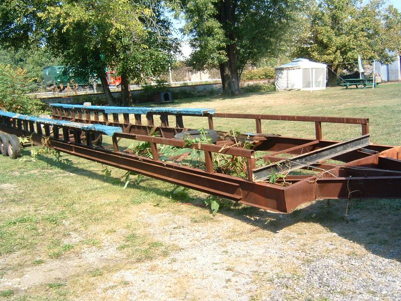

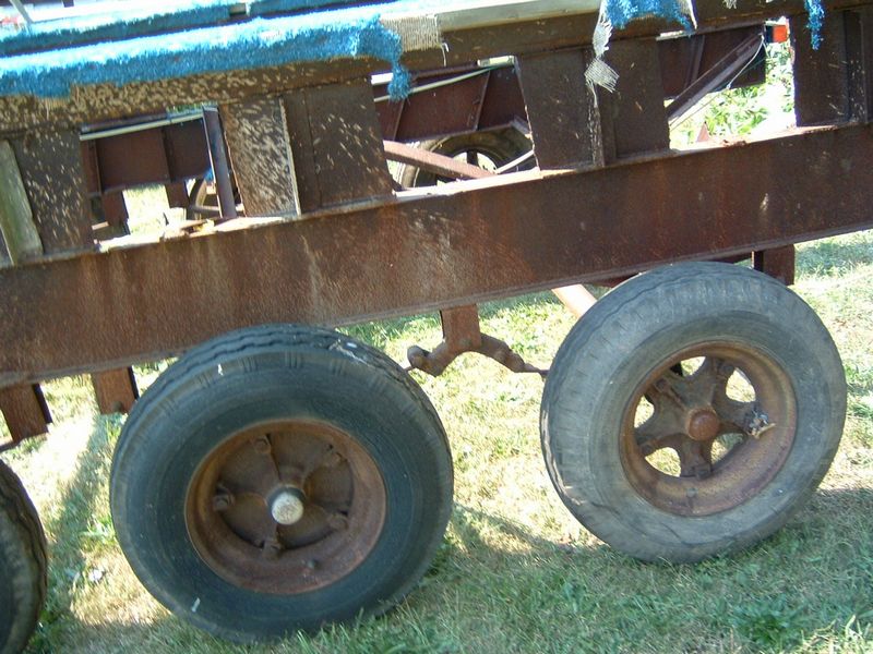

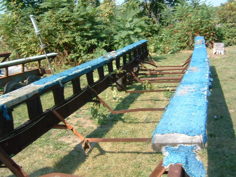

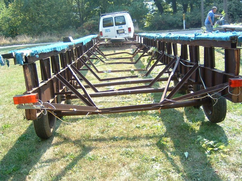

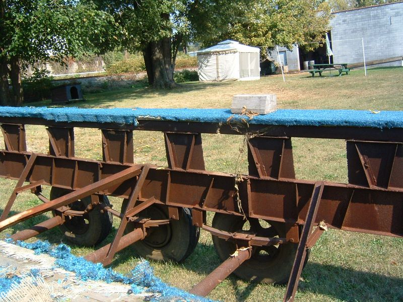

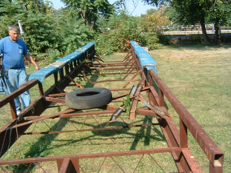

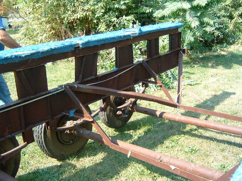

Here is a few pics of the one in Rayland OH. It is 42' long. The owner actually cut it down from 55'. The wheels are near the back so extending this one would not be an issue. But, the current owner also welded in the support braces and some other stuff. Rather ruff but cheap.
Please point out structual concerns if any ....

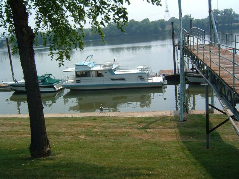

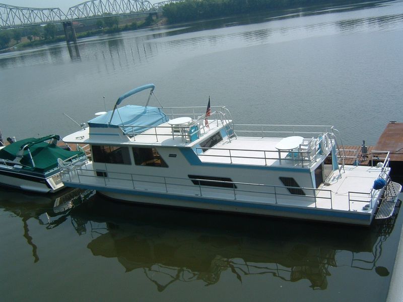

No pontoons, it's mostly flat on bottom with a big ole rudder and two Vdrives that sitck down in the back.

Those 3 axles are probaly rated for 7,500 lbs each (at most), times 3 = 22,500 lbs. A quick sketch shows the axles will be centered under 1/2 the load with the tongue carrying the other half. If the boat is 16 ton, that puts about 8 ton on the tongue. I'd suggest you reinforce that tongue - doesn't look capable of holding 8 ton...let alone pulling 16 ton up a hill.
My above suggestion is ONLY if it is going to be used as a yard trailer. If there is any thought of putting it on the road...please look for another trailer.
Best of luck,
Rick
Thanks Rick. I passed on that trailer and moved on. The boat is up on skids. And I have a trailer I can use to put in next year. I have a guy at our boat club making me a trailer like the one I used to take her out. A very nice trailer. Make from I beams left over from bridge construction. Extra heavy duty. :thumb: So, it's costing me more bucks, but I'll be all set for the end of boating season next year.
