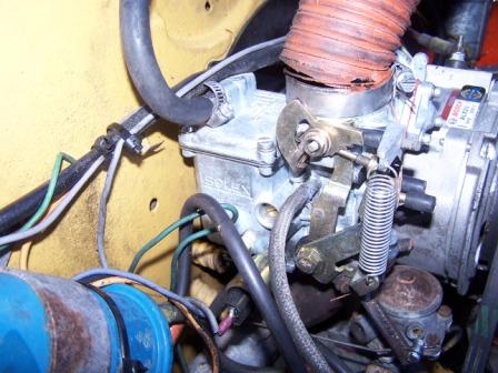

Both my Snow-Trac and Trac-Master have 1600cc 126A engines and both use Solex 32 PCI carbs and centrifugal advance distributors(009 and 010). That combination seems to work quite well, but it does have a little bit of stumble/flat off of idile. I have never tried any other carbs or distributors so I can't comment on the suitability. I would think that a 34 PICT with a SDVA distributor would be a fun conbination to try out. LINK
here is some pics of my carb dist set up i get no stumble and reliable preformance also the 31 pic dosn't require modification or a spacer to work with thw alternator

Thanks for photos and comments Don. I JUST replace my distributor with a new EMPE with centr-advance. However, the vac-advance is a tempting move. What engine do you have? What carb/dist did you have before you put on the new carb? Did all the improvement in power come from just these changes (or did you do other stuff)?
i believe its a 1600 i will find out when i pull the juggs . i had the pic 28 worked ok after i got all the buggs worked out how ever hills were 3rd gear and lugging now i have to be careful not to slip the clutch i suppose it needs a hd pressure plate for the 180 clutch
