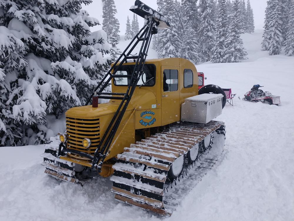

As far as "Frandee's" logo - is there something thats recorded on some image of a cat, or most of the logos/designs are personal choice of the owners?! like in GMoose's case, the bunny and all -
Working on the vector file for my unit, thinking of the options
My logo is not made up, it was a tracing from the panels of my Frandee. The only differences where I left the dash off from the "SHU" because it was grammatically incorrect and just didn't look right, and since I had it made I have found that the light blue should have been white. I have seen many photos, black and white and color of this logo, it is correct other than the two issues I just pointed out.

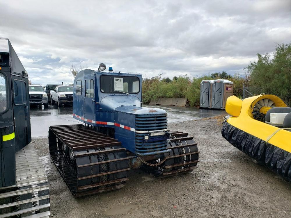

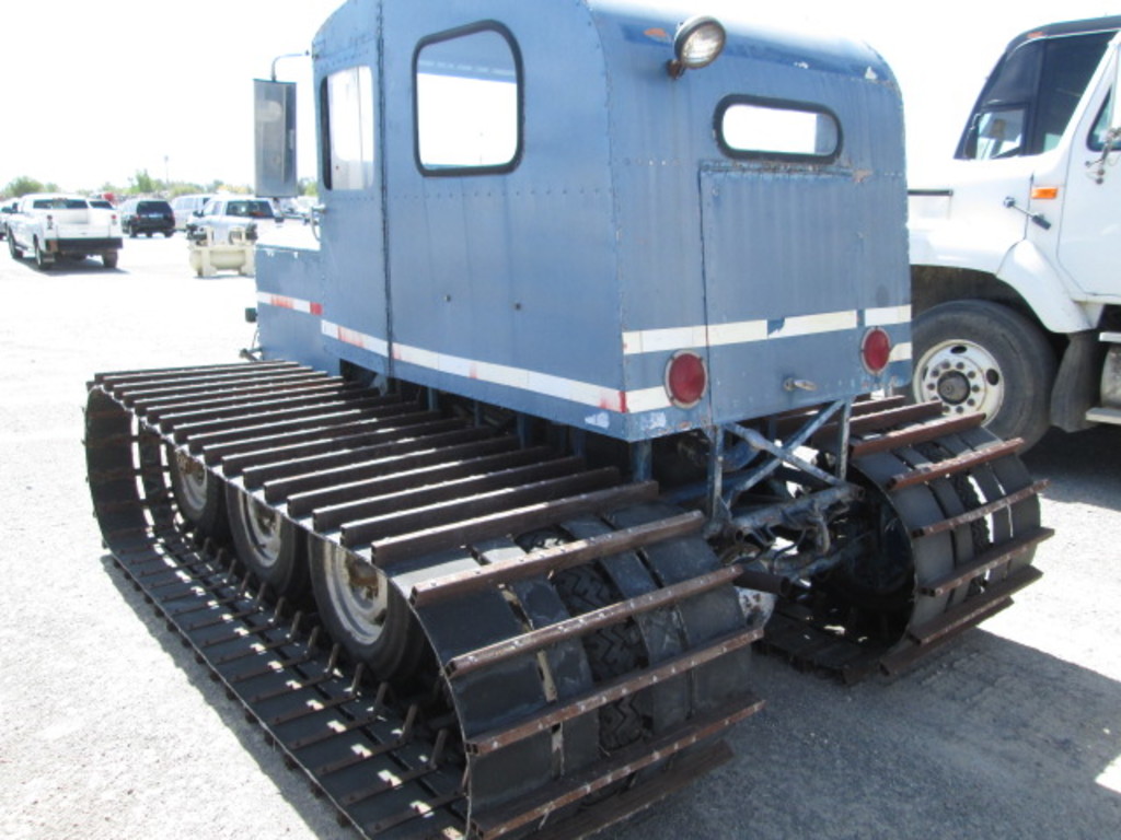

New guy here but I ran across this unit being auctioned a few months back and was intrigued by the Utah State Agriculture College (which later became Utah State University) connection.

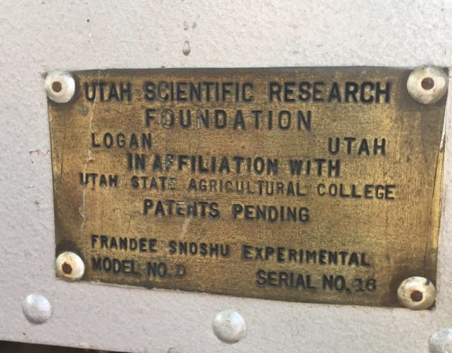

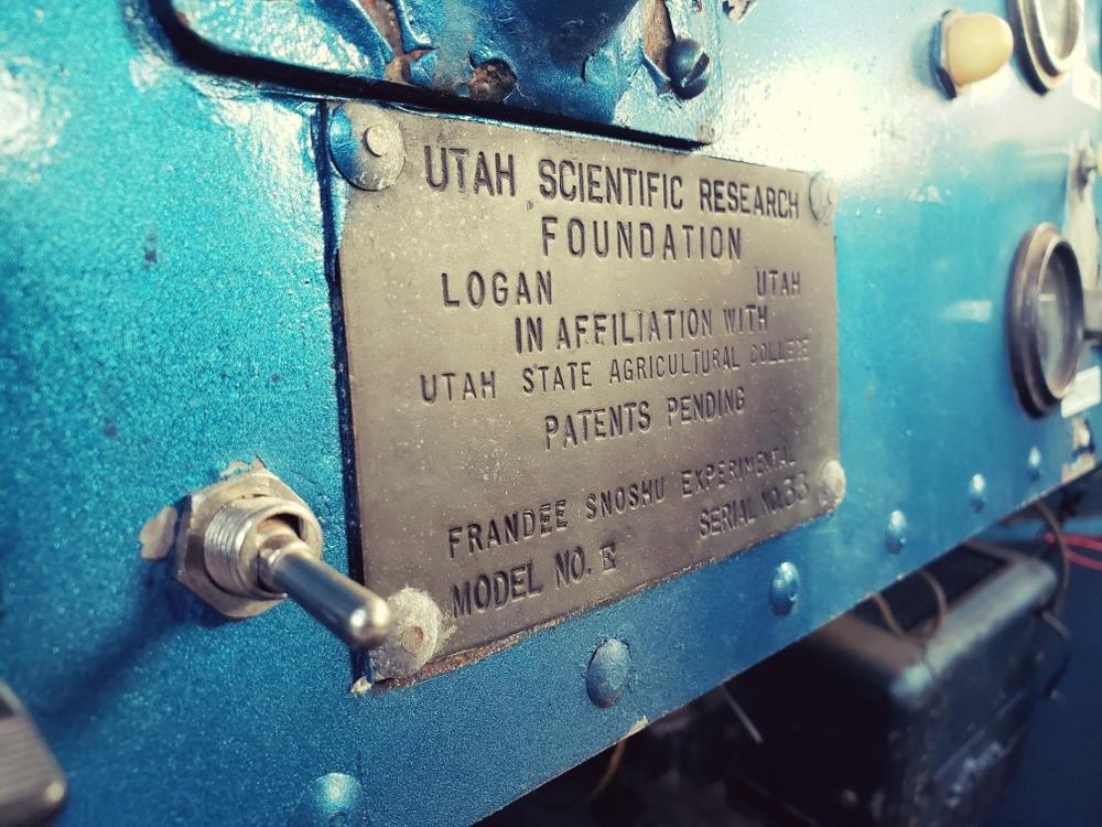

here is the ID tag from another frandee, looks like it is No.16, model D
so G MOose, how many model D frandees do you know of and what is the earliest one ?

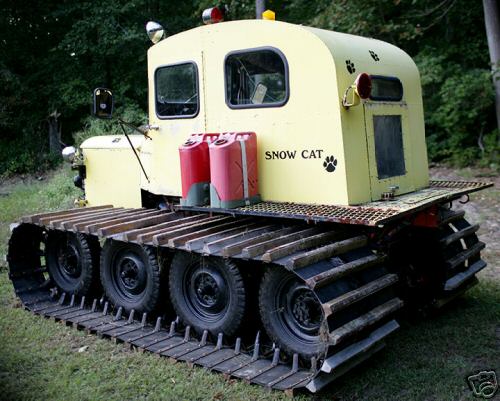

and the rear door appears to be larger than yours
I have seen one other model D in person besides my own and pictures of about 5 other model D's for a total of 7. Have seen photos of 4 model E's, one model C, and one model B.
The model D was made in 1952 and some in 1953. This is from two sources, the Eskelson thesis shows that fabrication of the model D in 1952, and I thought mine was a 1952 until I found that the axles mine has are from 1953 (casting numbers). My engine is from 1950. So I call mine a 1953 since that is the latest casting number I found on any component.

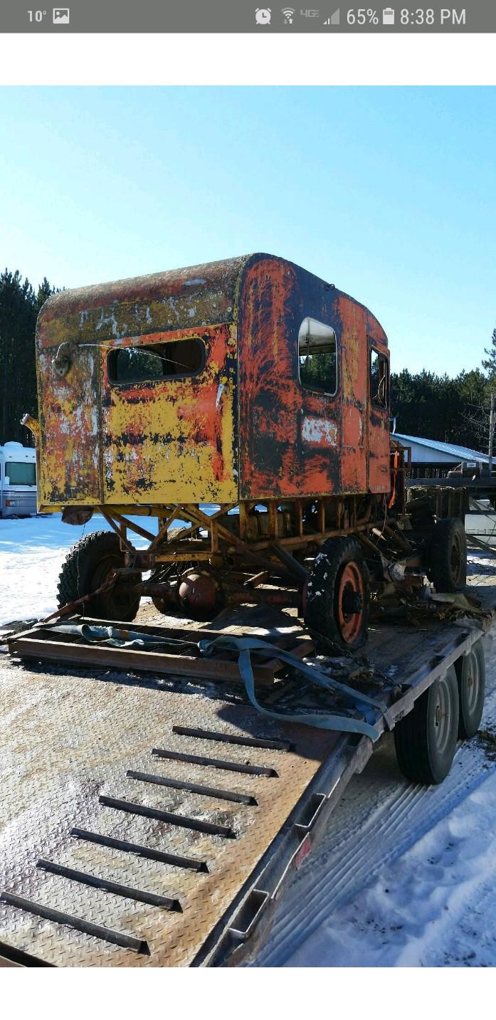

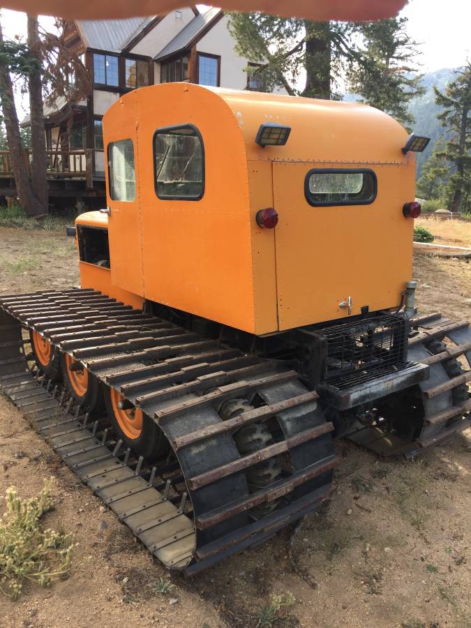

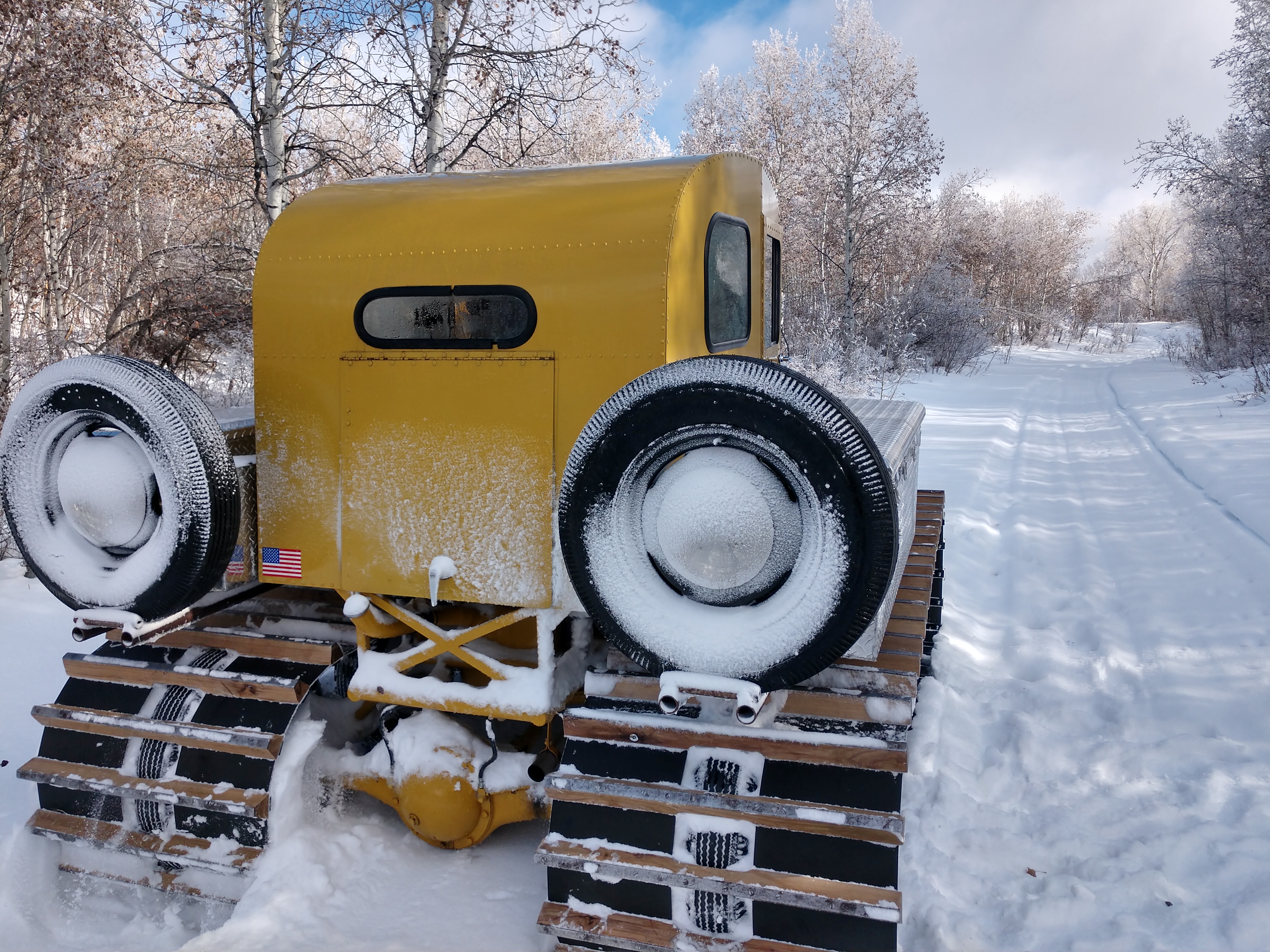

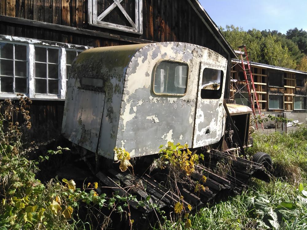

Rear door. Mine (S/N 37) was missing the rear door when I found it. I later was able to locate S/N 36 and the owner let me photo the door and measure it. With that information I was able to remanufacture one the same as the original. I have seen a couple other door options, the one (S/N 16) posted above and then the one shown below (S/N 35) which is way different (side hinge instead of top hinge). Seams like I also saw a photo of one once where there was the oval window both above the door as mine has and then one in the door also. Maybe that was a model E, not sure, can't find the photo right now.
If you look close number 35, which I believe is a model E, also has a longer cab and has an additional side door on the drivers side. I have also seen a photo of one other possible model D which appears to have had the cab made into just a two seater, not sure if this was factory or later modification.
