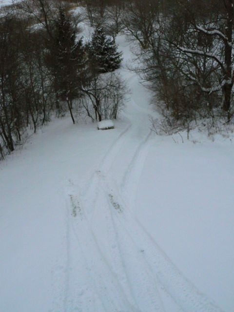

We have a steep hill on our property, not too tall but steep, and there is not a lot of clearance near the top because that is where I built my house. I decided to drive through the woods (narrow path no more than 7' wide) up the steepest part of the slope, there is about a 30' by 80' clearing near the top, just before the house. So I figured I would navigate up the path, then turn in the clearing and drive around the house.
No dice. I could not get the Snow Trac to turn on the steep slope at the top. I backed down, trying to turn the other direction, then drove forward again turning the opposite way, eventually I got it to turn so I would not knock the brick pillars out that hold up part of my house!
When I got onto a slightly more level area the steering returned to normal and I had no problems prior to that point, nor after that point.
So my question is, when you are on a very steep slope (climbed in 1st gear -- too steep to climb in 2nd) does the steering intentionally become less responsive so the tracks can actually hang on and drive the Snow Trac upward? Anyone have any experience with turning on a steep slope?
I've driven up and down river banks without issues, but never tried to turn on one of those. The hill coming up to my house is about as steep as a typical river bank.
The picture below is taken from the house, looking down the slope, hard to see how steep it is, but you can see I dug through 12+ inches of snow in a couple parts looking for traction.

Well you can see that it had no problems turning at the lower portion of the slope (in the woods) but it simply would not make a sharp, or even semi sharp turn on the steep part (not steep enough to roll over). You can also see where I backed down and came back up again to miss the corner of the house held up by the pillar.
I just can't figure out why it would not negotiate a turn on the steep part, it had no problem climbing but would not turn. It could be that the snow was simply slipping under the powered track? Essentially the right track could have been spinning faster than the left but the slope may have simply allowed the right track to slip so without any grip it would explain why it would not turn.
Does that make sense? The machine may have been working properly, may have been driving the right track with greater power, but the soft powder snow, combined with the steep slope may have just left the right track to slip and spin so there was no way to actually have the machine turn. I dunno, just thinking out loud!

i have found that in snow with no base such as deep powder it sometimes wil push the slow tack rather than steer upa hill this usualy happens on a side hill im trying to turn to go streight up
