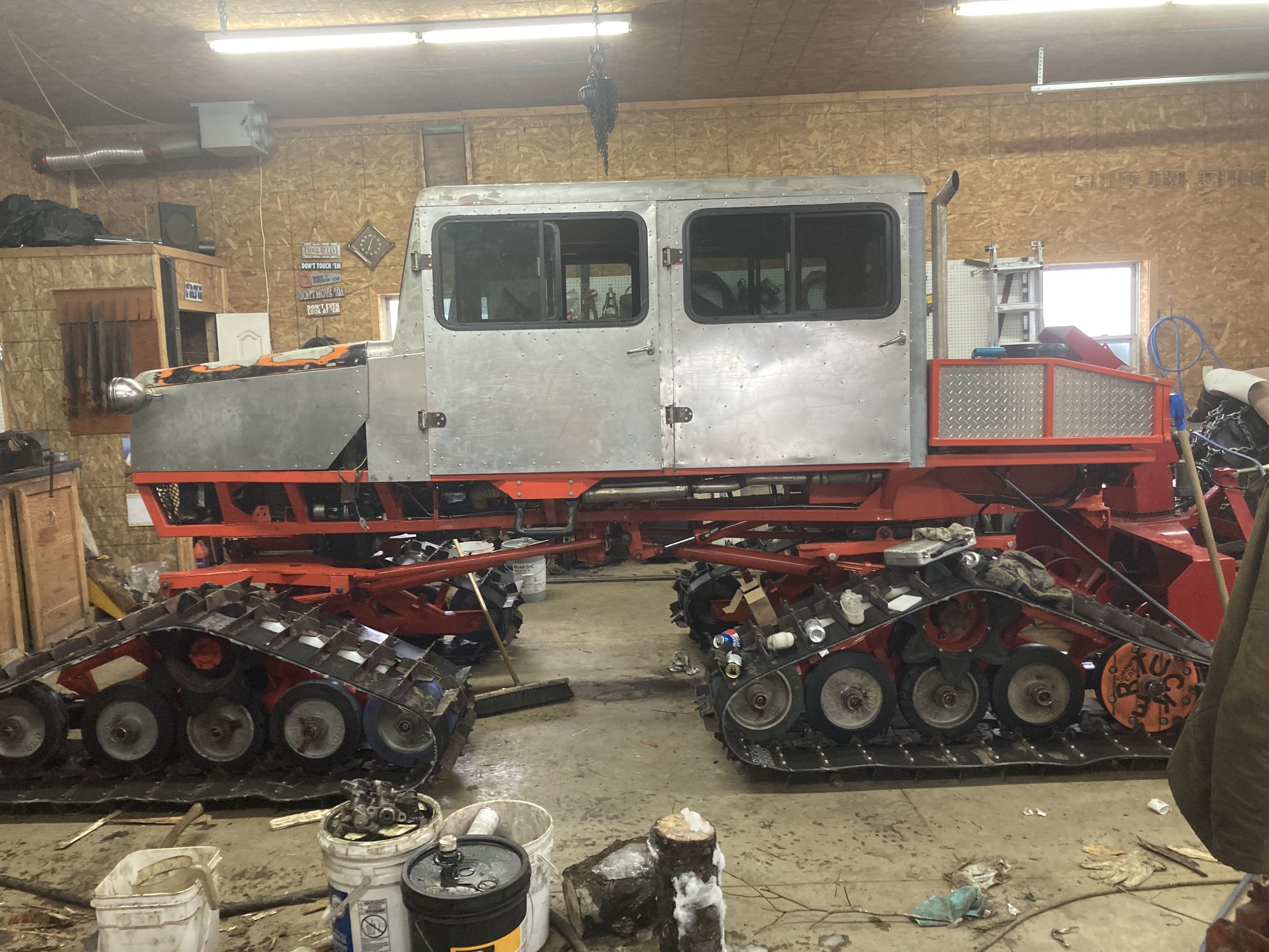

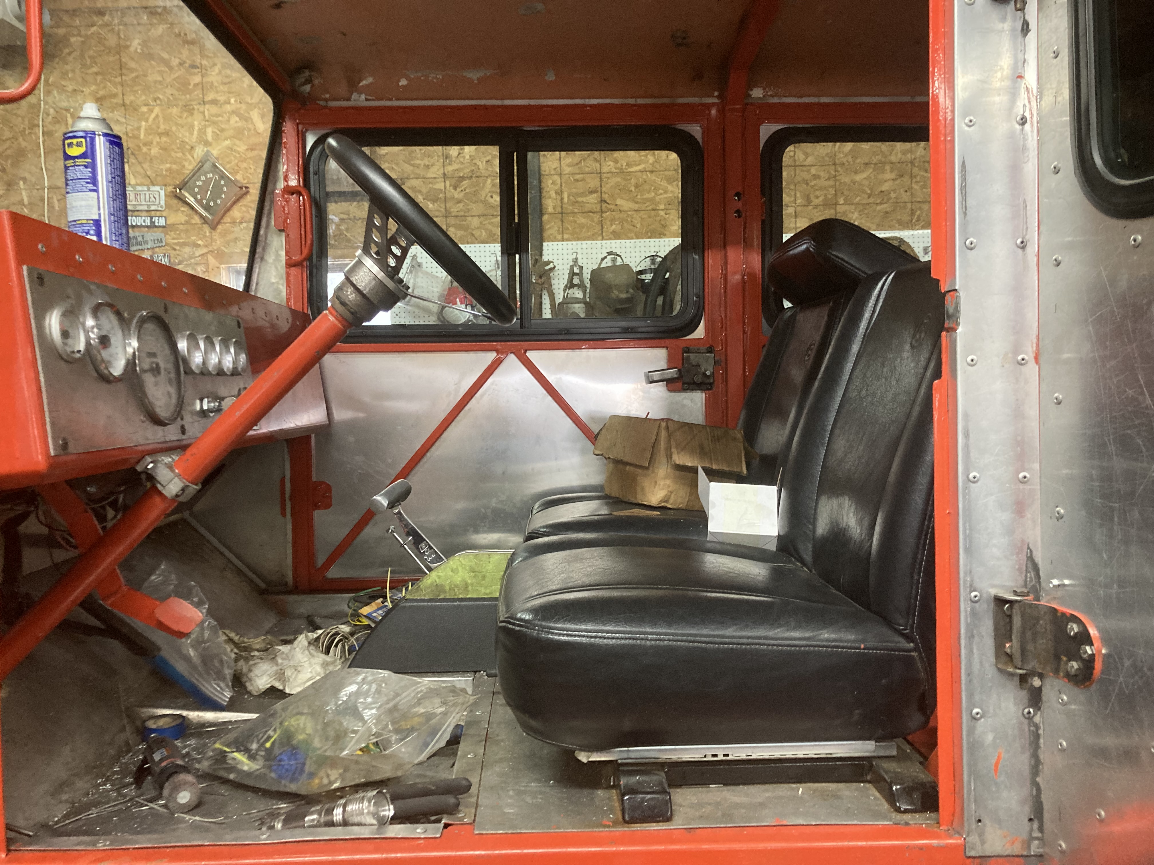

I used the ones you see in the picture from CR Lawrence. They are a lot more expensive now but so is everything else. Mine are tinted I would have liked to have gotten clear ones but these actually aren’t bad. They fit the door size perfectly

pretty sure it was VW8406 I could measure mine in the next couple days to make sure. I had to make my door frames and skins so I cut the hole for the window accordingly but if memory serves me correct thet were just a little bigger than the factory sliders. looking on line it apears they are about 450 ea now. someone else must make a compatible non - contoured horizontal sliding window
