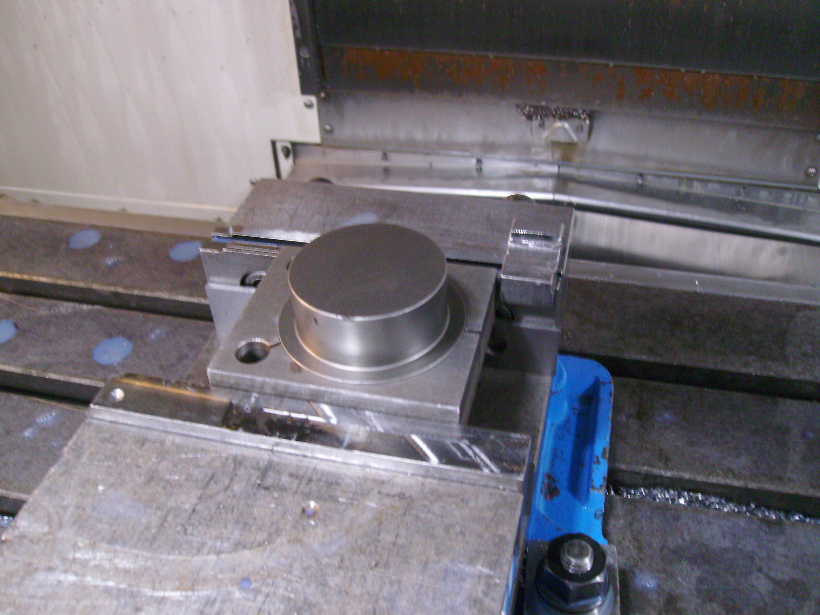

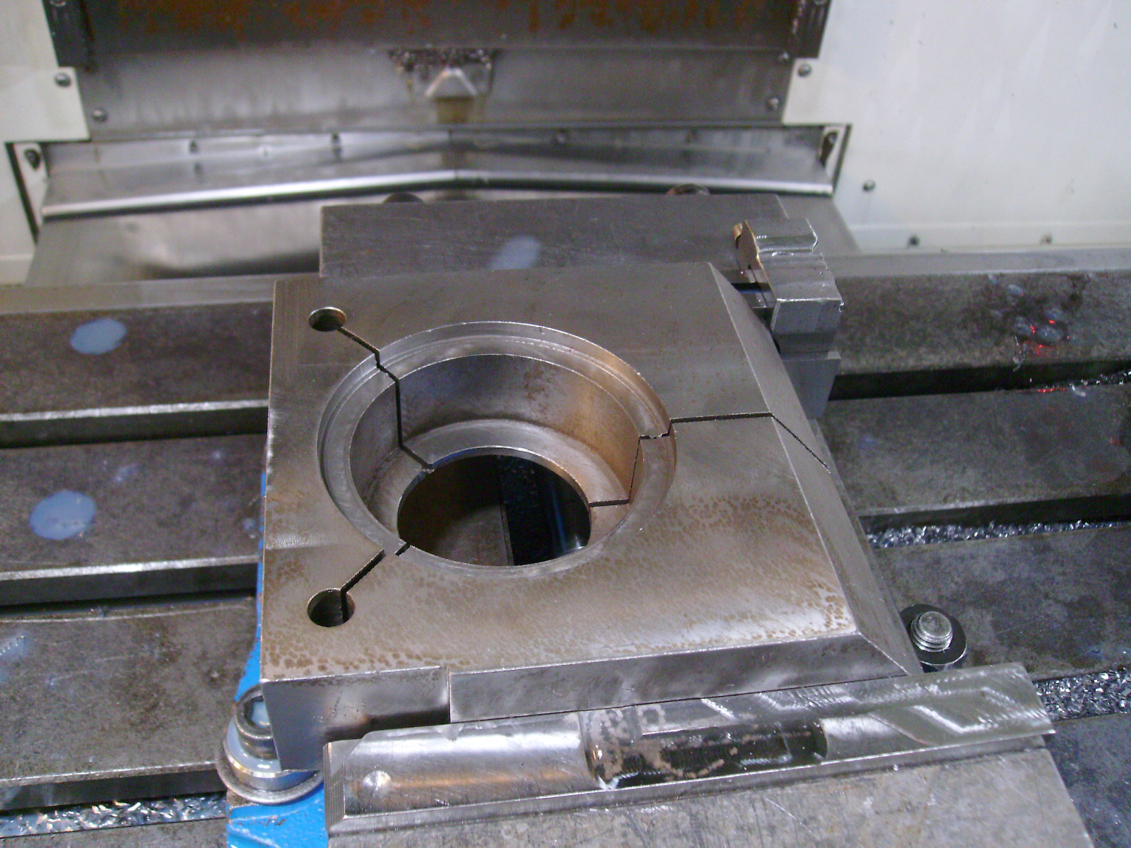

I put my steel hockey-puck in the fixture and clamp it in. I cut the inner diameter, then the bearing races, then the largest outer diameter to insure that the outer diameter is concentric with the races.

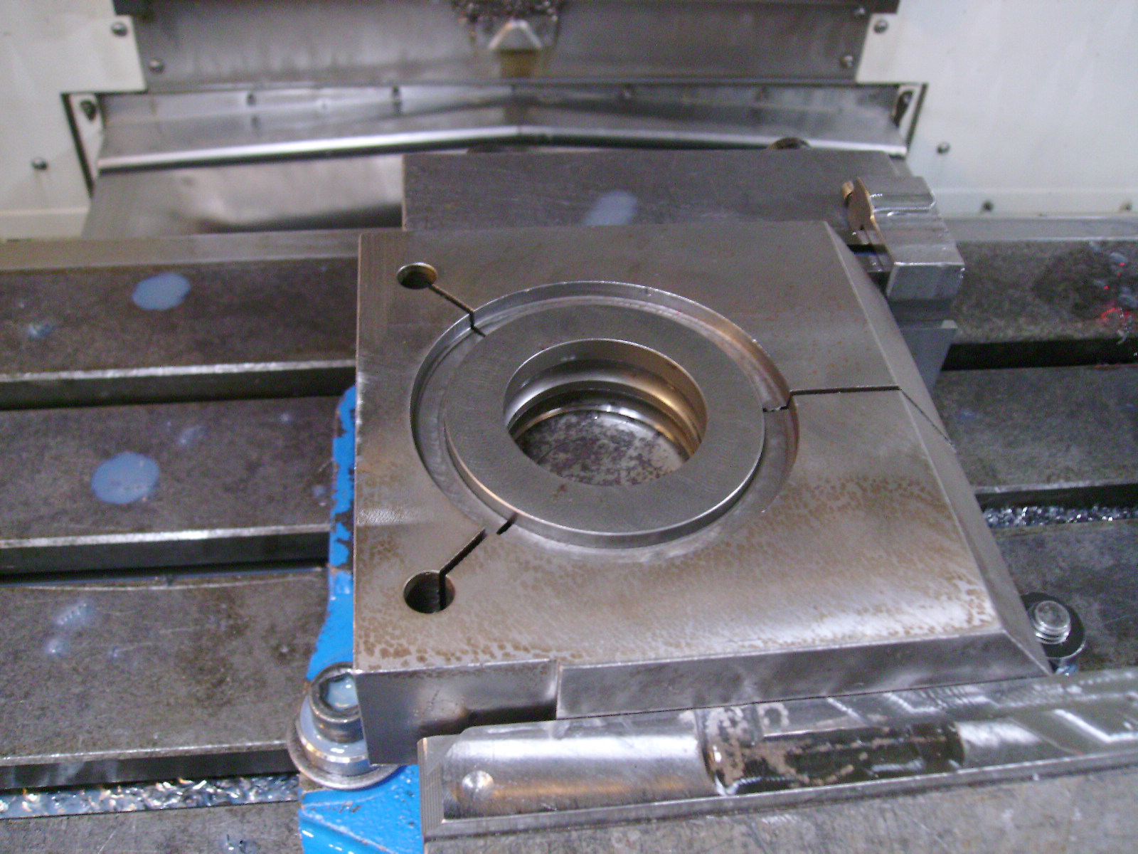

I have another fixture that I finish the other side with. This works good if I have two open machines and can do both operations at the same time.

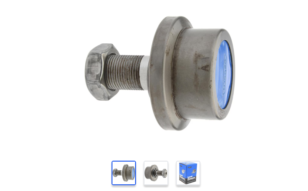

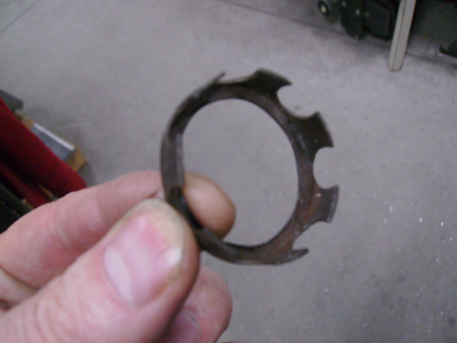

I can't use these, anymore. My parts are one solid piece. Tucker Sno Cat would install one of these from BOTH sides and then "Cap" the open end. I don't do that.

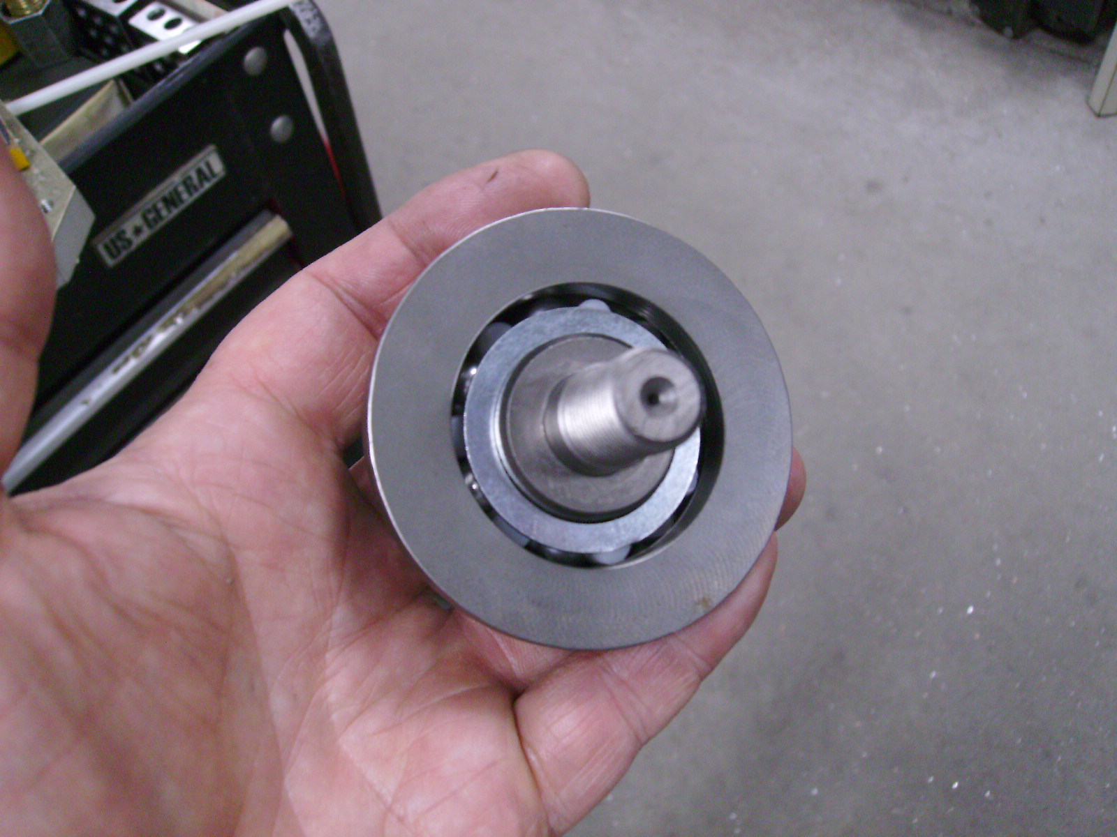

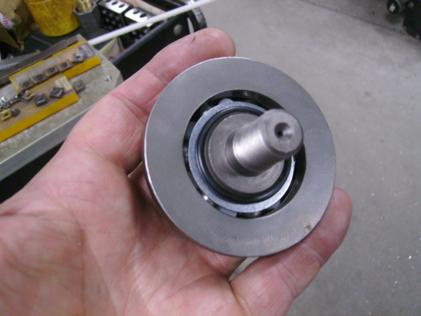

I use nylon dowels to separate the balls. This is good stuff: I can smash these dowels with a hammer and they won't shatter....... they just squish flat. The have been holding up in MY Tucker for several years now without issue.
Then I put an o-ring in there..... just to take up space.

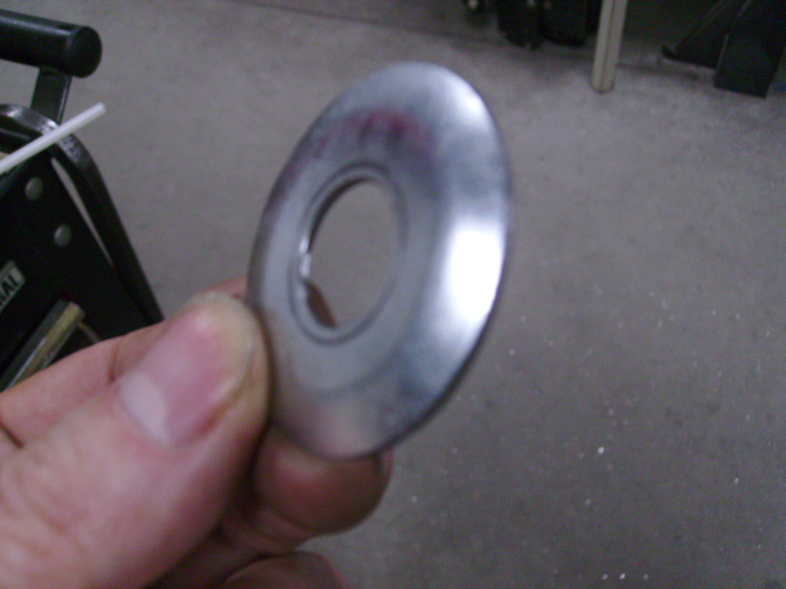

It really doesn't do anything but push down on the washer that keeps the dowels in position.
I make the dirt cap, too. This pushes down on the o-ring. It helps keep the grease in..... but not extremely well. A lot of grease comes out..... but it keeps the dirt out. (Keep your Tucker out of the mud!!!)
