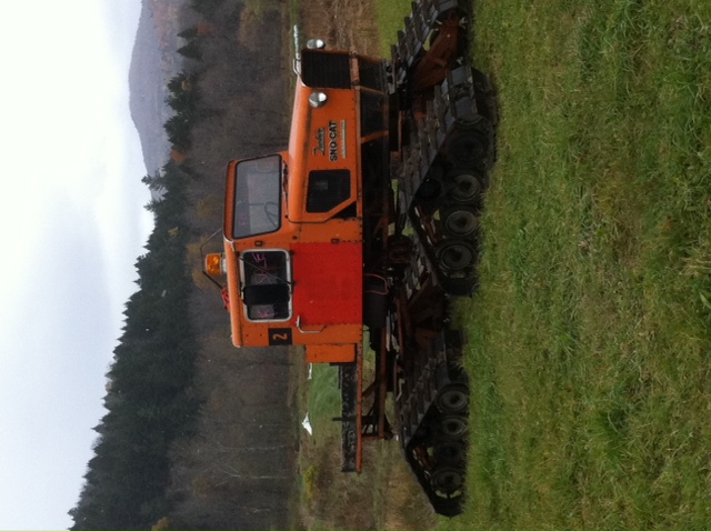

Picture of the tucker
Any input:
Model #
Value

I don't think so... I have to turn my head (or the computer) 90 degrees but I only count 5 idler wheels which would be the mid length (1500 series) tracks.
To the OP,
I would suggest you start by measuring the width of the frame rails across the cab. I think that machine is a mid seventies machine and I believe Tucker built both 48" and 52" inch wide cabs. I've owned both and the four inches makes quite a difference. I definitely prefer the wider cabs.
It looks to me like it was a groomer. The signage on the door looks like it was covered up by some new paint. Looking at the very back of the machine it looks like some hydraulic lines just above the pintle hook.
Definitely not a "cream puff". If this was used as a groomer I would suggest that you look it over VERY carefully. If it was a groomer and it wasn't maintained well you could be looking at a whole bunch of worn parts. The vast majority are still available from Tucker, but the prices of those parts add up very fast. I would not be surprised to see some frame cracks.
I'd look at the grouser bars and see if many look like they've been repaired (signs of hard use). Obviously check the condition of the track belts, the drive sprockets, the idler wheels. I would grab the drive shafts close to the transfer case and try to shake them (checking for looseness in the transfer case). I'd also look for cracks, (either unfixed or welded) for more signs of hard use on the fifth wheel plates, the carriers, etc.
I've seen some absolutely pathetic "repairs" done to Tuckers and if I saw a few of those I would strongly suggest you run away.
I'm guessing the price would be fairly cheap, but this machine is a two door (less desirable than a three or four door), has mid length tracks (less desirable than the long ones) probably spent at least part of it's life as a groomer (red flag).

My 2 cents - The cat appears to be a '76 or '77 1542. I own a '78 1642, on the '78 hoods the downward sweep on the hood is lesser, almost flat. In '75 the front hood area was a bit rounder at the top corners.
That is a former Mad River Glen groomer.
