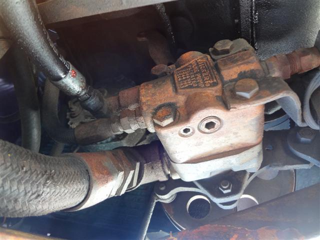

Ok.. I think I got it!
But first.. I've got to tell you how. I know I told you i'd look. Did all my stuff for today. Just sitting inside getting ready to head to work for a week. DANG.. I see this thread and remember. JUST light out still.
I went out to the tucker with a little LED flashlight. I see the cast what I think are numbers..
I go get some biodiesel. I brew my own and it's hell of a solvent.
I scrub away.. I get the 'VICKERS" logo.
Then.. I see a little flat plate beneath it. Could it be?? I scrub and scrub. If I hold my head just right.. I can see numbers, but not clear enough to even read them off.
Eureka. I put the flashlight right on the spot. Ok.. I drop the flashlight several times till I can make it shine on the spot.. THEn I send the company iPhone down into the impossibly small space between the oil fill and this pump.
Here's what I got.
Unedited.
then cropped, and I monkeyed with the color a bit.

Last pic. I could probably do a better job cleaning with some brake cleaner and some pressurized air... but I go away for a week starting tomorrow morning.
Let me know if this doesn't get it.
JP
This is perfect.
