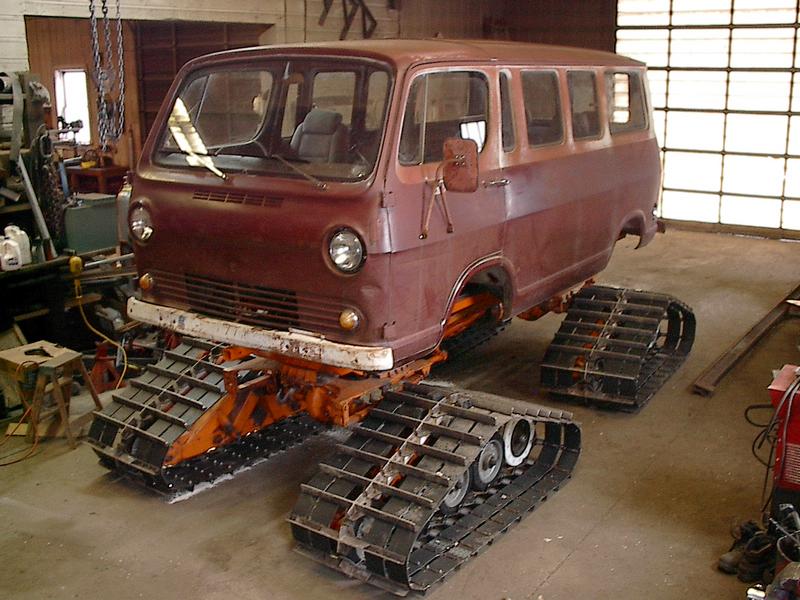

Hey Aaron, sorry I can't help with your parts issue but I was wondering, Is that your Tucker with a VW bus body on it? If so, that looks really cool. Do you have any pictures posted of it? Best regards.
