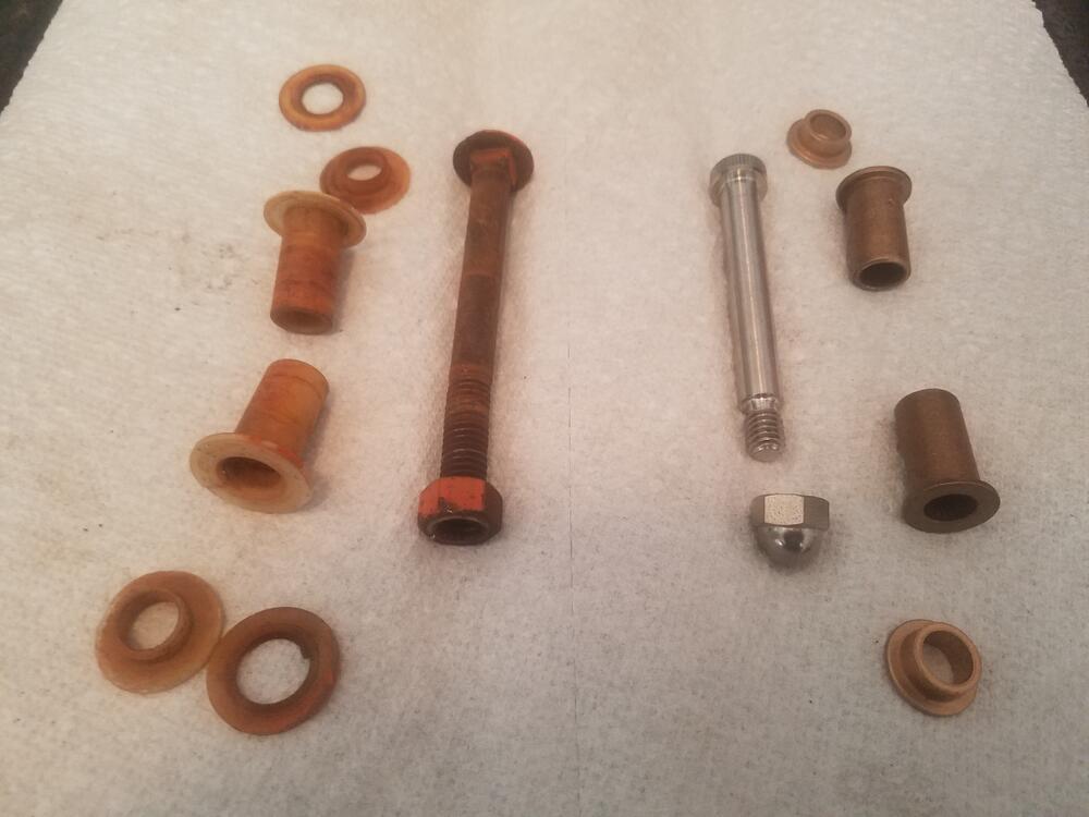

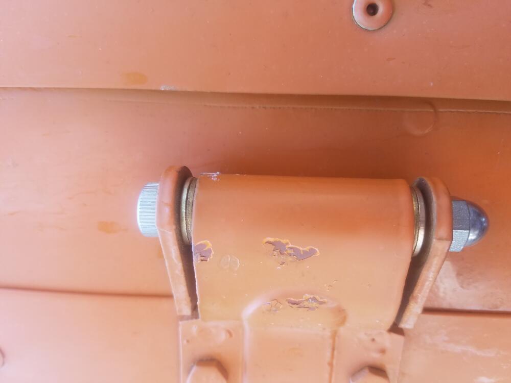

The door hinges on my Tucker were a mess when i bought it. Hinge pins had been replaced by carriage bolts and most the plastic bushings were broken or missing, doors rattled bad. Now I have SS 3/8 shoulder bolts and flanged 841 bronze bushings. Took two of us to install and now doors are tight and open/close easy. don't know why two of my pics are sideways.
