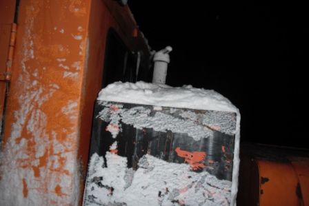

We have a problem at Challenge Mountain with our Tucker. I think its a 200a. It's an inline six turbo diesel. It quit twice today. The first time we kind of figured it ran out of fuel, as the maintenance man only put in ten gallons in. We purged the line and it eventually fired, we checked the tank and it was half full, it's a 90 gallon tank. Thought maybe the fuel pick up was askew, so filled it up. It finished up the hill, but it felt under powered. I started on our sledding hill and it died again. I figure the pickup tube is bad, but it is welded in, ?? It must not be stock.
I can't post pics for some reason, but if someone wants to see the tank I can put it on our facebook page.

I cant post pics, must be too big, ill put them on our FB page, if you care to look, thanks.

We got it running and down to the barn. It was like it ran out of fuel. There is a small inline filter that wasn't changed, all the others were changed and tight. The program director says he's going to call in a pro to look at it, if not I'm heading up Wednesday to fix it. I'm wondering if all of the ice on top of the tank could be part of the problem,maybe it's putting pressure on the lines. Can anyone tell me what that plug-in is on the harness coming from the alternator, it just doesn't look right to me, it looks like a broken fuse.
