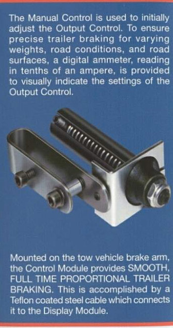

On my Touareg I use a Jordan Ultima brake controller, it is a the best controller I know of and I like it a lot. It is a progressive system so the harder I push on my brake pedal, the more brake pressure exerted on the trailer brakes.

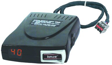

Tech Stuff on my economically priced controller @ $90.00:
Tap Impulse #37865 FORD Brake Controller
Time-based output electric brake controller w/Digital output display operates at any angle. Plug-In-Simple!® Controller Fits: FORD '94-06 F-150, '94-04 F-250/350, '97-05 Expedition, '02-04 Excursion, '94-98 Full Size Van, Windstar '95-03.
Electronic brake controllers designed specifically for late model vehicles equipped with factory tow preparation packages. Simple under dash plug-in makes installation a snap. With easy to follow instructions and mounting hardware included, the 'IMPULSE' brake controller from TAP supplies braking control power for 2, 4 & 6 brake trailer systems.
FEATURES INCLUDE:
* DIGITAL numerical display indicating power level from the controller (5% to 99%) to the trailer.
* Brake Power Level: set the exact percentage of power output you desire.
* Short-proof protection from electric brake wire shorts & brake light shorts.
* Error codes indicate a short & identify type of short.
* Operates at any angle; including upside down
* Quick disconnect allows unit to be easily removed for storage
* Time-based: sends an increasing amount of power to the trailer brakes the longer the brake pedal is pressed.
* 100% solid state electronics.

And then there is the Jordan system which is a Proportional Pressure system that applies pressure in conjunction with the amount of pressure your foot puts on the brake pedal. It does NOT work like the pendulum or time delay system. Jordan's system is simple, and very effective. Of the 3 systems I have, this is the only one I really think works the way a brake controller should work.
Linke to: JORDAN BRAKE CONTROLLER home page
I think the system that Ford uses is probably the best brake controller on the market, at one time it was also offered to the public by the OEM manufacturer but they had production problems. I'm not sure if it is available again or not, but when I was shopping for a controller I found the system Ford uses and the Jordan seemed to have the very best reviews from people who tow extensively. The Ford system is roughly $350 plus installation. I went with the Jordan because I could not get the Ford system.
Teksnosha is an excellent brake controller by repuation, but I don't like the inertial concept for controllers. JMHO, it works well within it's design limitations, I just prefer the Ultima.
