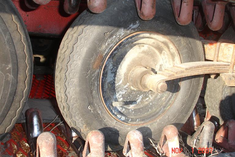

Hi, this is my second post (first one accidentally was posted to the introductions page). I've tried to attach various photos of the track and tires to get input on their condition and expected remaining lifespan.
Specifically:
1) the track pictures identify typical cracking in the vicinity of the grouser bolts. Arrows help identify specific locations. (First & Last Pictures)
2) a small (2 inch) tear in the track has an attempted repaired. (2nd & 3rd Pictures)
3) tires in questionable condition. (4th & 5th pictures)
I'd appreciate any feedback you might offer on these photos.
Thanks

Here is my take on your track and tires. Appears to be on a Thiokol Imp. The track weather checking is not a big deal as long as it is just the outer rubber and not the cord part of the belt. Plan on a replacement in the future as it gets worse. The belt with the damage that goes threw the cord needs to be repaired. Either cut out the damaged area, repair it, or look at new belting for both tracks on the machine. The tires that are just weather checked without damage to the cord will also last a while longer. Then again, if you are way out in the boondocks and plan on working the cat very hard you may consider replacing anything that looks like it will or could be an immediate potential problem in the near future. I do not like to make field repairs and thus I become pro active to repair prior to failure or potential failure. It just gets too damn cold working out in the weather if you can avoid it.
:myopinion: :my2cents: Hope this helps you to decide what you need to do...:idea:
I pretty much agree with mtntopper. Those tracks and tires will last years of weekend warrior use. If you have a daily chore or you plan on taking long extended trips then maybe tire replacement. The belts look fine. One spot is torn but not a huge concern, just watch it. Also monitor you tire pressure every time before each trip and have a way to fill the tires up on the trail or at your truck. Flat tires will ruin a day of catting quicker than almost anything else. Carry a spare section of track, bolts, nuts and tools in one bag thrown in the cab strapped down. If you are really concerned then rebuild your tracks yourself. In any case I really suspect those tracks will last years. During the off season do your self and you cat a favor and get it out of the sun! Those surface cracks are sun related damage. Costco produces a nice portable garage thats under 200 bucks and works great keeping the sun and elements off your cat.
