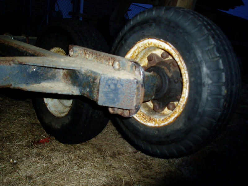

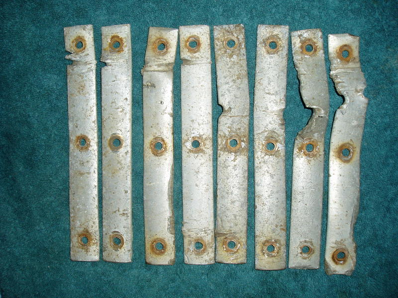

I also found that the frame that holds the front idler on my Imp was square from Thiokol, and had torn up a lot of the grouser back plates (likely from a flat front idler tire sometime in the past.) Didn't get a 'before' pic, but 'after' shows them rounded off. Not sure if that's typical of Imps or Thiokols in general, but it might pay to check yours.
