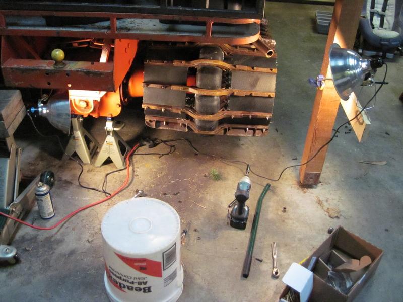

After a bit I had the bright idea of working from the back of the tracks instead of the side. I was able to set up shop with a bucket to sit on, plenty of light, and all my tools within easy reach. I used a section of pipe as a pry-bar to advance the tracks so that I was able to work on each grouser while it was right in front of me. Still a lot of work, but *way* easier.

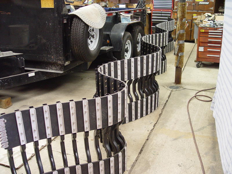

What I did when rebuilding my tracks on a Thiokol 601, is I tightened the nuts as tight as I could before anything started to distort, such as the grouser, backing plate, or the rubber belting bulging on the edge. I never checked the lbs per sq. inch but because I had 2560 bolts to tighten, I set my air impact wrench to match my hand tightening then used the impact wrench to do all the rest of them.
I also used nyloc nuts just to stay with the originality of the factory, however, I feel the other lock nuts listed above are much better.
I hope my experience helps.

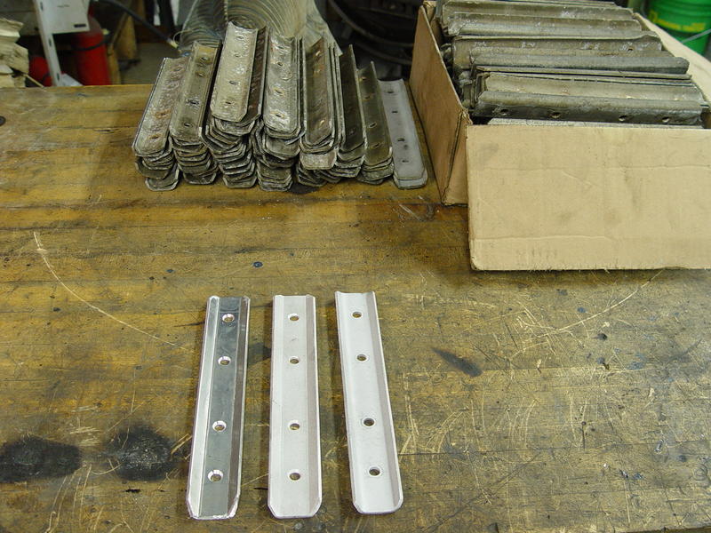

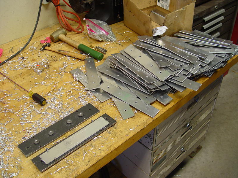

Those are the Thiokol factory spec. backing plates on my tracks, however, because most of my backing plates were damaged beyond repair and missing, myself and a friend of mine (a tool maker by trade) made a die to re-manufacture the Thiokol 6 series backing plates, so all the backing plates you see on my tracks were stamped out by me on a hydraulic press in my shop.
In the pic, the backing plate on the left is the one I make, the middle one is the same but has been bead blasted, the one on the right is a factory original after it was bead blasted.
The second pic shows the jig we made to bore the holes exactly the same every time.
